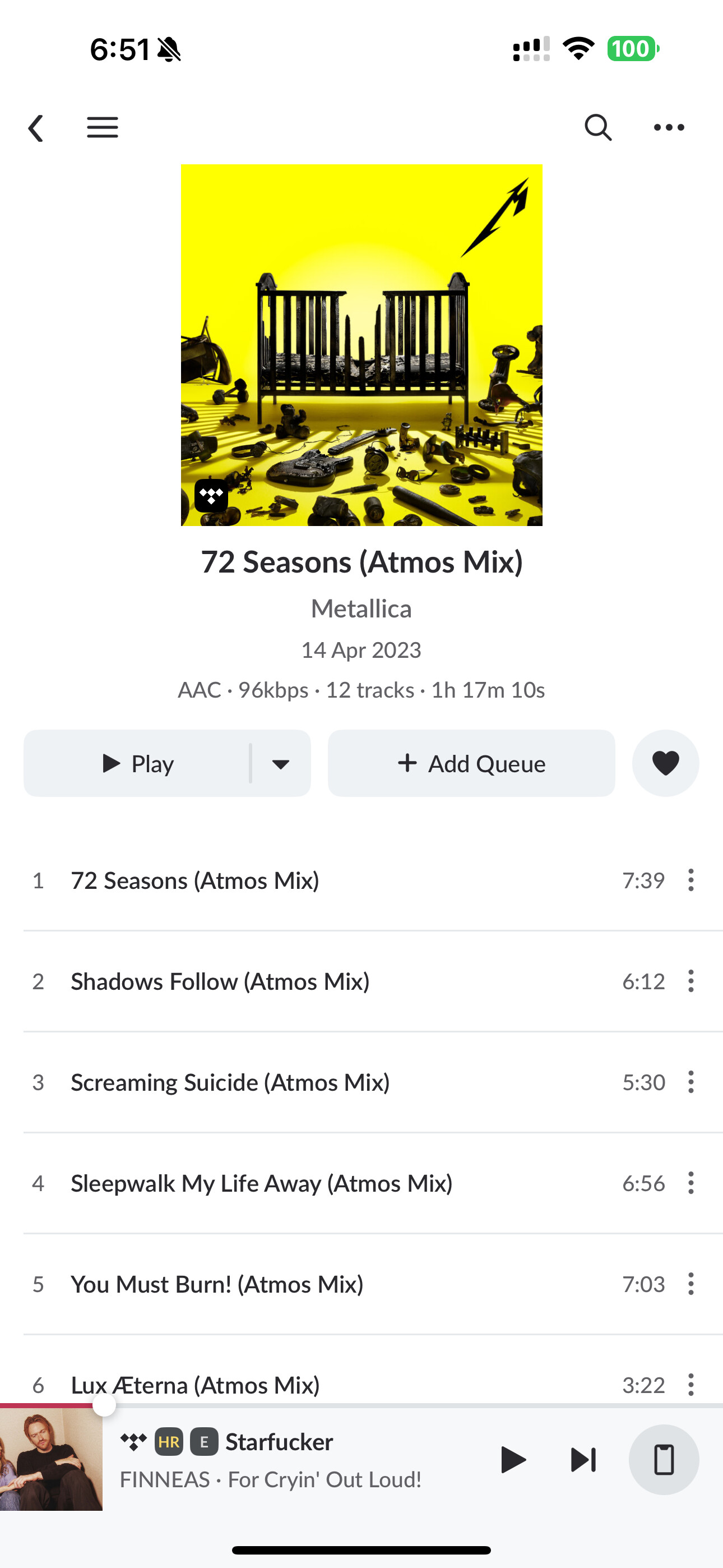

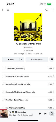

I can see the Atmos versions of albums in JPLAY for iOS.
And is it possible to stream it in native Atmos to any device from there, and may it be via HDMI?
Atmos is 96 kbps AAC? (Sorry if this is a stupid question)
It’s aac yes, no idea of the bitrate.
But does it play as it. Sonos app shows it but can’t stream it.
It’s just that 96 kbps seems awfully little for 10+ channels? So I also suspect that the track names may say „Atmos Mix“ but the stream might not actually be
On looking it up the max it will be 768kbps and thats not 24bit I believe.
JPLAY has no idea what to do with Atmos and doesn’t even have the correct bitrate because, why or how would it. It’s a stereo UPnP control point.
My point is that Atmos albums are visible.
The “Atmos Mix” is part of the Title Mix Name only. Many Atmos titles are labeled like this to differentiate from the stereo version.
AAC does not have any object base height channel speakers therefore it is not Atmos, but it was converted from a Atmos mix retaining the source name.

I added the Atmos mix to my library. Looked at it in JPLAY. It’s the Atmos mix.
Oh Ok I see now. You have a Atmos track and this is how it is displayed in JPLAY.
