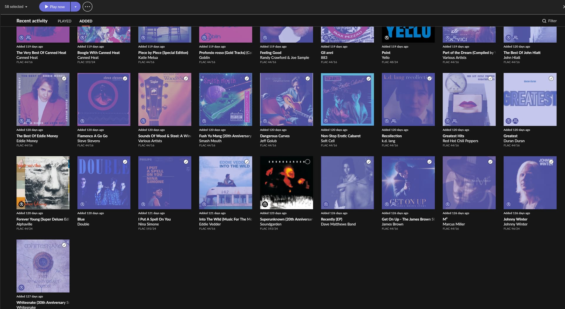

I am suddenly seeing dozens of Qobuz album that have been added to my Roon library going back 121+ days. The latest batch was 3 days ago. Any thoughts on how this could have happened? I changed my Qobuz password, just in case, but these do not appear in the Qobuz app, so they were added to my Roon collection for which I have a super complex and unique password. Any ideas? I am deleting them all, the screenshot is my third set showing the last 58 (or so I hope). Nope, when I deleted these some even “older” additions appeared.
I have never seen these before and suddenly noticed all these additions today. It’s like somebody else’s library merged with mine somehow, but only in Roon. In Roon I checked my Login Sessions and it goes back 3 months with only me.

To be clear, this is not me viewing an overview of a streaming libary. These are ADDED albums that are suddenly interspersed with my ripped albums and the streaming albums I legitimately added. I saw another thread where someone was confused about that, but this is not the same.

I have the same problem started since 3 days, strangely enough the albums listed in Roon do not appear in the Qobuz app.
Not strange at all. They are someone else’s favored albums in Qobuz, not your’s.
