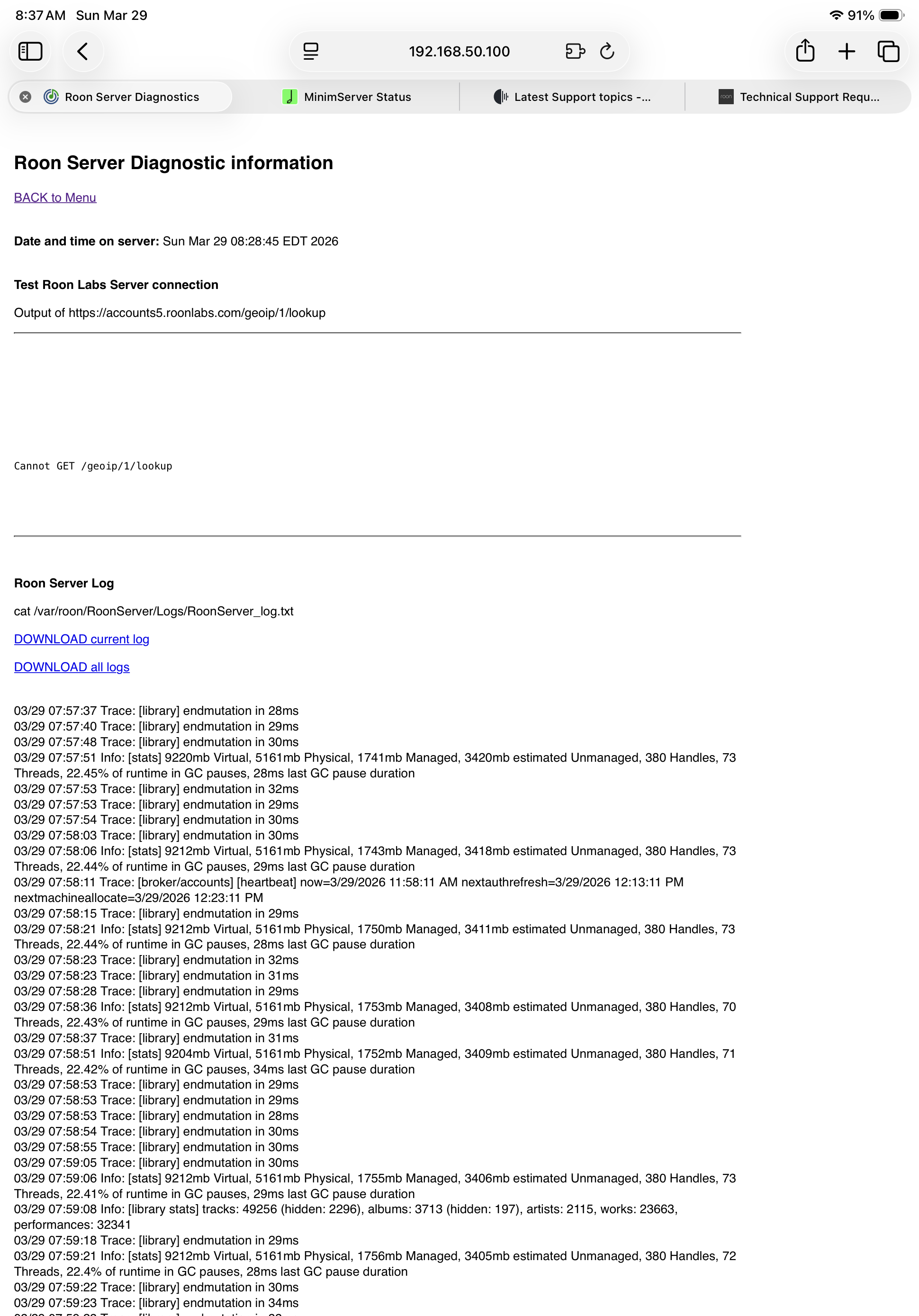

· About two weeks ago we started getting drop outs when streaming Qobuz. Then I started to get non responsive when hitting play on Qobuz or Tidal albums. I looked at the logs and I’m getting a failure on geoip lookup which seems like the culprit. But I can’t clear the error even went as far to uninstall Roon and rebuild my library from scratch, not a back up.
Since I noticed the error Roon has become less reliable. I was playing a record from my local library and got pause and skip in the middle it.

We were able to review a fresh set of Roon Server logs from your sonicTransporter, and although the Roon Server log excerpts provided do not contain explicit underflow or dropout errors, there is rapid file sorting and heavy audio analysis that consume substantial processor cycles and memory. On a server like a sonicTransporter, sustained memory use and high garbage collection overhead can tax the processor enough to prevent smooth real-time streaming, which leads directly to audio dropouts.
That said, the GeoIP lookup error could also very likely be the direct cause of the non-responsiveness when hitting play on Qobuz or Tidal.
Since this error persists even after a complete Roon reinstall, it is not a library corruption issue. Instead, it points to a network routing or resolution problem:
  • DNS Resolution: The sonicTransporter might be having trouble resolving external domain names. If the static IP was set manually on the sonicTransporter, double-check that the DNS server addresses (like 1.1.1.1 or 8.8.8.8) were entered correctly.
  • WAN / Firewall Blocking: The Asus Zen router or a setting on the sonicTransporter's operating system might be blocking the specific outbound port or domain needed for that GeoIP check.
Could you also check if the Roon interface is still running background audio analysis or library importing? If it is, pause it or let it complete before testing local playback again.
