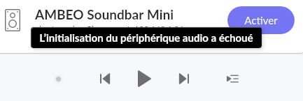

DSD Files up to 512 are NOK. Error message in French "l'initialisation du périphérique à échoué"

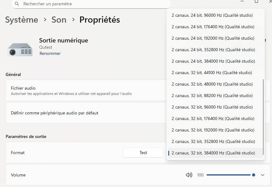

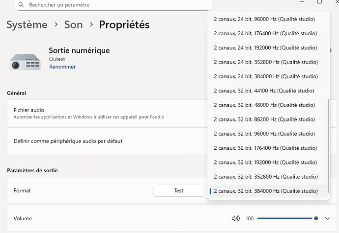

FYI,in W11 for Qutest->Parameters->System->Sound->Properties->Output settings->Format : 2 channels, 32-bit, 384,000 Hz (studio quality)
