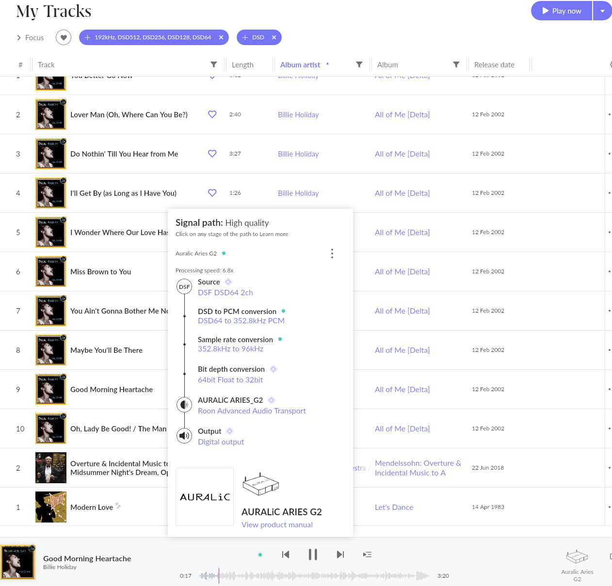

Every time I attempt to play DSD files of any bitrate, the file plays for a short time and then stutters and then stops with the error message “An audio file isolating slowly. This may indicate a performance or hardware problem.” And when I select the signal path of the DSD file, the Processing speed starts as high as 33x and then starts to progressively decrease down to 6.7-7.1x before the files stutters and stops completely. I’ve attached a screenshot of the signal path and accompanying error message.

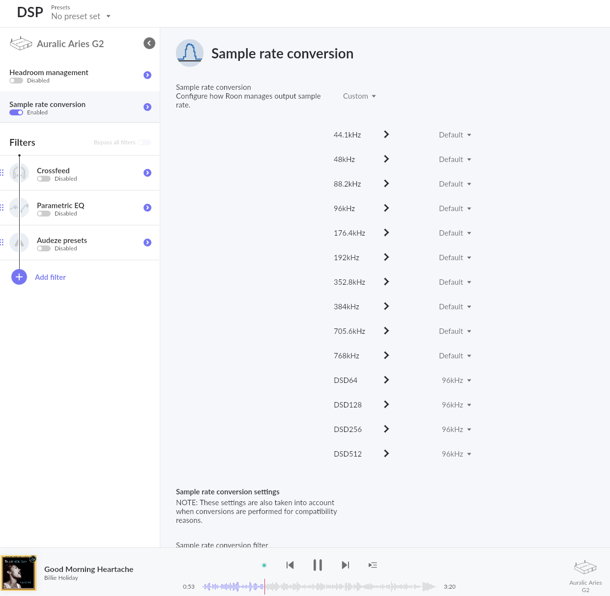

Yeah it affects every DSD track I try to play on the Aries G2 which I have connected to the Anthem AVM60. After trying other options like, as you suggested, turning off any/all DSP, both in Roon and on the Aries G2, the only way to play DSD files without getting the “audio file loading slowly message” is to set sample rate conversion for all DSD types to 96kHZ. See attached screenshots.
