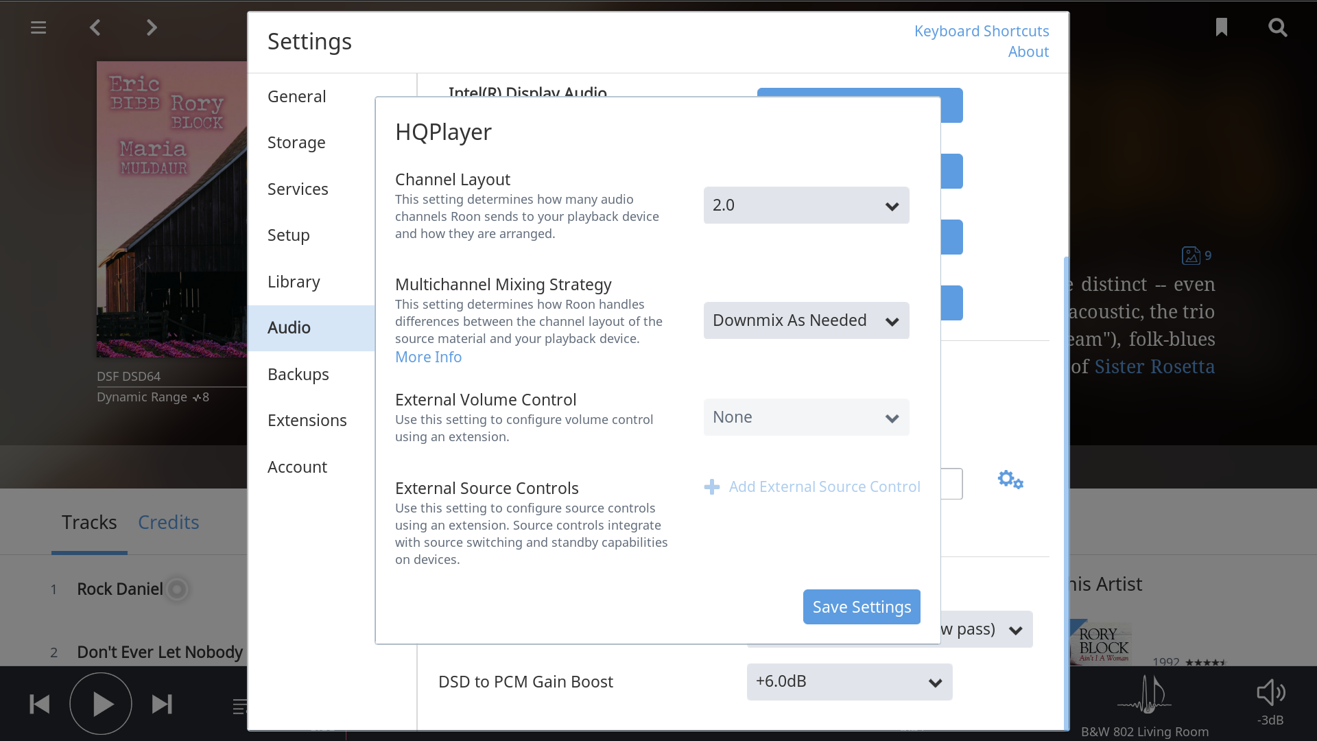

I am on Roon 32bit 1.3 (build 209), Windows 10 Home.
I have a number of DSD64 and DSD128 files. They are being downsampled to 352.8 khz PCM before being sent to HQPlayer. That is fine as we are in the middle of a move and it will be a while before I have access to a DSD DAC, but:
The seconds elapsed and the timer bar on the waveform does not keep up with the music. It is maybe 20 times slower. When the next track in a DSD album starts, the focus stays with the previous track. The waveform for the previous track stays on the screen and the timer bar just picks up from where it had stopped on the previous track.
I have Radio switched on. When the last DSD track plays, radio hangs. Nothing plays. In order to get the Radio playing again, I switch it on/off and play a regular PCM file and then everything starts again normally.
