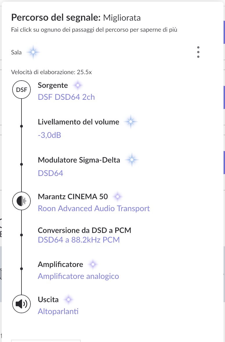

DSD native with Marantz Cinema 50 (now Roon Ready)?
music library and Roon Core on Qnap NAS, Unifi network, Core on the same vlan as Marantz

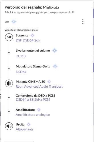

What‘s the issue, the conversion to PCM? As the signal path shows, this happens after Roon hands off the stream to the Marantz, inside the Marantz. Nothing Roon can do about that.
Hey @Andrea_Riela,
Thanks for writing in! Based on the screenshot you’ve provided, @Suedkiez is correct in the above statement, the conversion seems to be occurring after Roon hands the signal over to the device itself.
I’d check the Marantz itself for any DSP occurring. Let us know the results!
Do you use regular passive speakers (wired) or wireless ones?
In case you use active wireless speakers the end of the story is pretty clear.
No Marantz or Denon amp/AVR is able to transmit DSD or multichannel wirelessly through HEOS.
So in order to deliver DSD stereo somehow it has to do an internal DSD2PCM conversion we seem to see in roon’s signal path.

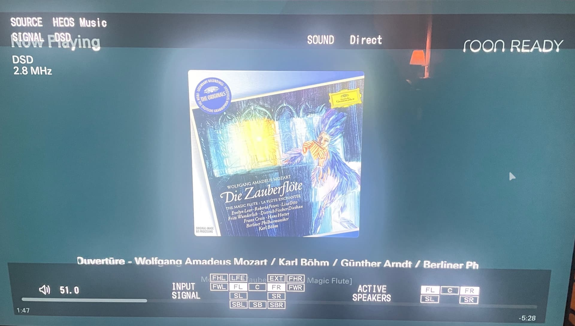

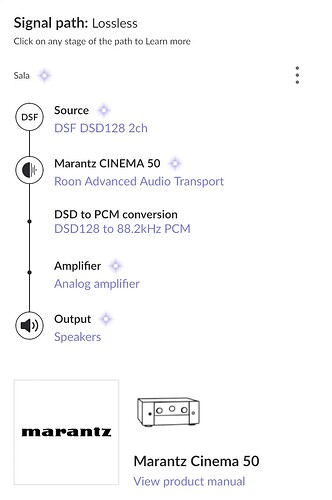

@benjamin a bug in Roon perhaps? the “info” displayed by the AVR is reporting “signal DSD” and also on screen. Why here Roon is reporting there is a convertion from DSD to PCM?

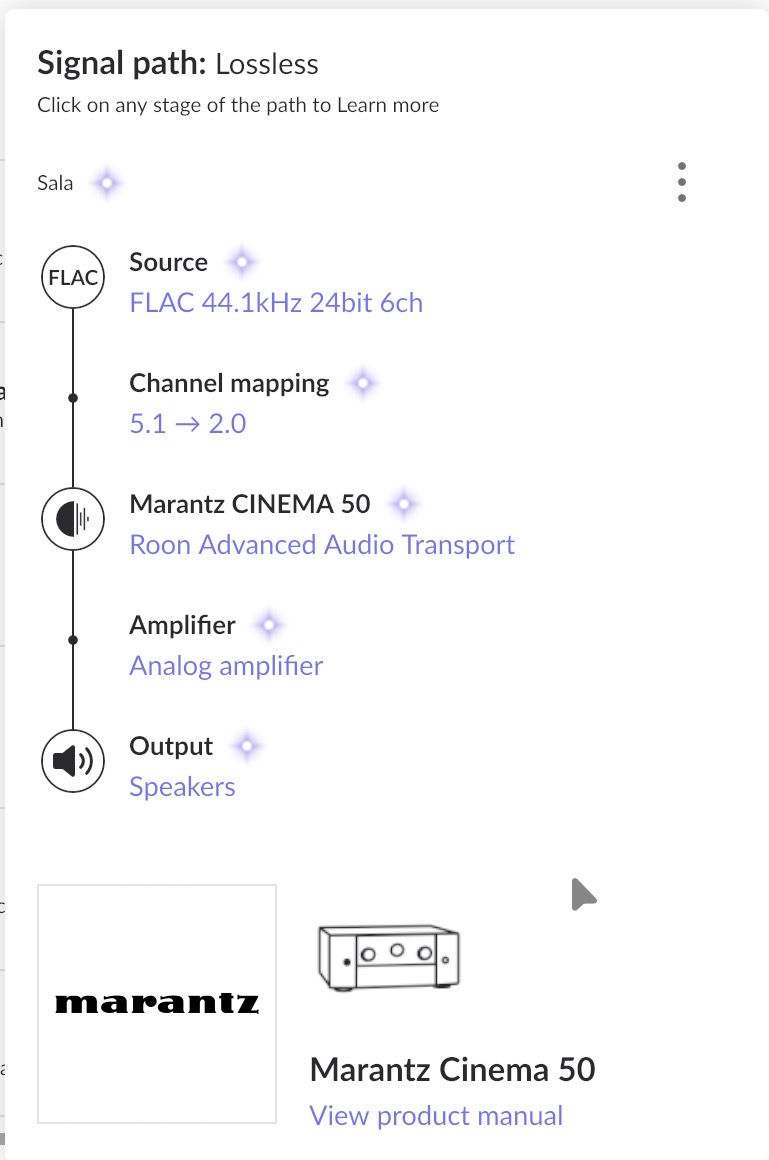

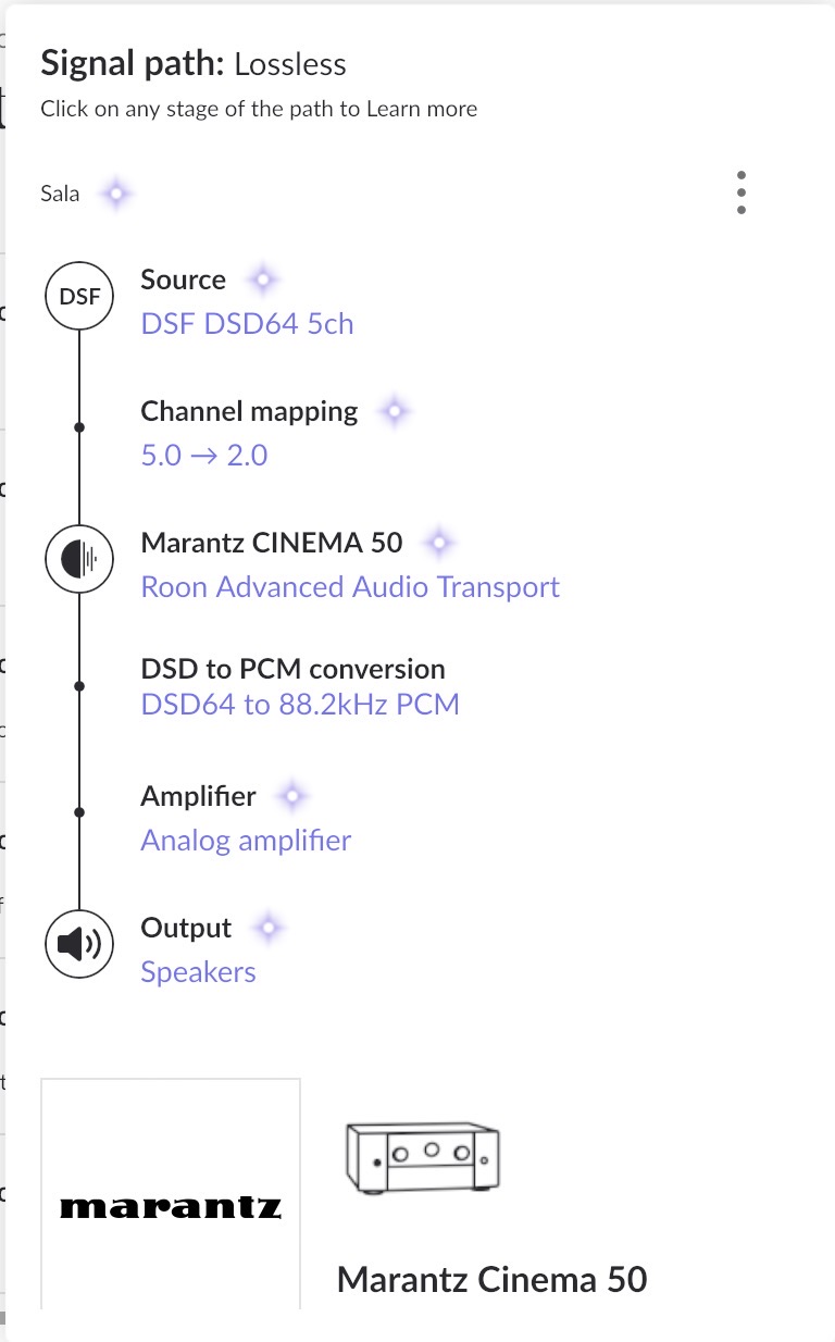

if you see the attached pictures, the behavior is expected for multichannel (DSD and FLAC), but not for DSD (64 or 128)
No, not likely a bug.
Most AVRs receive then internally convert DSD to PCM. That is a fact — but one they do not reveal to you. Roon, though, does reveal to you what is happening behind the curtain.

Hi @Andrea_Riela,
In all cases with a DSD source the Marantz is reporting back to Roon that it is converting DSD to PCM.
I’m 99.99% sure that Roon is transparently displaying what the Marantz is reporting.
The Marantz screen is correctly reporting what the input signal to Marantz is … however, this is not what is arriving at the DAC chip.
I don’t know that Marantz device well, but it’s not the first time that users are surprised about undocumented DSD to PCM conversion.
I would suggest contacting Marantz technical support to comment.
Because this is happening AFTER Roon hands off the stream to the Marantz. Either the Marantz performs this conversion or it reports it to Roon in error.
Any form of DSP inside the Marantz is likely to convert DSD to PCM. You could try if enabling the Pure Direct mode of the Marantz makes a difference:
no differences :frowning: either Auto or Direct /Pure Direct is reporting exactly the same on both the screen, and on Roon :frowning:
