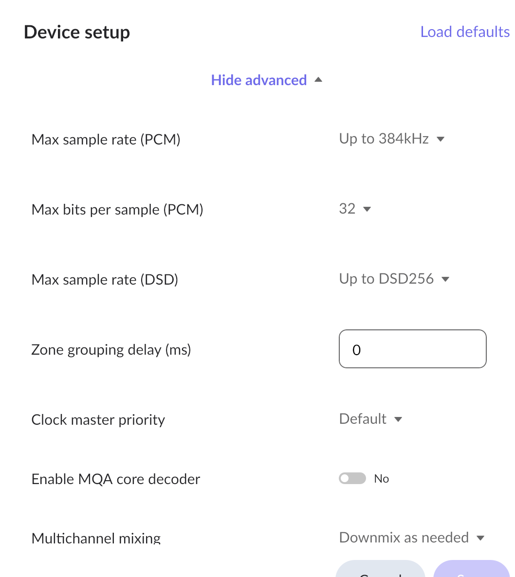

Could you please share a screenshot of the Device Setup for the Aurender? Also, if you have any DSP enabled in Muse, could you please share a screenshot of that as well?
Thanks.

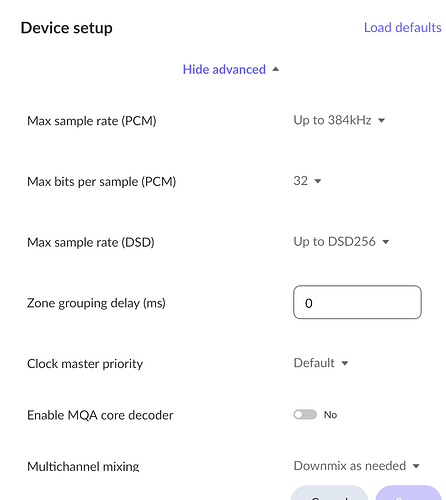

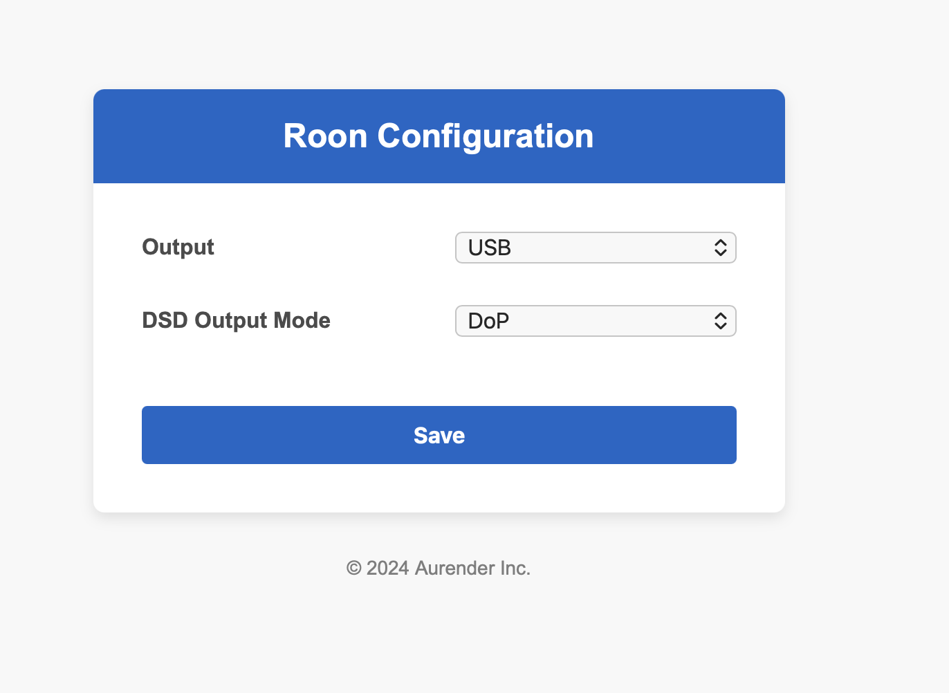

If I configure the device for Native DSD the option to set the max DSD rate disappears and then DSD is converted to PCM. If I configure the device as DoP then DSD works fine and I can set the max DSD rate in device setup
So no NATIVE DSD but only DoP

Do we understand correctly that it works fine for you over DoP, but falls back to PCM when you set the DAC to Native?
Thanks.
Yes that is correct. Aurender is a streamer/bridge for Roon and the Marantz is connected via USB to the Aurender.

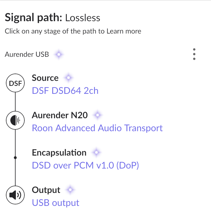

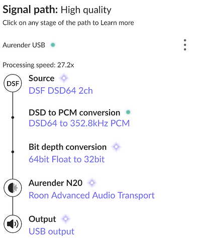

Could you please share screenshots of the Signal path when the Aurender is set to DoP and when it is set to Native DSD?
Thanks.
When in DoP
In Native mode

When you use Conductor or JPlay, Aurender talks to the Marantz using its own USB audio stack, and when the Aurender is used as a Roon endpoint, Roon relies on what Aurender reports to Roon and what Aurender reports the DAC can do over USB.
So the overall issue here appears to be that the Aurender does not expose Native DSD capability to Roon properly.
After reviewing the N20 feature page, this unfortunately might be a case where Native DSD isn’t actually possible. The N20 start guide mentions:
“On some Aurender models (see “File Type & Resolution Support” comparison table below), “Native” DSD output is available via USB. However, only a very small handful of select DACs support “Native” DSD input FROM A LINUX BASED SOURCE.”
Full page here:
https://ask.aurender.com/hc/en-us/articles/25260999249175-N20-Quick-Start-Guide?utm_source=chatgpt.com
Is there a particular reason you’d prefer not to use DoP in this case?
