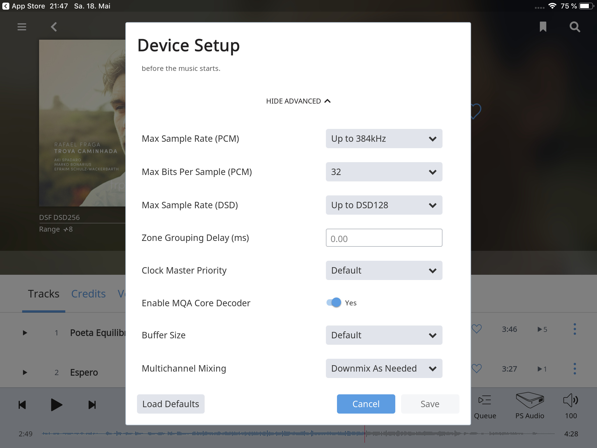

But then I noticed something. In Roon my Directstream has set 384 kHz as maximum sample rate (see screenshot above). That’s the standard setting when I click on ‚Identify your device‘ and search for the Directstream DAC. But the maximum for the Directstream DAC via USB is 352 kHz. Maybe this is the problem? What I have read is that DSD64 via DoP requires 174 kHz PCM and DSD128 via DoP requires 352 kHz PCM. But what is Roon sending to the DAC when DSD128 DoP is set? As Roon believes the DAC can do 384 kHz, is it maybe sending a 384 kHz DoP Signal to it, which the DAC cannot understand? Does anyone know? How can I set the maximum sample rate to the correct 352 kHz and not 384?

@support any idea how I could set the maximum bitrate for the Directstream DAC correctly? its 352khz and not 384. I only can choose between 192 (or lower) and 384. maybe that would also solve the DSD128 problem.

The maximum input sample rate of the PS Audio DirectStream DAC USB input is 352.8kHz. This should allow for playback of DSD128 content via DoP.
The maximum sample rate being shown as 384kHz in Device Setup screen is a bug, and I have reported it to the QA team.
