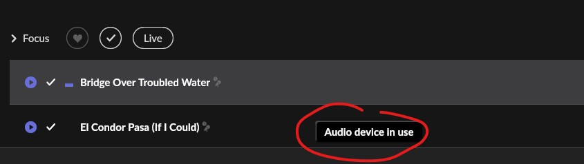

Playing DSF drops out then continues from NAS and from local SSD. Tried WASAPI same result but cannot play next album in queue (Device In Use). Other apps works (JRiver and Foobar).

Also, using WASAPI, I get Device In Use going from album to album. ASIO plays through. Both drops out.

Tried rebooting and now even a new launch of Roon results in Device In Use when trying the WASAPI driver. Transferring zone to the ASIO driver works. Also, swapped USB port…same result.
