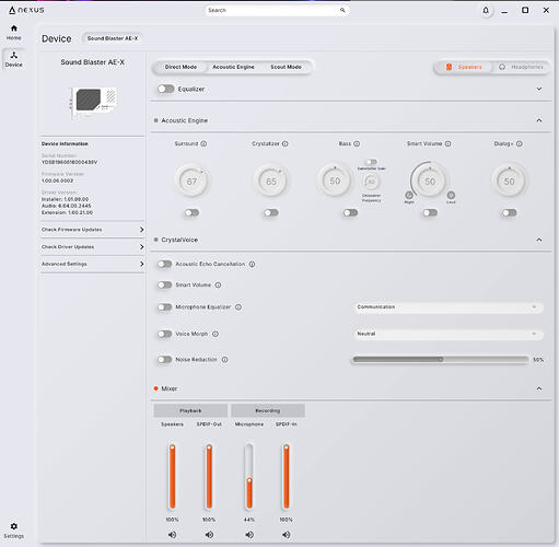

This usually indicates that some DSP processing is happening, destroying the DSD signal. Please make sure no processing is happening on the signal from Creative Labs’ sound card driver setup.

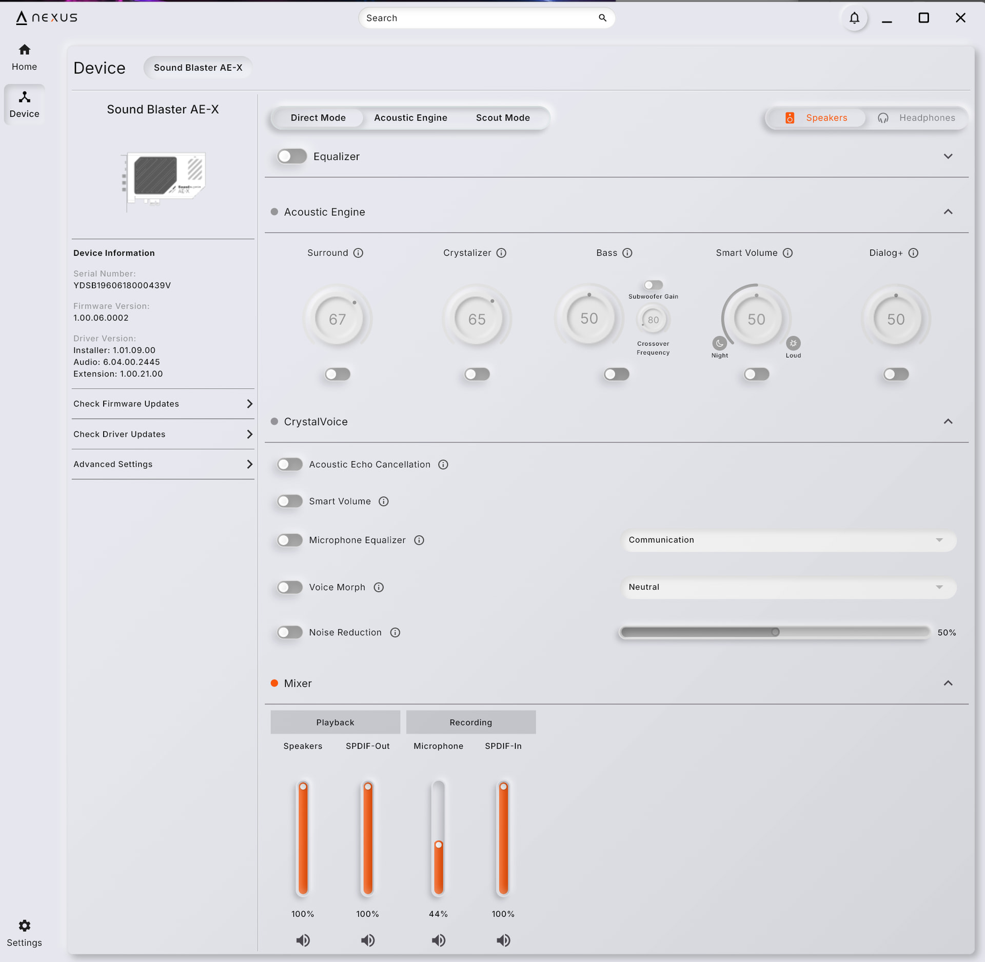

Actually, if I hit play the ASIO device just disappears and i get the ‘select audio’ device button before it re-appears. This is in ‘native’ playback (default) mode. If I select DoP or initial DCS method, the song will appear to play and there’s just a hiss. Nexus shows the card is in ‘direct mode’ and even if it wasn’t all processing features are off by default.

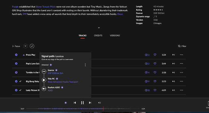

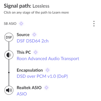

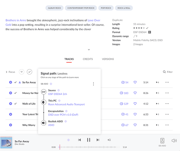

They’re all stereo DSD tracks ripped from SACDs in DSF format. If I choose ‘native’ it’ll fail so I can’t show the signal path. But if I select DSD over PCM, it looks like this:
So Roon is sending DoP not “native”.

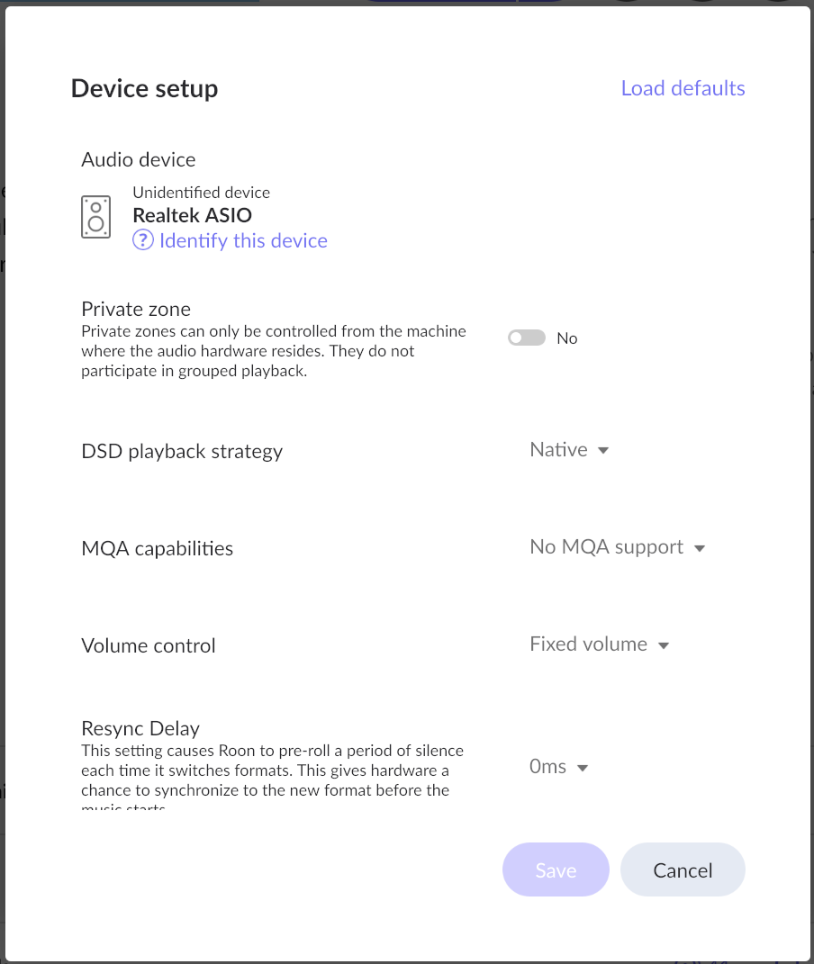

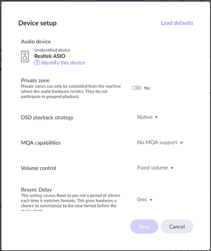

If you scroll up a little, you’ll see where I linked to a video that demonstrates Roon’s behavior when I try to play the track using the default ‘native’ setting of the AE-X’s ASIO device in Roon.
I know it says ‘Realtek ASIO’ but it’s the AE-X’s ASIO, Creative hasn’t renamed it to ‘SB DSD ASIO’ like in the AE-7. Otherwise I’m not sure I understand your question.

But Roon is sending DoP not native. See your screenshot:

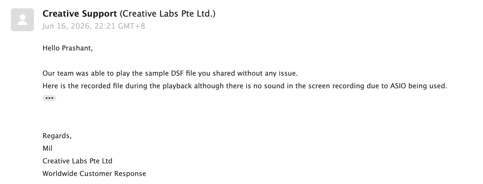

Hi Benjamin! Creative support claimed they were able to play the dsf track I provided them using the ‘Realtek ASIO’ device in Roon. Mil (agent) intended to attach a video showing them playing it but I think they forgot to attach it. So waiting for the actual video.

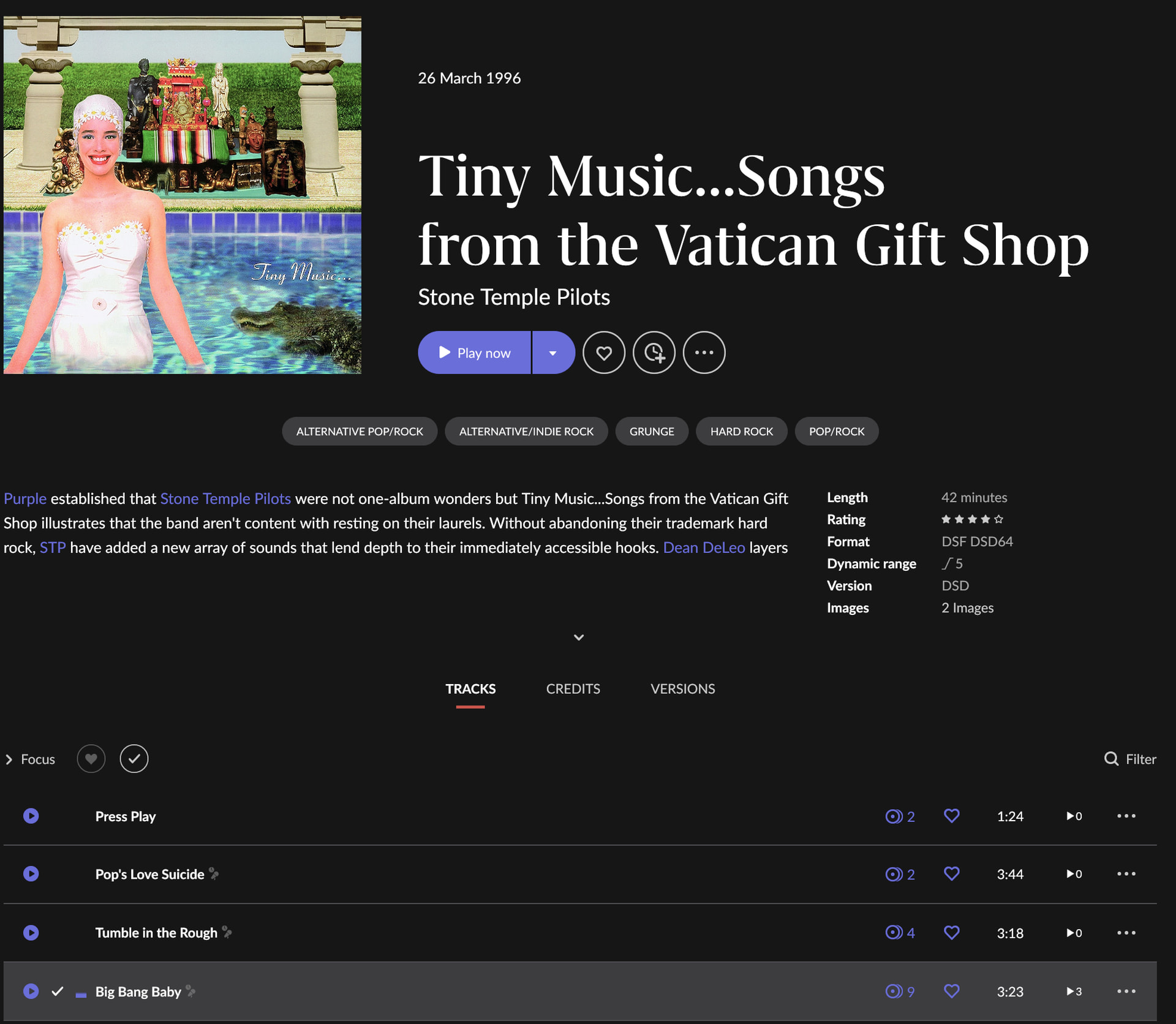

Track: Stone Temple Pilots - Bing Bang Baby
Format: DSF DSD64

Here is the video the Creative team provided showing that Realtek ASIO was playing the DSF file successfully in Roon. So I’m kind of at a loss at this point as to what to do on my end. I already wiped and re-installed Roon (which anyway I kinda needed to do since you have to use Docker on Synology now).
