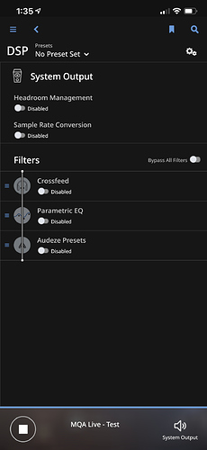

So…for all the ROON ‘laymen’ out here. Should the DSP toggle switch be on or off or does it not effect the SQ at all? 72 responses and I’m still confused…WTF?
I’m set up ‘as is’:
No difference.
Per @Brian, it can’t, based on what it does.
I leave it off as I don’t use it.
Hi, I think that back in 2017 there was an issue that caused an audible change in presentation with DSP toggled on for those that had really resolving systems. I believe that issue was rectified and it should no longer be the case. Regardless, common sense applies. If not using DSP just leave it off.
