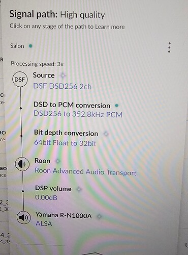

Volume control vs DSP Volume in Yamaha R-N1000 - change quality of sound. I have a Yamaha R-N1000 receiver with a DAC. It uses an ES9080Q DAC. In Roon, volume changes in device volume mode don't work, only in DSP volume mode. However, DSP volume changes the DSD audio transmission to 384 kHz PCM, which I'd like to avoid. I'd like the audio to be transmitted losslessly through Roon to my DAC in DOP mode. Is it possible to improve the driver for my R-N1000 receiver so that the volume control function works in Volume control mode, or if I change the DSP volume to 0 dB, the audio from Roon isn't changed to PCM? Of course, in DSP volume mode, changing the volume to -1 dB or -5 dB doesn't change the way Roon wants. Generally, when listening to music like 192 kHz FLAC, enabling 0 dB doesn't change the quality. The audio is transmitted to Roon losslessly. Only when I change the volume to, say, -1 dB does the quality change. Otherwise (0 dB), the dsp volume function works like volume control. Can you help me with this problem?

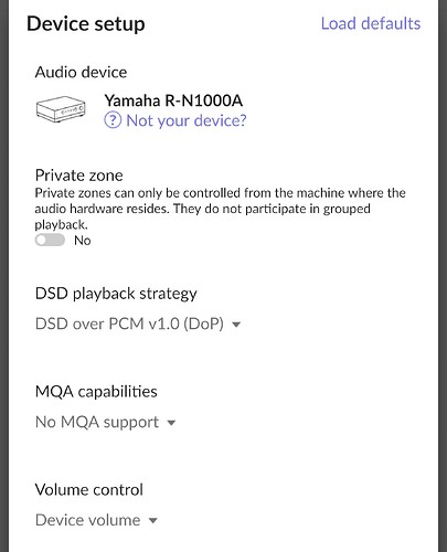

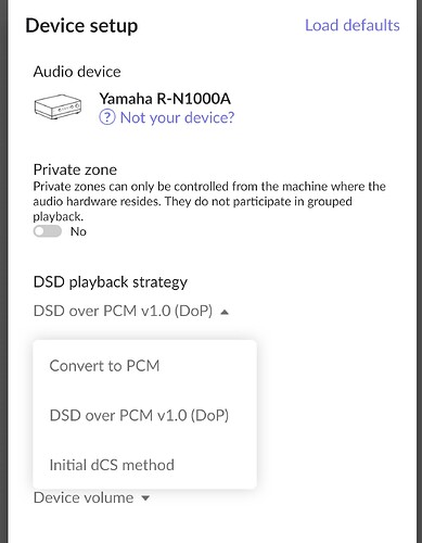

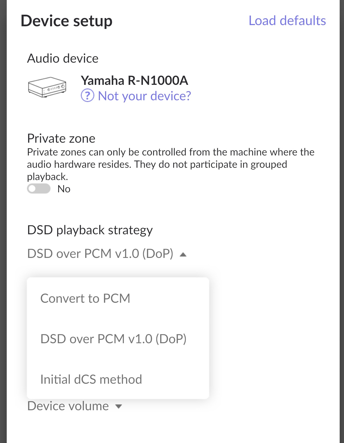

Can you please review and share a screenshot of: Roon → Settings → Audio → [Your Yamaha zone] → Device Setup → Show Advanced → DSD Playback Strategy.
If “DSD over PCM (DoP)” is selectable, try enabling it, that would let Roon send DSD natively. But if it’s not available, your Yamaha’s input/driver simply doesn’t expose DSD capability to Roon.
Are you connected via USB?

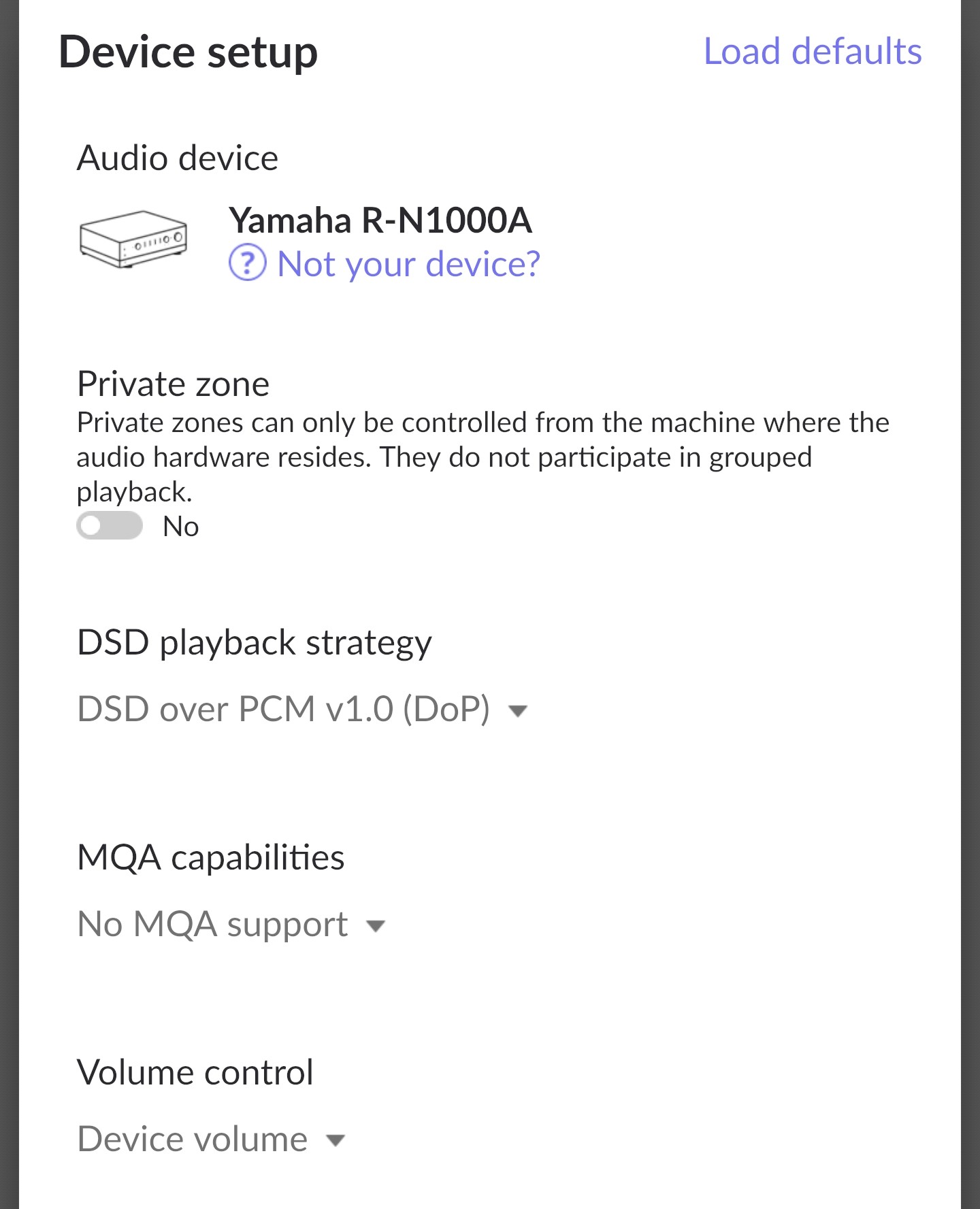

Roon and Yamaha work without any problems in the Convert to PCM and DSD over PCM strategies.Initial dCS strategy doesn’t work. In the latter strategy, I’m transmitting audio from the RoPieee (end point) via USB to the Yamaha R-N1000. Attached is a screenshot of the settings you requested.

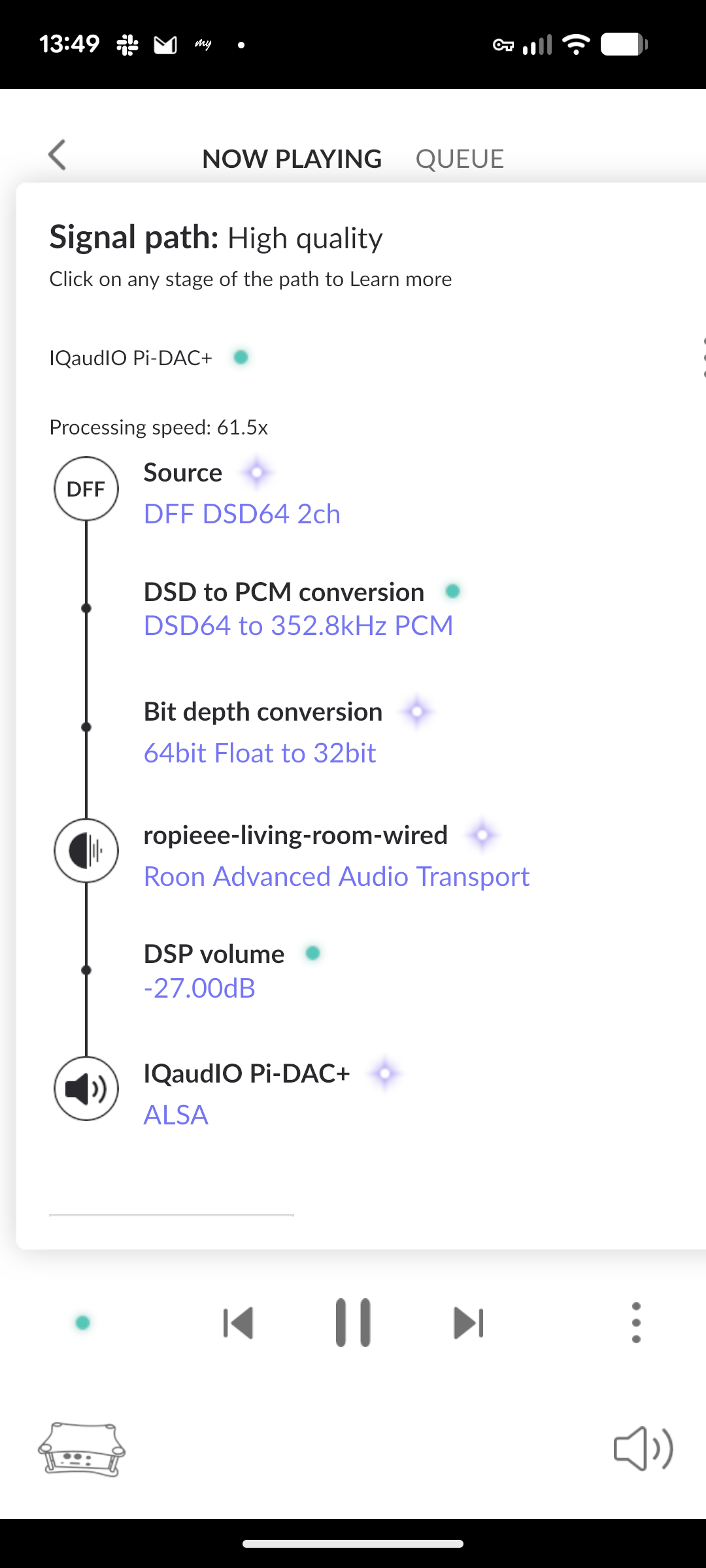

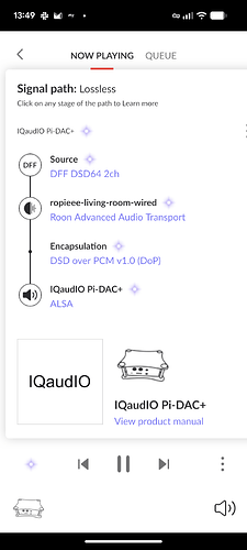

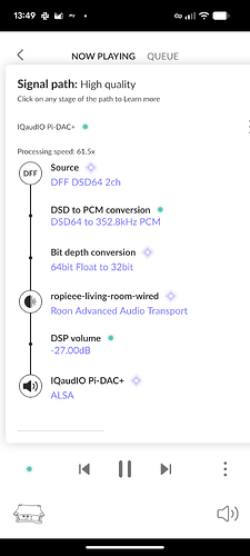

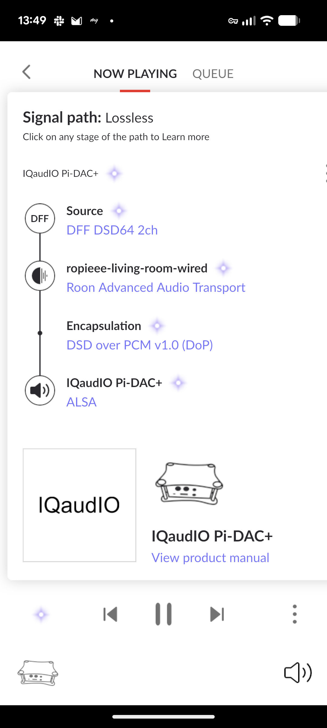

When using a Raspberry Pi running Ropieee via a DAC hat, I see this in the signal path.
DSP volume — conversion to PCM precedes the RAAT logo as the server performs it. DSP volume control occurs at the streamer (Roon Bridge / Ropieee.)
Device volume — Signalling recieved by Roon Bridge / Ropieee, and controlled by Roon. DAC hardware makes volume adjustments. In this example, DoP is used over ALSA.
Fixed volume looms the same.

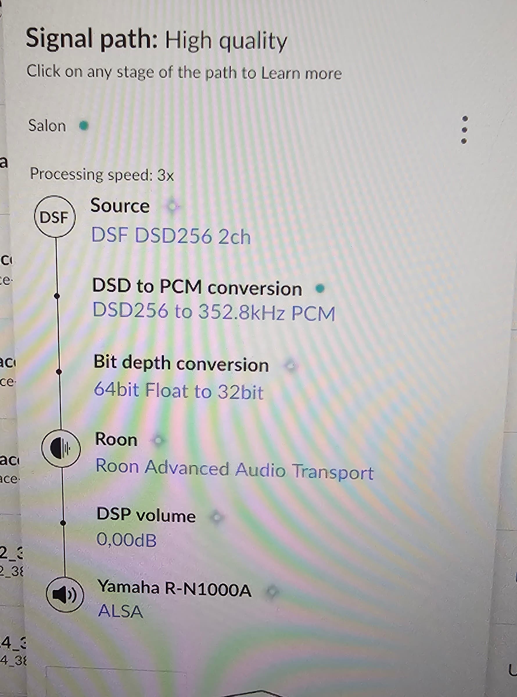

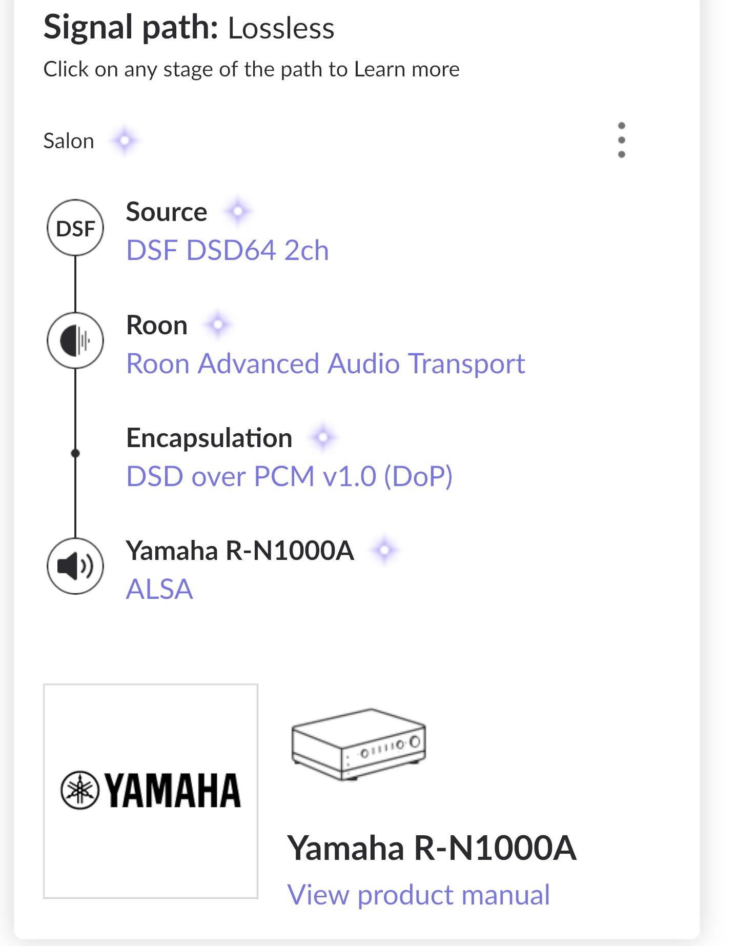

I have a Yamaha R-N1000. When I connected my Windows PC to the DAC, the WASAPI driver appeared. There’s still no Native DSD mode. One interesting thing about the ALSA driver is that changing the DSP Volume doesn’t change the icon in Roon’s settings, and the sound remains lossless. RoPieee displays High quality instead of lossless. I want it so that when I set the DSP Volume to 0 dB, Roon thinks the Device Volume is set and doesn’t convert DSD to PCM. Now, when I play FLAC files in DoP mode, it’s fine. The sound is unchanged, as much as FLAC files allow. But with DSD, it immediately changes to DSD to PCM, regardless of whether the volume is 0 dB or -5 dB.
Is there a way to configure this for the Yamaha R-N1000? DSP Volume set 0 db means change strategy like Device Volume with out any changes. When DSP Volume set higher than 0 db set DSP Volume scheme and do anything like dsd to pcm 352.8 khz. Right now I must change from dsp volume to Device volume for listening dsd files without any changes of Bitrate.

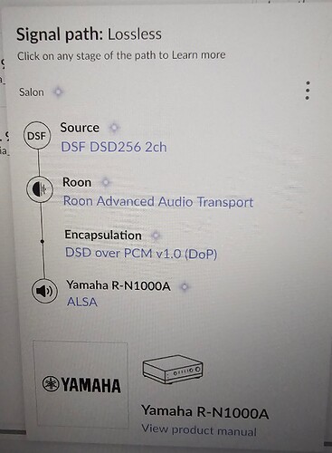

DSD and Device Volume
DSD and DSP Volume
I’m struggling to understand the issue. Both of the last screenshots show a DSD source sent to ALSA (Linux / Ropieee.)
As expected, with DSP volume control, Roon converts DSD to PCM. This is correct.

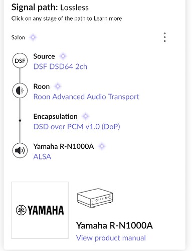

In the first image, DSD (DoP) is sent to the DAC. In this instance, you are using either device volume or fixed volume.
There is no native DSD on either Linux or macOS, because Yamaha haven’t provided a driver.
Nonetheless, DSD64 using DoP is identical to native DSD64. The only difference is the encapsulation, but the DAC will read a native DSD stream.
The only limitation of using DoP with your DAC is that you can only play up ro DSD128 (DSD256 on Windows.)
Perhaps my English isn’t good enough; it’s not my native language. Generally, the DSD signal is sent to the DAC without any change when the Device volume is set. My Yamaha display shows DSD64/2.8 MHz. When I switch to DSP Volume and set any volume, the sound transmitted to the DAC is changed to 352 kHz instead of 2.8 MHz DSD64. I care about DSP volume because I have an OSMC remote that can control the Roon/RoPieee volume. Of course, if I want 100% quality, I have to change DSP Volume to Device Volume, as the quality of the sound transmitted to the DAC doesn’t changes still dsd64/2m8 mhz. For FLAC, WAC, or non-DSD files, setting DSD Volume to 0 dB doesn’t change the quality, as it’s as if the function weren’t enabled.
This is expected because it:s not possible to apply DSP to DSD.
If you want to send DSD to the DAC, you cannot use DSP. However, if you are concerned about Roon’s implemenration of DSP volume, this is unfounded as it is equal to anything in hardware.
I understand that my suggestion is impossible, so that when set to 0 dB, the DSD Volume function works for DSD files like the Device Volume function. I’m referring to an additional procedure that would allow the function to behave slightly differently in certain situations. Nothing is impossible in computer science :slight_smile:
But, when set to 0 dB, there is no volume adjustment, i.e., no DSP is applied to the source. As soon as you adjust the volume using DSP, DSD will be converted to PCM.
You can’t change this behaviour because it is impossible to change DSD (analogue represented using pulse-density modulation) volume using software without converting to PCM (analogue represented using pulse-code modulation) first.

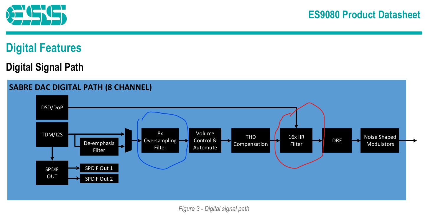

To be fair, I don’t think the conversion to 352.8 kHz PCM is going to degrade the sound in any audible way. I bet this signal bypasses the ES9080Q DAC’s internal 8x up-sampling filter (marked with blue) and goes only through the IIR filter (marked with red) and modulation. Note that DSD also goes through the IIR and modulator, so you’re not really getting 100% “native” DSD playback anyway.
