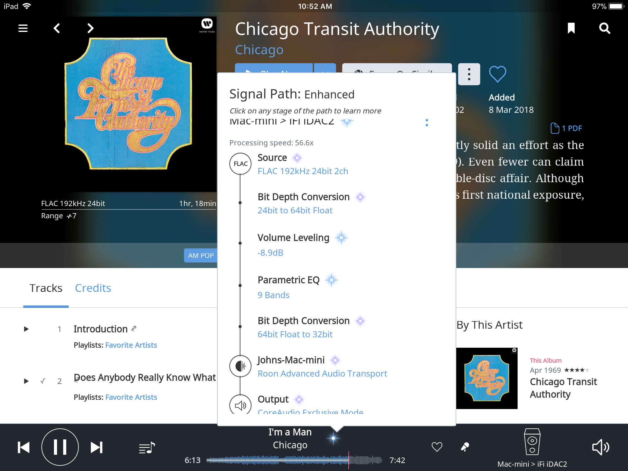

Here is my Signal Path:

I believe that volume leveling necessarily does its thing prior to the peq. So it will not help with clipping. Use headroom management for that. Also try not to use too much boost in the peq. Unless your trying to correct a problem with the original recording , a boost to the low end and a boost to the high is typically all you need , ymmv.
But I have to ask what hardware are you using to get a processing speed of 56?

I’m using a high end 2017 iMac that has a quad core 4.2GHz I7, an SSD, and 40GB RAM.

Funny that the album I was playing when I took that screenshot seems to be the worst offender as far as Processing Speed. It usually never shows!

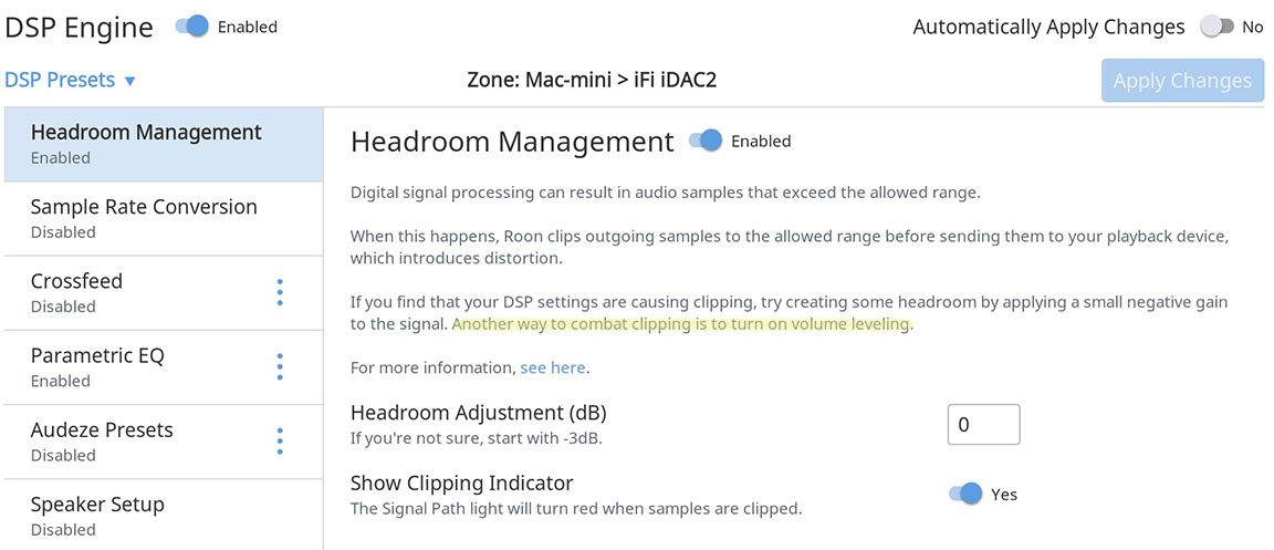

FYI- According to the Headroom Management panel, you don’t need negative headroom if you enable Volume Leveling:
I have Volume Leveling set to Auto. I’ll keep the Clipping Indicator enabled and report back if I should see it show clipping.
