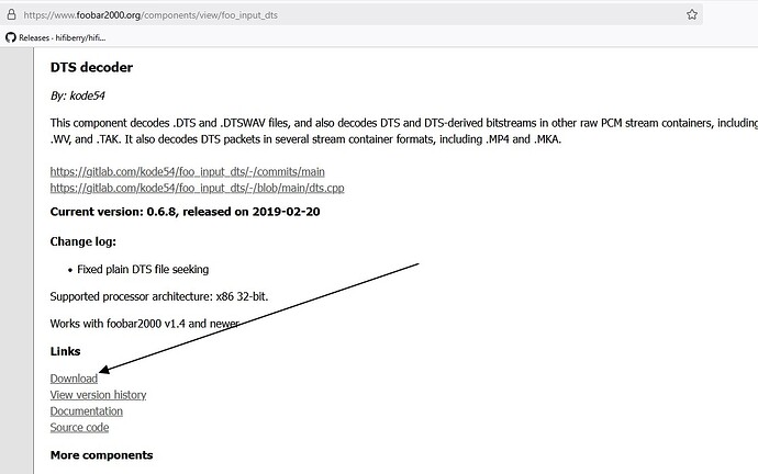

First make sure you have DTS decoder installed in Foobar. You can check this under “File/Preferences/Components”
If not, go to the Foobar website and search for DTS decoder, donwload and install it.

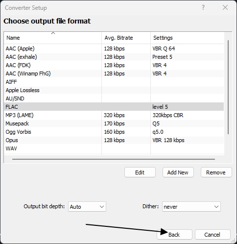

After that open your wav DTS files, right klick on the files, choose “Convert to” and klick on the dots below.
Choose Flac as output and go back to the previous window
Flac 5
klick on "convert, choose your directory and you are done.
