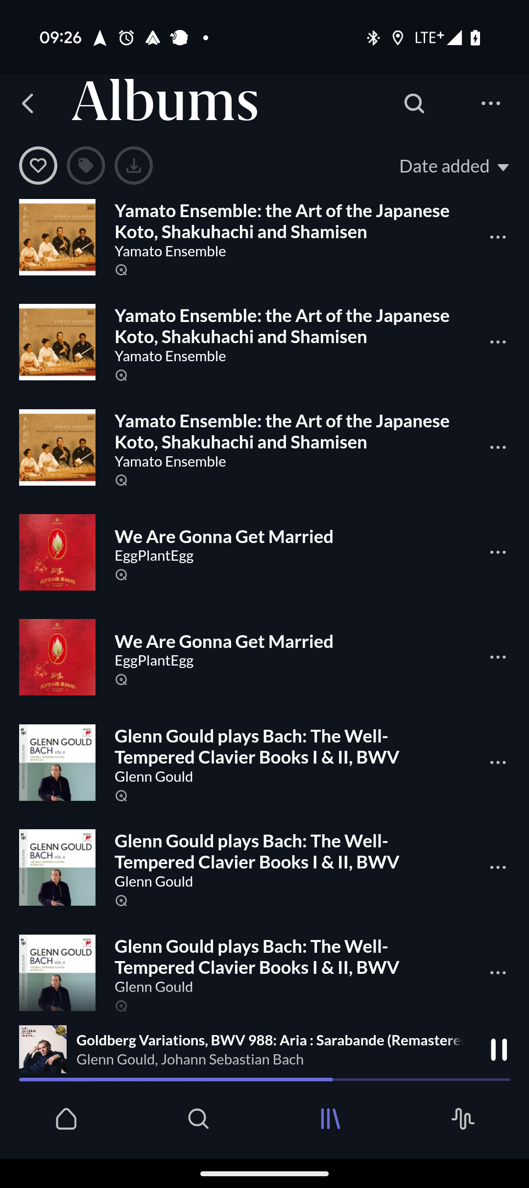

Duplicate albums displayed in Roon ARC (ref#76ER6U)
Arc displaying duplicate albums
Simple ISP router via pppoe, single lan. Server attached to wires lan. Arc working properly almost all the time.
But with recent usage, albums list is full of duplicated albums
I can’t explain why it does this but I can tell you that if you disconnect Arc from your Roon Server and then reconnect it will restore order…at least for a while.

I believe all the dupes were from Qobuz and nonlocal, but unfortunately it had not reproduced itself since I restarted the server couple of days ago. Would it make sense to close this for now and reopen when it happens again?
One additional point which I think might be the trigger is that the first time I saw this was when I connected to Android Auto and noticed the duplicated albums in the AA album listing, and then looking back to my phone, ARC also displayed duplicated albums.
The server was restarted after I got home and it hasn’t manifested itself since then, will report back the next time it gets connected to AA.

Does this duplication issue ever not occur after connecting ARC to Android Auto? What about if you turn ARC on first outside of the car, navigate to the Albums page, and then connect?
Can confirm that if I start ARC before connecting to AA, the duplicates don’t happen.
