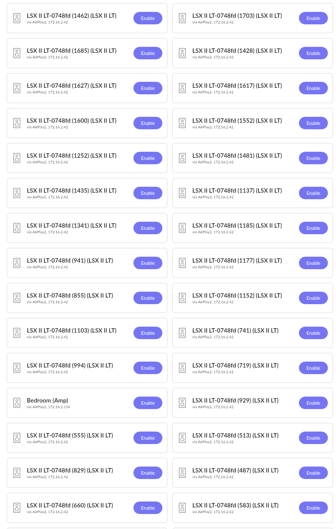

Something went nuts and my Kef LSX II LT on my PC is showing up hundreds of times in Settings > Audio > Other network devices. How do I clean this up?

Uh oh. So I deleted the contents of the Core folder (after making a copy) and Roon stopped working. It would start but my PC would forever be trying to connect. I waited over half an hour. Restored the contents.
Then I told it to restore from a backup from 1/5 which is before those endpoints were added. After the restore, it relaunched the server and now everything is completely hosed.
The roon server process won’t start up properly and I’m now Roon is completely dead in the water.
OK, I’m back in business.
So I noticed that Roon created a .restore_on_launch folder in the root RoonServer folder. I guessed that these were probably the files that were to be restored. For whatever reason, Roon wasn’t copying them over and the process was just cycling on and off. So I manually made a copy of the root RoonServer folder in case I needed to restore it, deleted the Database and Settings folders and moved over the ones from the .restore_on_launch folder.
Restarted Roon and that successfully took me back to before I added the LSX II endpoint - and now when I go to audio, I only see one LSX II endpoint in there as intended.
Thanks for pointing me in the right direction. Was a bumpier ride than expected, but we got where we needed to be in the end.
