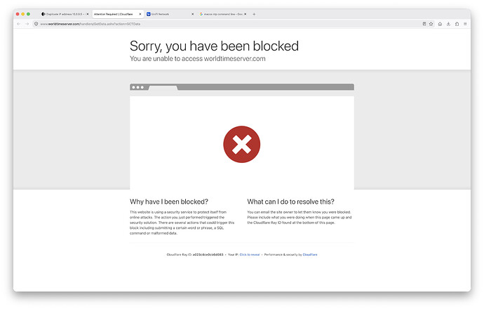

  • After that I try to get the time from worldtimeserver.com. This also seems to fail. Maybe also a firewall problem or is Signapore behind a great firewall like China?? Please try this URL in your browser:
    worldtimeserver.com/handlers/GetData.ashx?action=GCTData
    It should send back something like this:
    {"LocIDDescription":"Germany - ","LocIDLocationID":"DE","CountryCode":"DE","CountryName":"Germany","State":"Schleswig-Holstein","City":"Fehmarn","TimeZone":"Europe/Berlin","DstZoneName":"Central European Summer Time","DstZoneAbbrev":"CEST","StdZoneName":"Central European Time","StdZoneAbbrev":"CET","IsInDST":true,"ThisTime":"2026-05-27T10:18:39.9211725Z","DateTime_12HR":"10:18 AM","DateTime_24HR":"10:18:39","FormattedDate":"Wednesday, May 27, 2026","Lat":54.4378,"Lng":11.1935,"ErrorMsg":null,"serverTimeStamp":1779877119921.1724,"dataFrom":"IP"}
Please make sure that one of these time synchronizations work for you. I’m really interested why http://worldtimeserver.com did not work for you. It even works in China and I included it as there is a massive problem with NTP. Please let me know.
Regarding your idea about enabling WiFi only if there is no Ethernet I will think about it and hopefully can include it in the next release.
Best DrCWO

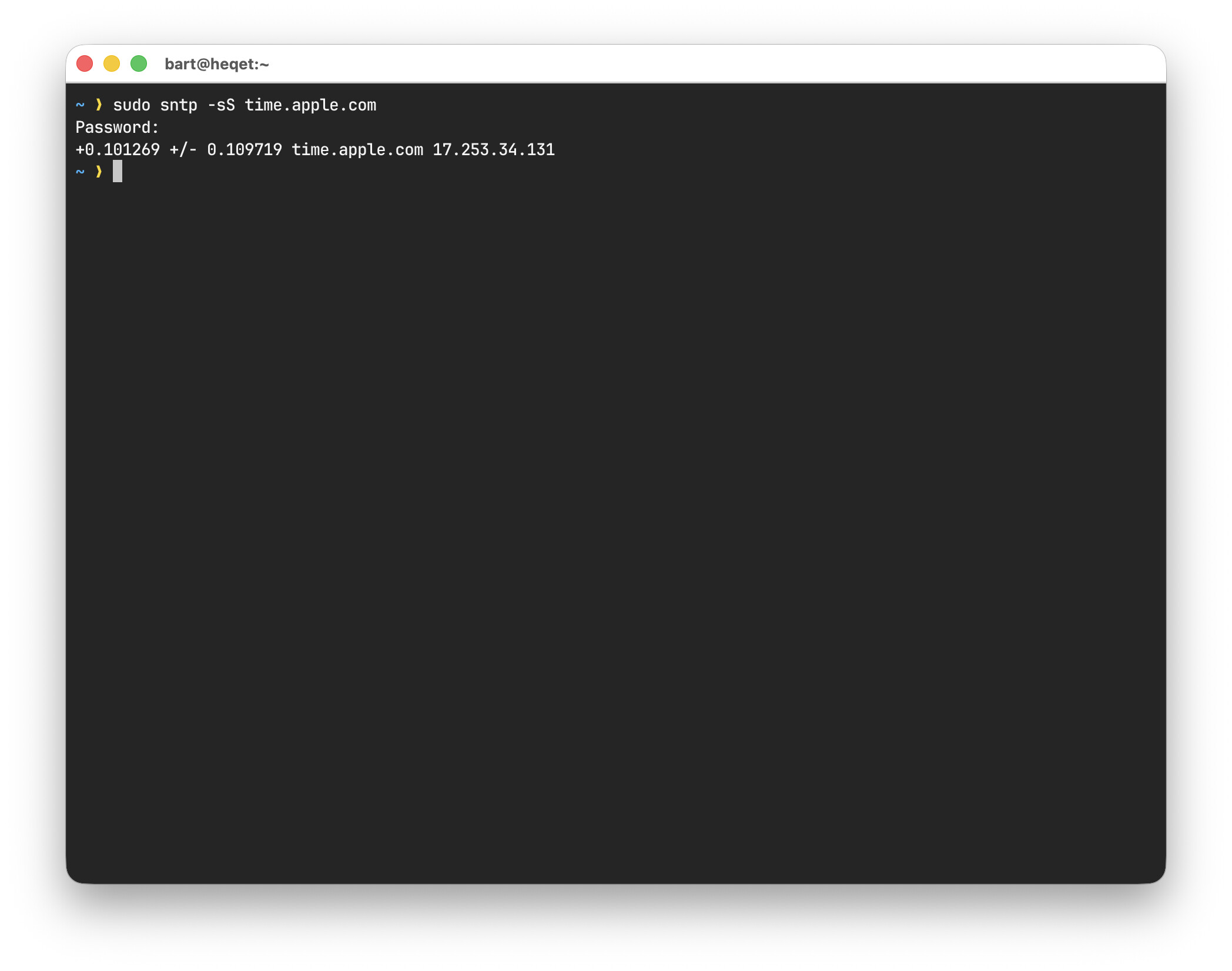

There are no issues with ntp here in Singapore, or any other traffic for that matter. Here’s a succesful ntp sync done from my mac:

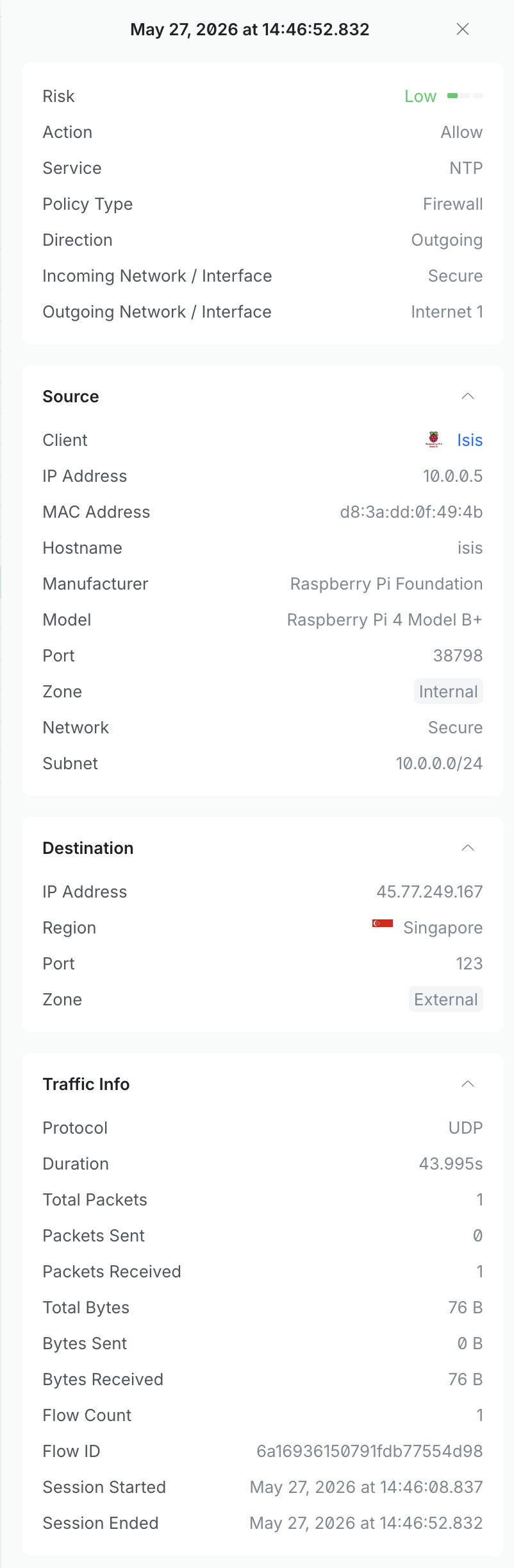

My firewall also records ntp requests from rooExtend directly (with 10.0.0.5):

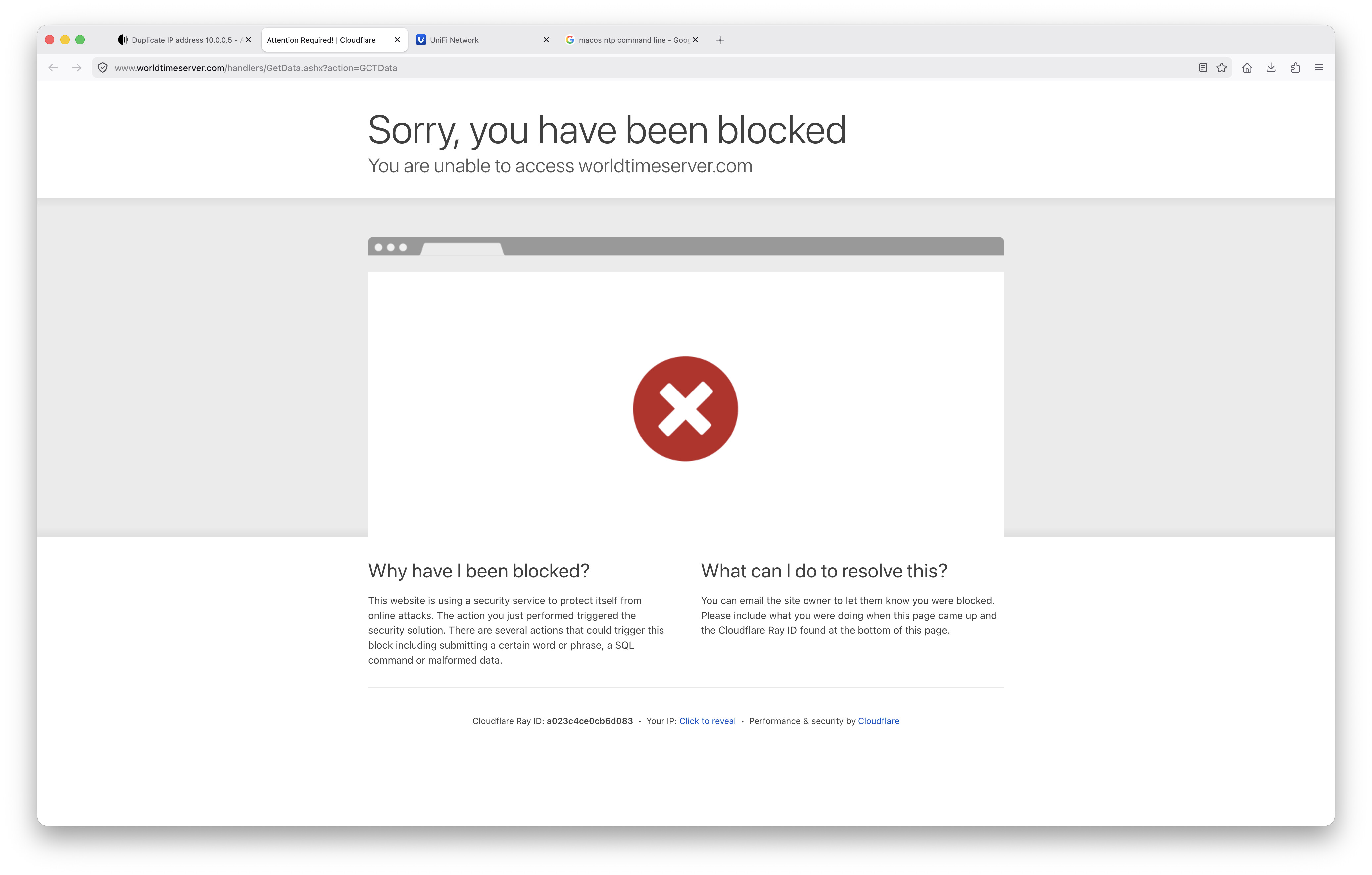

The request is blocked by worldtimeserver / cloudflare:

Apparently not only from my computer, but also from a droplet hosted on DigitalOcean:
wget --verbose --timeout=20 -O - https://www.worldtimeserver.com/handlers/GetData.ashx?action=GCTData
--2026-05-27 17:23:30--  https://www.worldtimeserver.com/handlers/GetData.ashx?action=GCTData
Resolving www.worldtimeserver.com (www.worldtimeserver.com)... 104.26.8.217, 104.26.9.217, 172.67.69.199, ...
Connecting to www.worldtimeserver.com (www.worldtimeserver.com)|104.26.8.217|:443... connected.
HTTP request sent, awaiting response... 403 Forbidden
2026-05-27 17:23:30 ERROR 403: Forbidden.

Ever tested if you can ping worldtimeserver.com? You see the same IP as I do. Here it works…
Thanks. Much appreciated!
The 403 error indicates that it succesfully reach worldtimeserver.com but that the server actively refuses to reply (as also evident from the cloudflare page I shared).
I’ve tested from:
  • my home isp provider → fails
  • my 5G telecom provider → fails
  • digitalocean singapore node → fails
  • mullvad vpn singapore node → fails
  • mullvad vpn belgium node → succeeds
  • @wizardofoz home isp provider → fails
And to answer your question, yes I can ping the domain just fine (it resolves to 172.67.69.199).
Strange. The IP is the same resolved here.
I learned from Gemini that sites are blocked in Singapore with explicit content. But worldtimeserver :face_with_spiral_eyes: I have no explanation.
Despite all the negative aspects that this entails, I am still glad to live in a country that has a free internet.

Unfortunately, Gemini is feeding you half truths.
While it may be true that Singapore sometimes blocks website with illegal content (whatever that may be), that almost always happens on the level of the DNS server of the ISP. And as you know, I am using a third-party DNS.
Being Belgian myself, I hate to break it to you: European countries also block very specific websites with illegal content.
In fact, sometimes Belgian banks and government websites, seemingly randomly, block entire regions (especially non-EU ones). Until I report the issue and they unblock it.
In this case, I very much doubt that the website is blocked by Singapore. Probably just cloudflare infrastructure blocking the region (for whatever reason).
