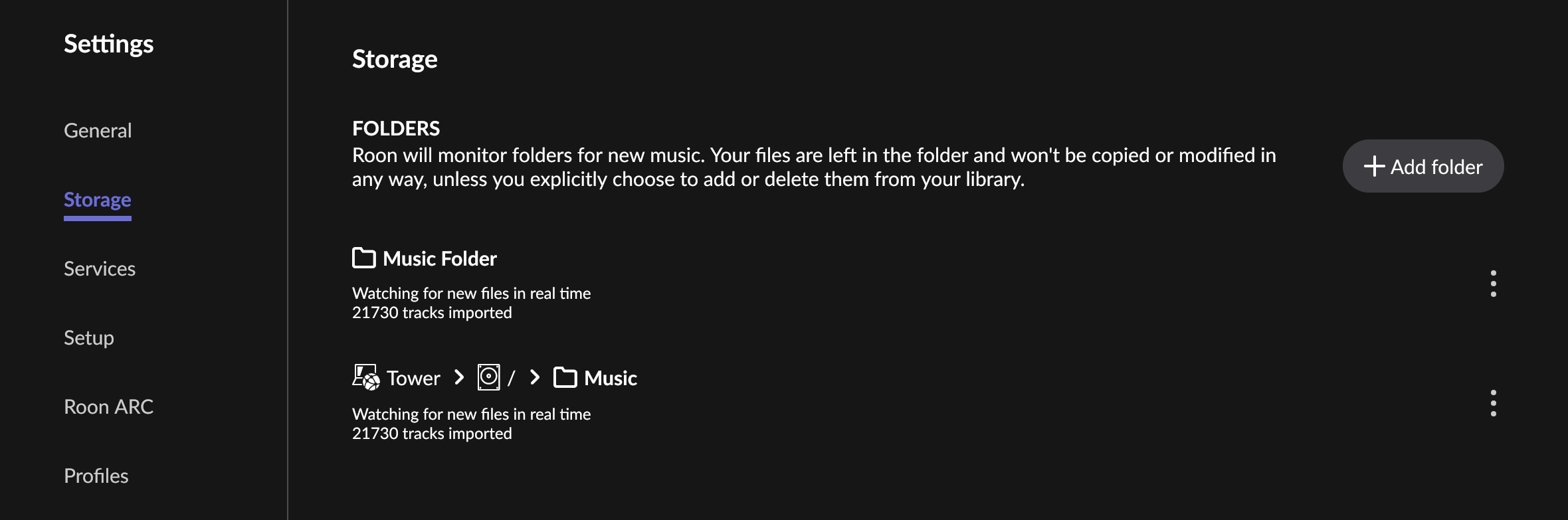

Hi all, am on unraid and was using the docker from @mackid1993 which worked really well. Made the transition to the new docker image with no apparent initial issues other than a mapping issue where, similar to a previous post, two mounts were required to the same folder to satisfy the mappings from the backup. Some songs will be marked as unavailable unless I map both. Songs don’t double up when navigating albums etc but do double the total counts of albums/tracks in the main screen. I don’t really care but if there’s a logical way to sort then open to suggestions. May just export my playlists start from scratch and rebuild but will see.
I do however now see that, in my smart playlists, anything that was hearted now isn’t. Does anyone else see that at all? Could be just something I screwed up (likely), but just mentioning if it’s some sort of weird edge case that may have cropped up.
Just to follow up myself I think in my situation I must have added a library reference when I last switched docker images without realising and not being able to replicate that exactly caused the issues I experienced. After waiting a while in a playlist Roon actually prompted "Improvements"which meant paths were fixed (though not favourites). Nevertheless just decided to tidy everything up for the official docker image - is quite refreshing going through the library again annd build a few extra playlists! Everything works for me in terms of functionality, Arc via Tailscale etc.
