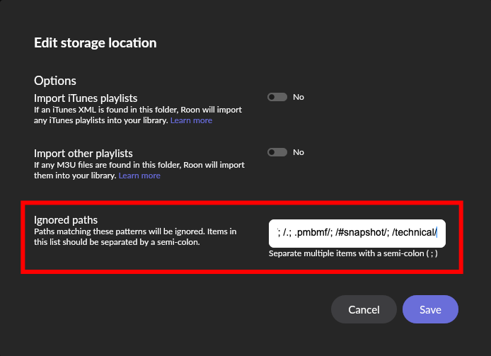

Multiple locations & subfolders
The documentation of the container on GitHub states:
If your music is spread across multiple locations on the host, mount each additional location at a named subpath under /Music
When doing this, the subfolders are automatically included in the default Music Folder in Roon, without the possibility of individually enabling / disabling the folder. While this is not necessarily an issue, I do know some users deliberately have subfolders to be able to easily add/remove certain music to/from Roon (e.g. enable seasonal music only around the holidays).
I see 2 ways to resolve this:
  1. Map the additional locations to a different subfolder (e.g. /Music2). This was it is not included in the default music folder and can be added and controlled individually
  2. Map the additional folders as a subfolder under music as instructed, but include the subfolders under the Ignored paths
Personally, I prefer mapping to a different folder as this is less complex, but I am curious about your thoughts on this.

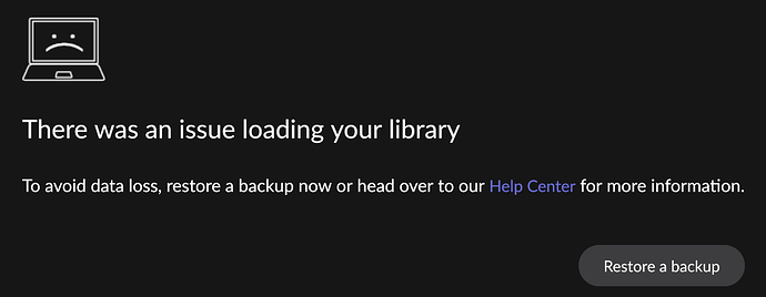

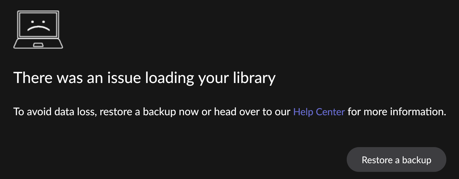

Running it on Ugreen DXP4800PLUS with 64GB RAM. Everything seems to work but backup. It is mapped but when it runs or I tried to run it manually, I always get this:
I can restore and old backup from the same location, but backing up to it does not work!
To get ROON running again without a useless restore, all I have to do is to go to Docker on Ugreen and restart Roon project or container.
Backup is mapped in docker compose as - /volume1/docker/RoonBackups:/RoonBackups
Any suggestions from anybody would be very welcome

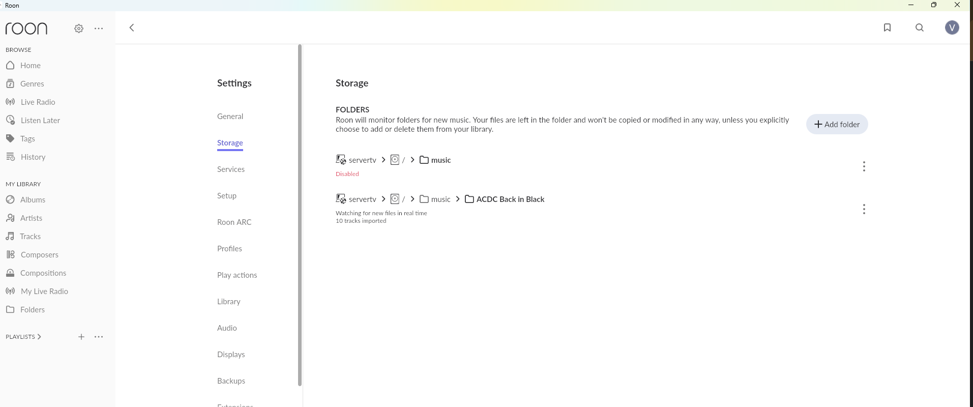

2. Music Folder Workflow @gTunes,
Just to add one more detail regarding your specific workflow and your desire for manual control:
Even with the default /music folder mounted in Docker, you do not have to let Roon automatically scan and import everything inside it all at once.
If you go to Settings > Storage in Roon, you can actually disable the default /music directory. Then, you can use the “Add folder” button to manually select and activate only the specific sub-folders (for example, /music/Newly_Ripped_Albums) that you are ready to add to your library.
This setup allows you to keep your automated robocopy mirror job running exactly as it is, while still giving you the exact manual control you want over what Roon actively watches and imports!

@tudupka,
Based on your recent post, it looks like you might be dealing with a corrupted database.
Because database issues require individualized troubleshooting and looking into your specific logs and backups, could you please open a new, separate topic in the Support category? This will allow our team to focus entirely on your issue and gather the necessary diagnostics without getting mixed in with the general Docker feedback here.
We will be on the lookout for your new thread so we can help you get this sorted out as quickly as possible!
