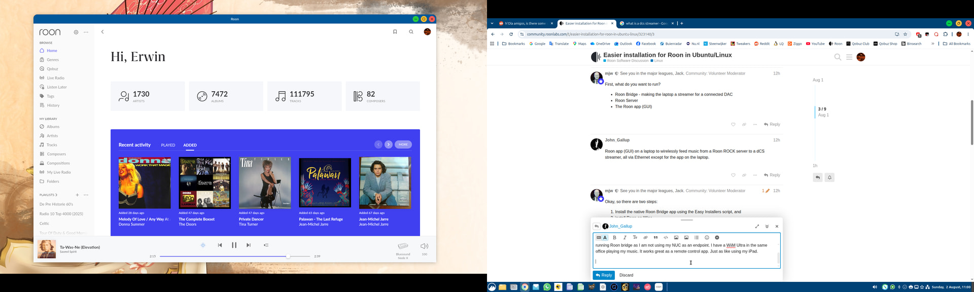

Is a dCS streamer a standalone device? If so. Then you could also just install the Windows version of Roon on Linux. I’m running Roon this way on my Linux Mint NUC by using Lutris. I am not running Roon bridge as I am not using my NUC as an endpoint. I have a WiiM Ultra in the same office playing my music. It works great as a remote control app. Just as like using my iPad.

If it does, then you can just install Lutris from your distributions software center. Start it up. It should update itself with extra components. And then install the Windows version of Roon from there.
Roon on your Linux computer will then just act like how it does on a tablet or smartphone. As a remote control.

If you wish to also have the user interface on your Linux system. Then you should install the Windows version of Roon. Either through Lutris or Bottles.
I can help setting it up through Lutris if you require help.
