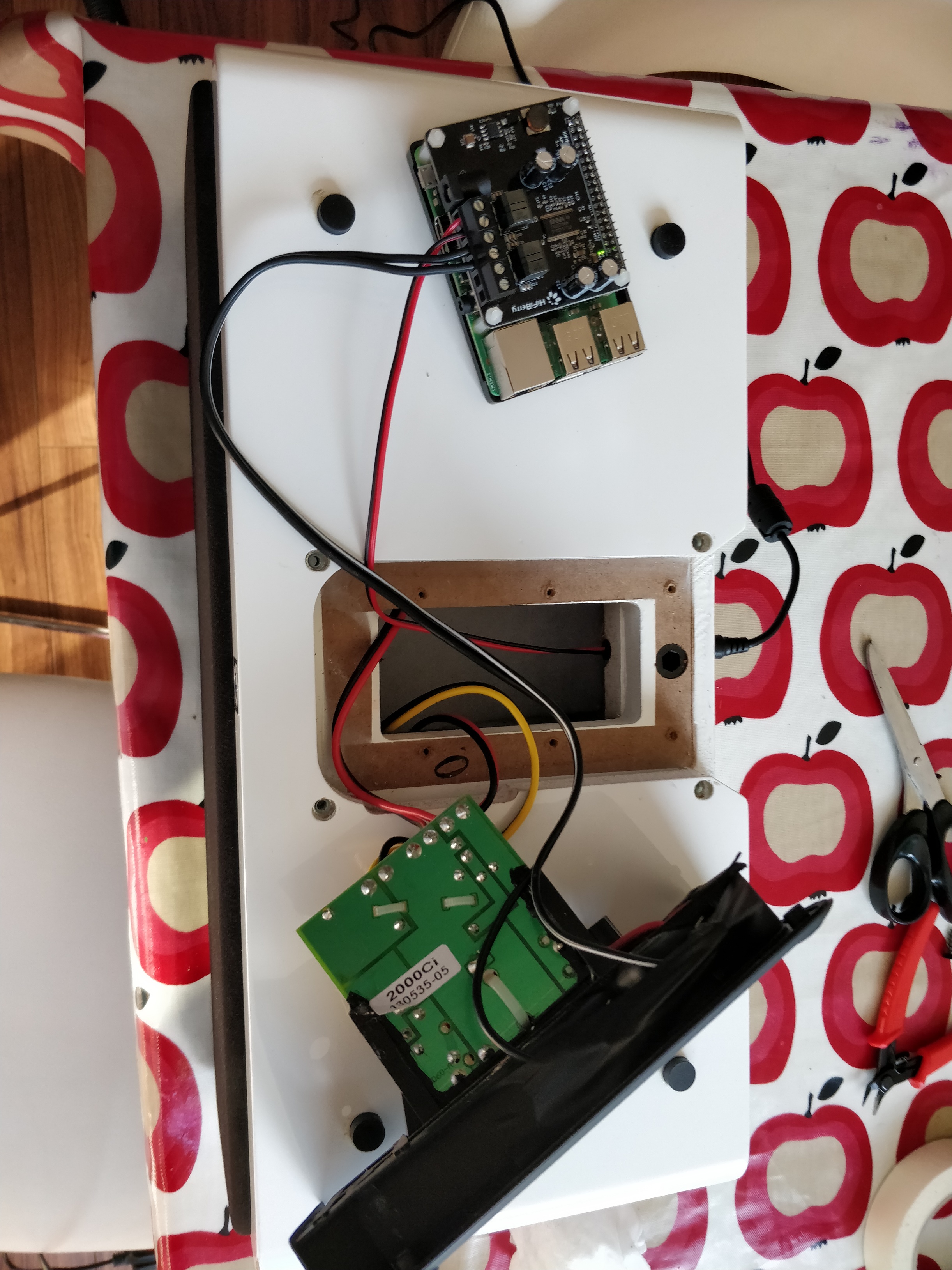

2nd one done. Mono speaker for bedroom. Using 2nd hand Qacoustics 2000ci and raspberry pi3 b+, HifiBerry Amp2. A little easier to do as it has in built wireless so only one hole needed to be drilled. And did not need to rewire the binding posts just disconnected them from the crossover and used some terminal blocks to connect to speaker wire from the Amp2. But not sure the wireless signal is strong enough to get 5ghz through the case. It was fine outside but struggles inside. So may have to settle for 2.4ghz.
Roon DSP downmixing to mono found out how on this very forum. I feel I need to do some EQ to balance it out a bit for music but need some advice here as I don’t really get EQ.
Courier managed to damage the cabinet in the lower left so some touchup required to sort that and the back where I added the power socket.
Before it goes in the case
Connecting the crossover
You can just see it inside :slight_smile:
In its new home
