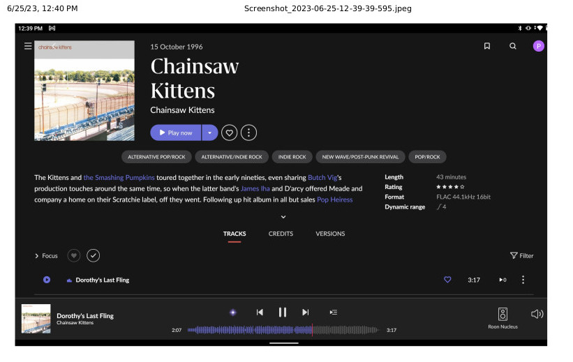

Following your suggestion, I bought a UPS, but, before installing it, made the mistake of switching off the power strip which had the Nucleus plugged into it. There followed a long period of trying to regain functionality of the Nucleus: I repeatedly power cycled the Nucleus, restarted the Roon server software, restarted the tablet with the Roon app, turned the McIntosh amplifier off and on, and reinstalled the operating system. This led to a Roon system that sends a signal to the Nucleus but has no sign of the McIntosh audio zone anywhere in the Roon app (see screenshot). Nothing has changed in the setup of my system described above.

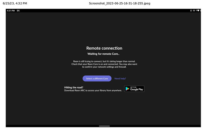

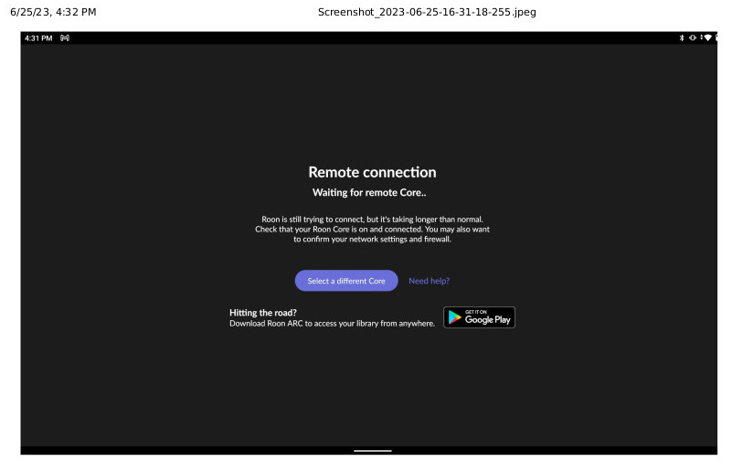

Update: I powered down the Nucleus using the web interface, and rebooted my modem and router. After the internet connection was reestablished, I powered up the Nucleus, only to find that the Roon app now does not find the Roon core.

After Step 2, the manufacturer, model, o.s., serial, and hostname appear, along with the messages: ‘Searching for network address … If this persists, please check your network connection’. No further effect of pressing ENTER. When I type ‘resetnetwork’, I get ‘Network settings reset. Hit enter to continue’. After I hit ENTER, I go back to the ‘Searching for network address’ messages.
When I reinstall the Nucleus on the network and try to access it with the Roon app, I’m back to the ‘Remote connection … Waiting for remote Core’ screen.

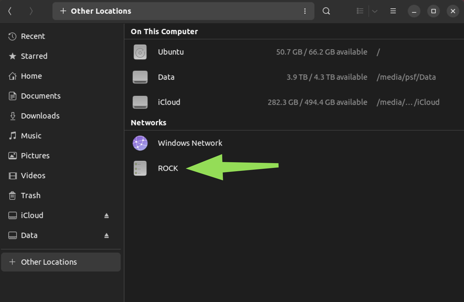

Of course you can access the path on the Nucleus from Linux, it’s just the SMB protocol, implemented by Samba on Linux, which is available in any Linux distribution. (The Roon OS on the Nucleus and ROCK is based on Linux, so …)
As usual, there are many ways on Linux. You can do it on the command line or in the graphical desktop environment that your Linux distribution uses.

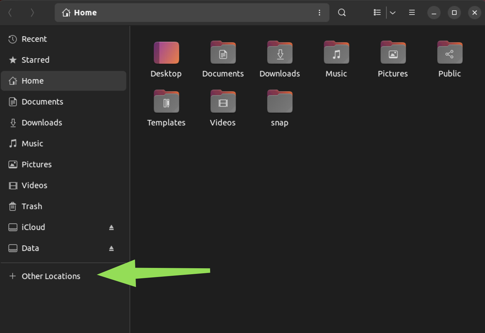

If you use Ubuntu or Fedora, the desktop environment is usually Gnome. There, you start the file manager and click Other Locations in the sidebar:

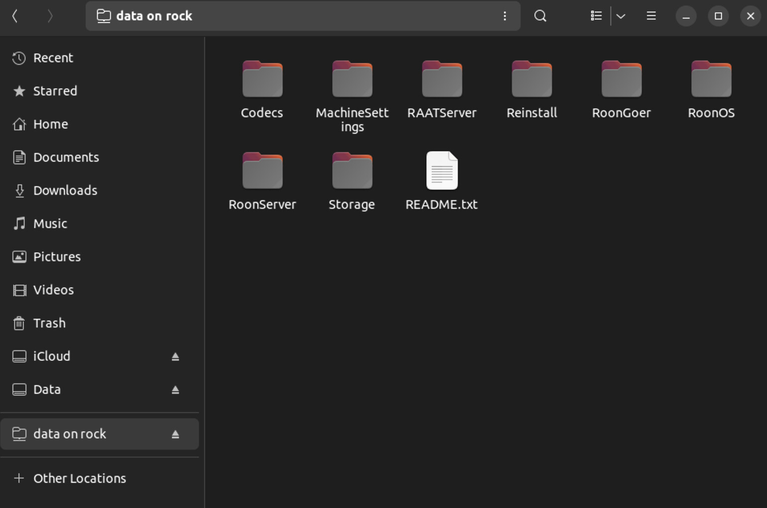

Double-click that and then go to Data. It will ask for username and password, enter guest/guest. You may have to choose “Registered User” first so that you can enter username/password. You can also choose to remember the password.
Then you will see the folders as described in the above link:

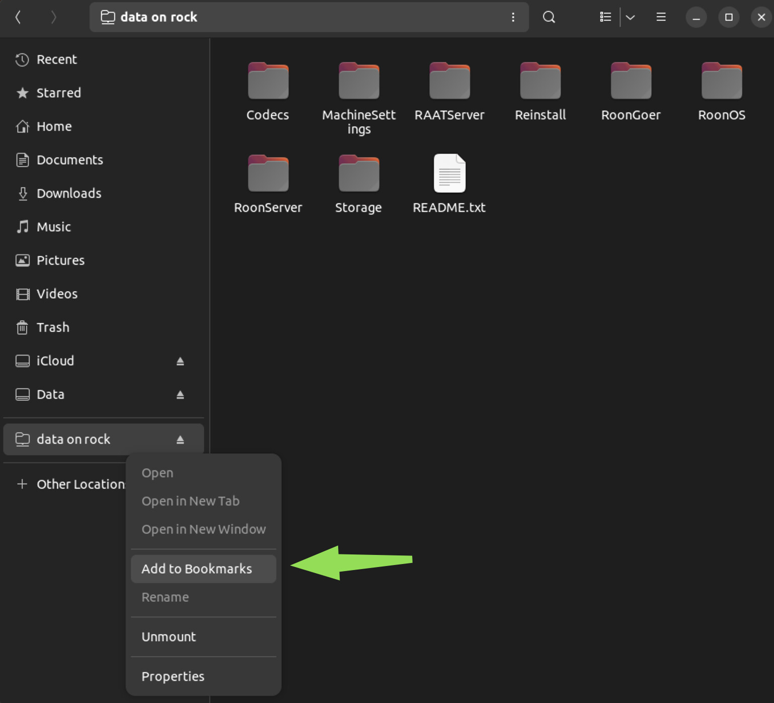

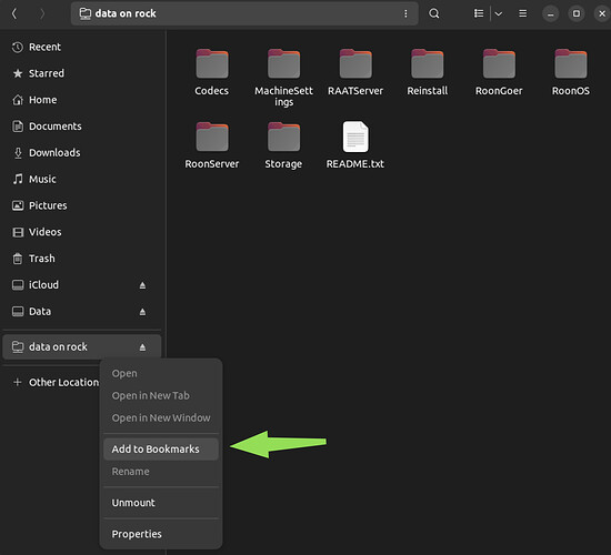

The Nucleus will appear as connected in the sidebar as well, you can rightclick this and add a bookmark, which will remain in the sidebar for later access:
Other distributions such as Manjaro, or what have you, will either use their own desktop, where it will work very similarly, or they use Gnome or KDE anyway
Hi Suedkiez, Thank you very much for taking the time to walk me through this. I managed to access the Nucleus by navigating to smb://xxx.xxx.x.x, where I got the IP address for the Nucleus from my router web pages. I was given the option to log in as Anonymous, which let me access the RoonServer folder.
