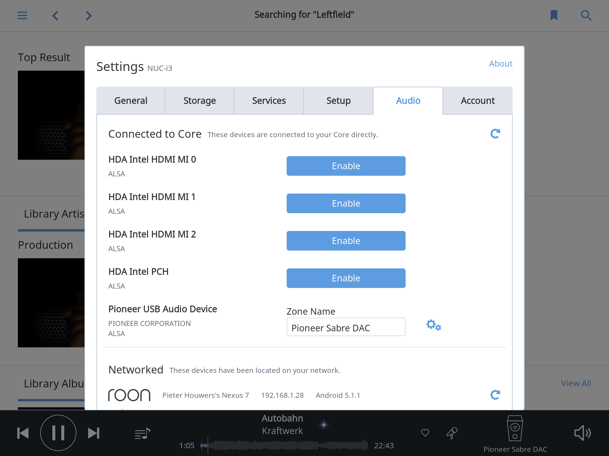

Hi Eric, sure:
When everything is working out wel (like now :- ) you’ll see this:

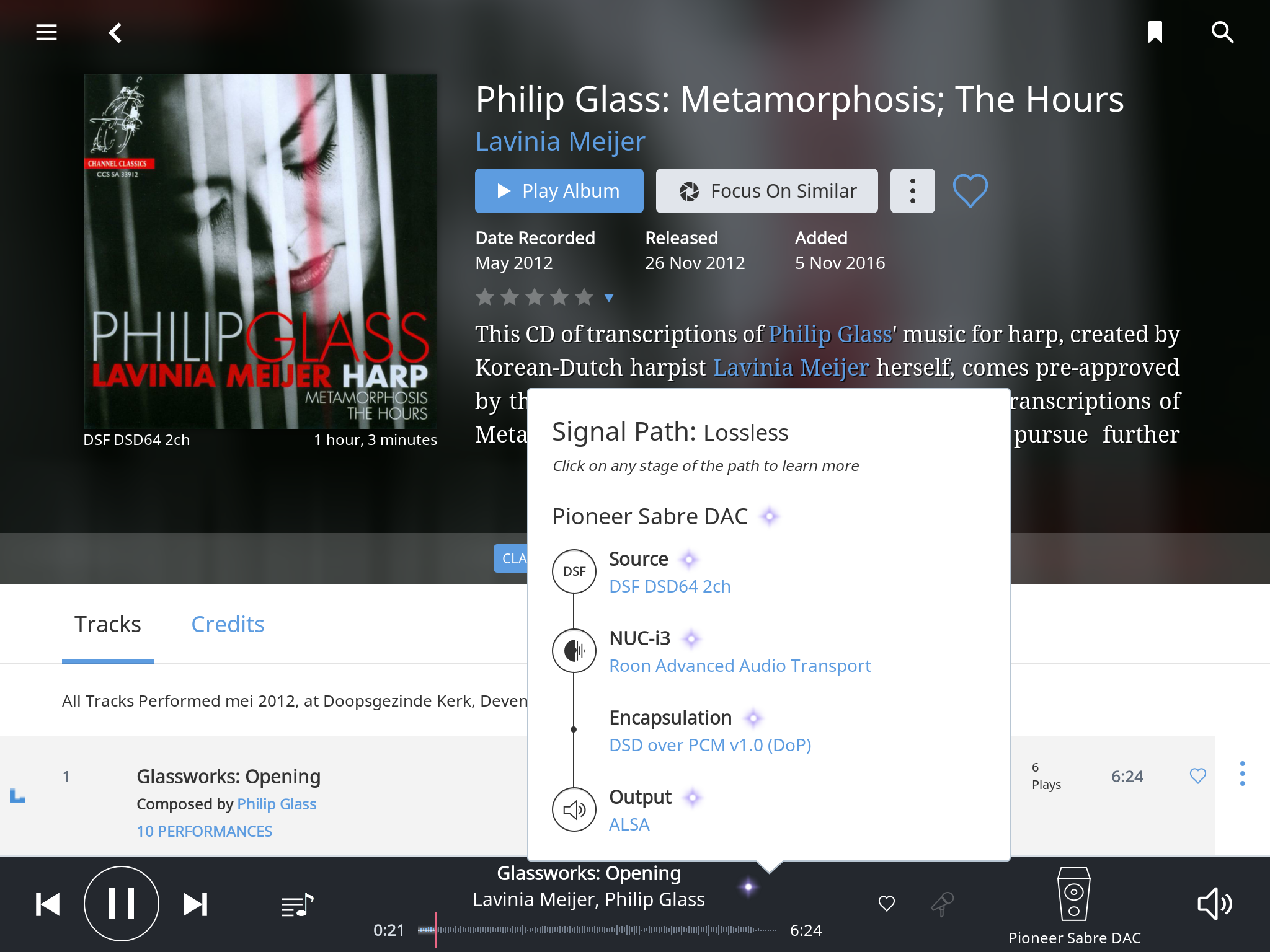

Feeding a DSD file to the DAC:
On the recieving side:
But most of the time…no sound

Hi @Pieter_Houwers ----- Thank you for the follow up and sharing the requested screenshots with me. Both are very appreciated :sunglasses:
