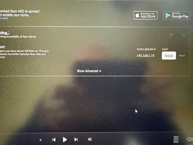

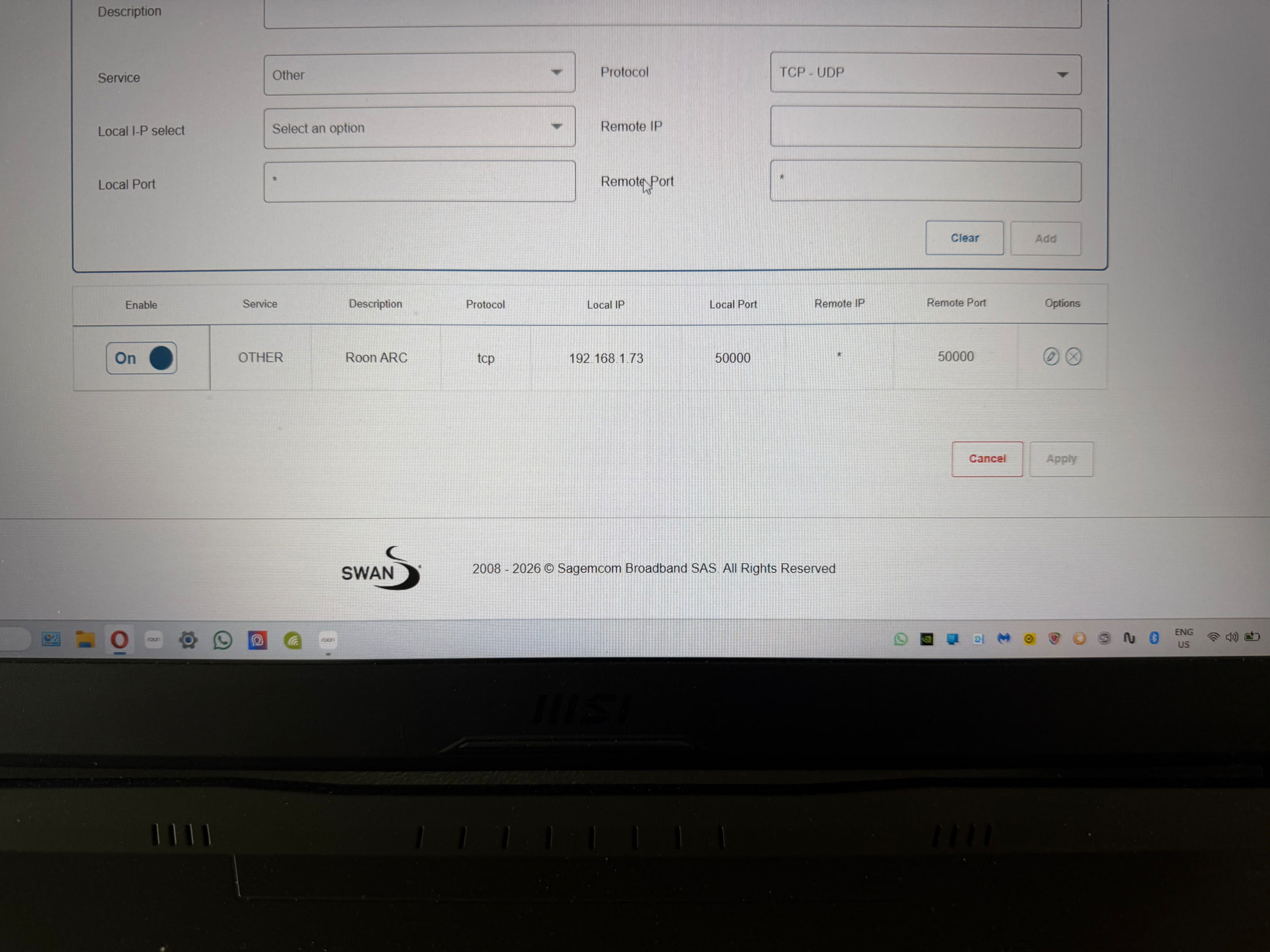

  1. Manual Rule Confirmation: Can you confirm that you’ve created a TCP rule in your Nokia router settings for port 55000 (or whichever port is shown in Roon Settings → Roon ARC), pointing to the local IP address of your Roon Server?
  2. Double NAT / CG-NAT: This is a very common cause of the 504 error.
  • Does your Nokia router connect directly to the internet wall socket, or is there another modem/gateway before it?

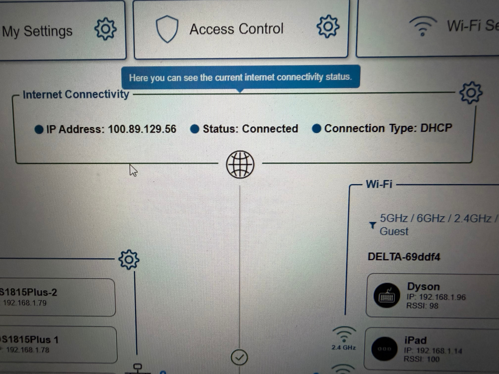

  • Provider Check: Have you checked with your Internet Service Provider (ISP) if they use CG-NAT? If they do, your router doesn’t have a public IP address, which makes standard port forwarding impossible. You might need to ask them for a Static/Public IP.
  1. Nokia Security: Do you have any “Advanced Security” or “Parental Controls” enabled in the Nokia WiFi app/interface? These often block incoming handshake requests from Roon.
As a quick test: Please try to change the port number in Roon Settings → Roon ARC to 50000, update your manual rule in the router to match, and see if the error code changes.

![IMG_1048|229x500](upload://A7bRQvGElvdUX3e6gNyJi3jVzml.jpeg) ![IMG_1049|229x500](upload://1yZQhXpfo3UdGv9ph1nVOXvR3oB.jpeg)
I send this before already

The best place to start with the error diagnostic you’ve shared is to try to set up a manual rule to forward the port in your router’s settings admin page.
This will usually be under a dedicated “port forwarding” or “NAT” tab. Please see here for precise details:
@gvanlokven based on the screenshot of the “Here you can see the current internet connectivity status“, it appears Roon Core is behind a Carrier Grade NAT so your ISP will not forward connections from the Internet into your home network. ARC needs port forwarding to work in order to go from your phone + ARC → cellular network → Internet → ISP → home router → Roon Core/Server.
There is a solution many Roon community members are using who are in a similar situation with CgNAT. Please see the information below.
This probably raises more questions and issues for you, but I hope having an option is helpful.
