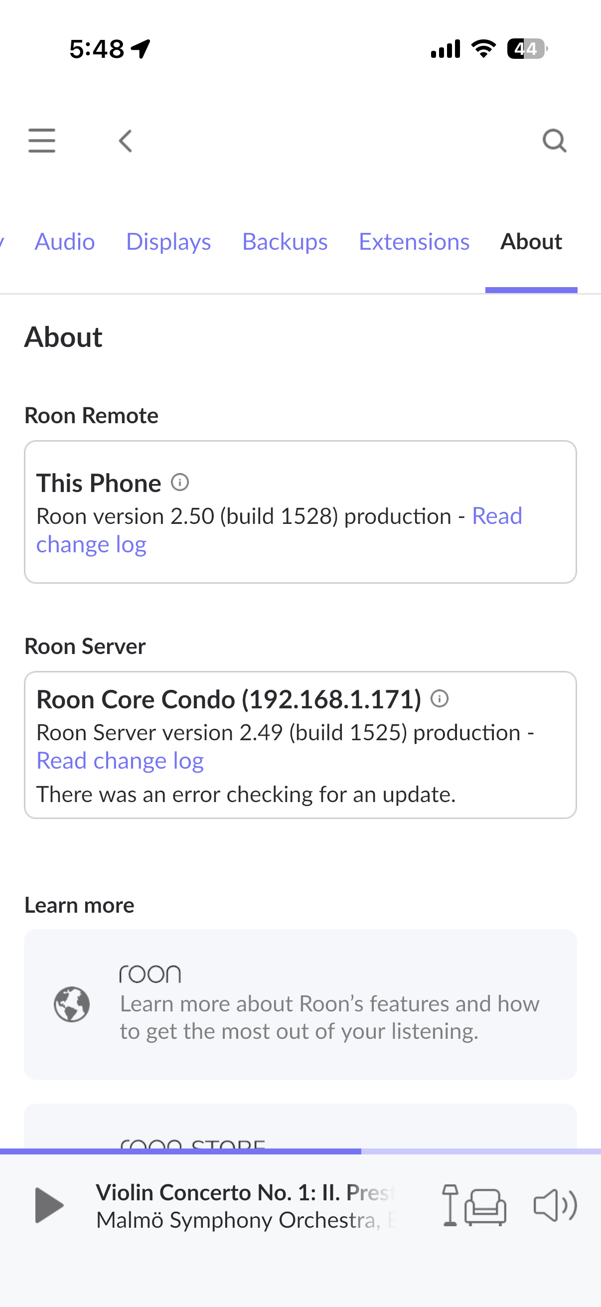

There was an error checking for the update
Velop mesh network with room server hard wired
Do you have a Static IP address for the core ? I experienced a similar issue, but changing back to DHCP resolved the issue. I have no idea why.
I use a Velop mesh that reserves the ip based on the MAC address. When I revert to DHCP, it still gives me the error.
Hello @Andrew_Lightman,
We went ahead and enabled diagnostic mode for your account. It seems that the downloaded update file is corrupted for some reason. Please delete all related Roon files from the /tmp/ folder and restart the Roon services to start the new download.

Thank you so much for your service. I backed up Roon and then reinstalled it from the Small Green Computer admin page. Then reinstalled the backup. All is good.
