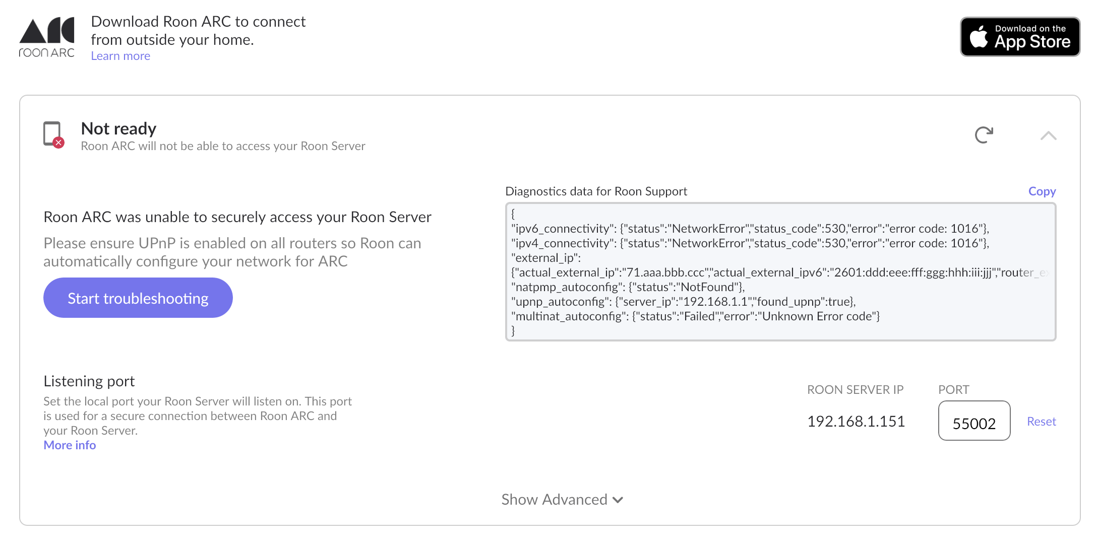

Here is the error message this morning (with different error code):slight_smile:
“ipv4_connectivity”: {“status”:“NetworkError”,“status_code”:530,“error”:“error code: 1016”},
“external_ip”: {“actual_external_ip”:“71.aaa.bbb.ccc”,“actual_external_ipv6”:“null”,“router_external_ip”:“null”},
“upnp_autoconfig”: {“server_ip”:“192.168.1.1”,“found_upnp”:true,“error”:“doaction request return statuscode: UnknownError”},
“multinat_autoconfig”: {“status”:“Failed”,“error”:“Unknown Error code”}
The ISP is xFinity and the modem is in bridge mode. XFinity verified that they do not have GCNAT enabled and my ip address would only be refreshed if they change our service or require a hard reset of the service.
I have reviewed the settings on the Ubiquity UCG router.
UPnP is enabled however IPv6 was not. I just changed that.
Still not ready for ARC.

I see the same going on at Cloudflare as I did see the last two days or so.
So why the believe it’s over? They seem to do just 5 - 6 sites a day, don’t know how many more sites (days) they to have go through until this is finally resolved.
Just for giggles, I just performed another full chain reboot… same problem:
“ipv6_connectivity”: {“status”:“NetworkError”,“status_code”:530,“error”:“error code: 1016”},
“external_ip”: {“actual_external_ip”:“71.aaa.bbb.ccc”,“actual_external_ipv6”:“2601:ddd:eee:fff:ggg:hhh:iii:jjj”,“router_external_ip”:“71.aaa.bbb.ccc”},
“upnp_autoconfig”: {“server_ip”:“192.168.1.1”,“found_upnp”:true},

I completely understand your frustration. Network configuration can be incredibly tedious, and it is totally valid to feel like packing the unit up when it doesn’t just work right out of the box.
However, before you go through the hassle of returning your Nucleus, I would love to ask you to try one last step: Manual Port Forwarding.
I just ran a check on our end, and port 55002 (which is the port your Roon ARC is currently configured to use) is completely closed. This confirms that UPnP (the setting that allows your router to open ports automatically) has failed to do its job. Your Ubiquiti or Xfinity firewall is simply blocking the connection.
Since automatic configuration failed, manual port forwarding is the standard, permanent fix for this exact situation.
