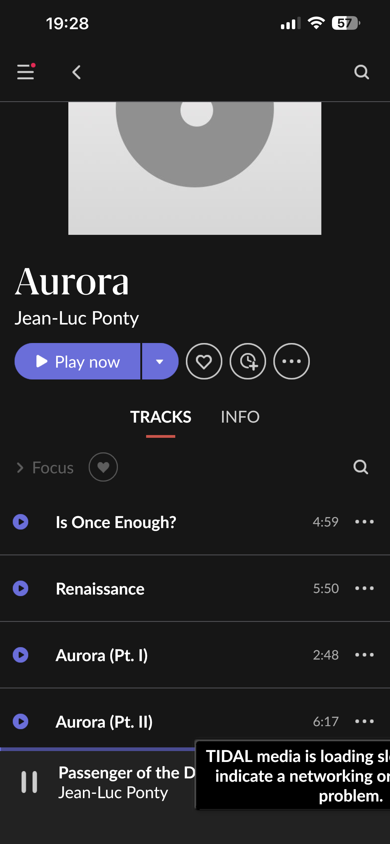

Even so, the issue continues to occur. Attached is a screen shot from when the issue just occurred.
Here are the details:
The issue occurred at 19:28CET on 05Dec2025 while streaming song „Passenger of the Dark“ by Artist „Jean-Luc Ponty“ on album „Aurora“.

Thanks for sharing the above timestamp and additional details! We can see the following errors when playback is attempted:
Trace: [PS Audio DirectStream DAC @ 192.168.50.242:56859] [raatclient] GOT [519] {"samples":20480,"status":"Dropout"}
Warn: [PS DirectStream] [zoneplayer/raat] Too many dropouts (>3s dropped out in the last 30s). Killing stream
Trace: [PS DirectStream] [zoneplayer/raat] too many dropouts. stopping stream
Warn: [zone PS DirectStream] Track Stopped Due to Slow Media

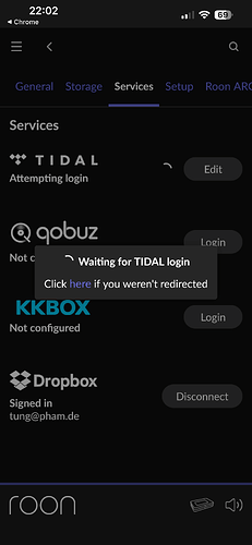

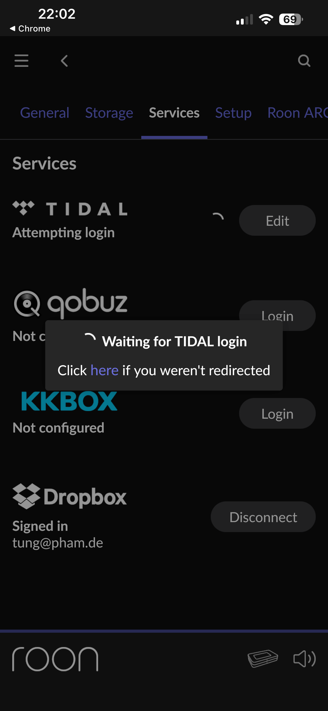

Hi Benjamin - here‘s another Tidal/Roon issue to add. I just had the same „loading slowly“ issue again this time on my bluesound Node. So I decided to restart my Modem and all my routers as sometimes this helps. After completing the restart, Ronn is now failing to even log in to Tidal - after several attempts, including clear cache and restarts in Roon and signing out of Tidal and signing in again. Just to be clear, I am streaming music directly from Tidal at the same time via the same network…

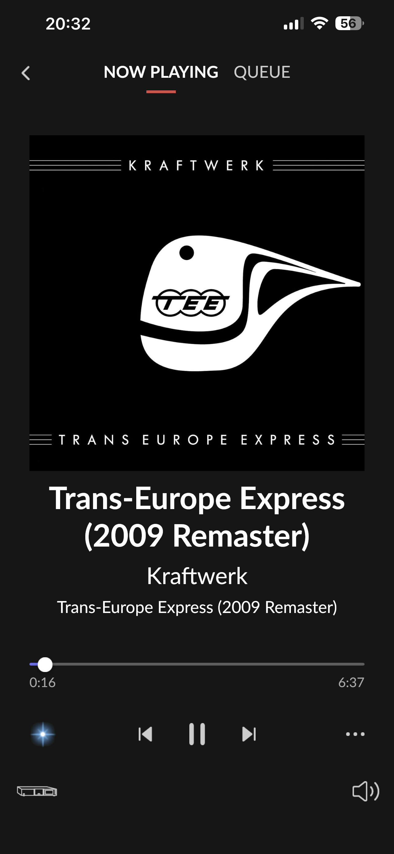

I do not use VPN. I will try to use one of those servers. Note I‘ve now also been experiencing the issue on my Naim ND5 XS2 which is connected via lan to the örimary router which in turn is connexted via lan to the modem - in this case I donMt get the „Tidal loading slowly“ message, the playback just stops**. Screenshot attached.
