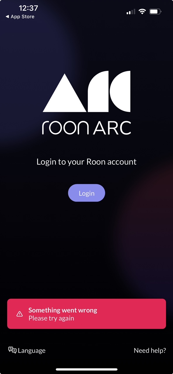

Uninstalled ARC and completed a hard reset on iPhone. Reinstalled ARC directed to login. Login initiated followed by error message, Something went wrong. Only a problem on one iPhone.

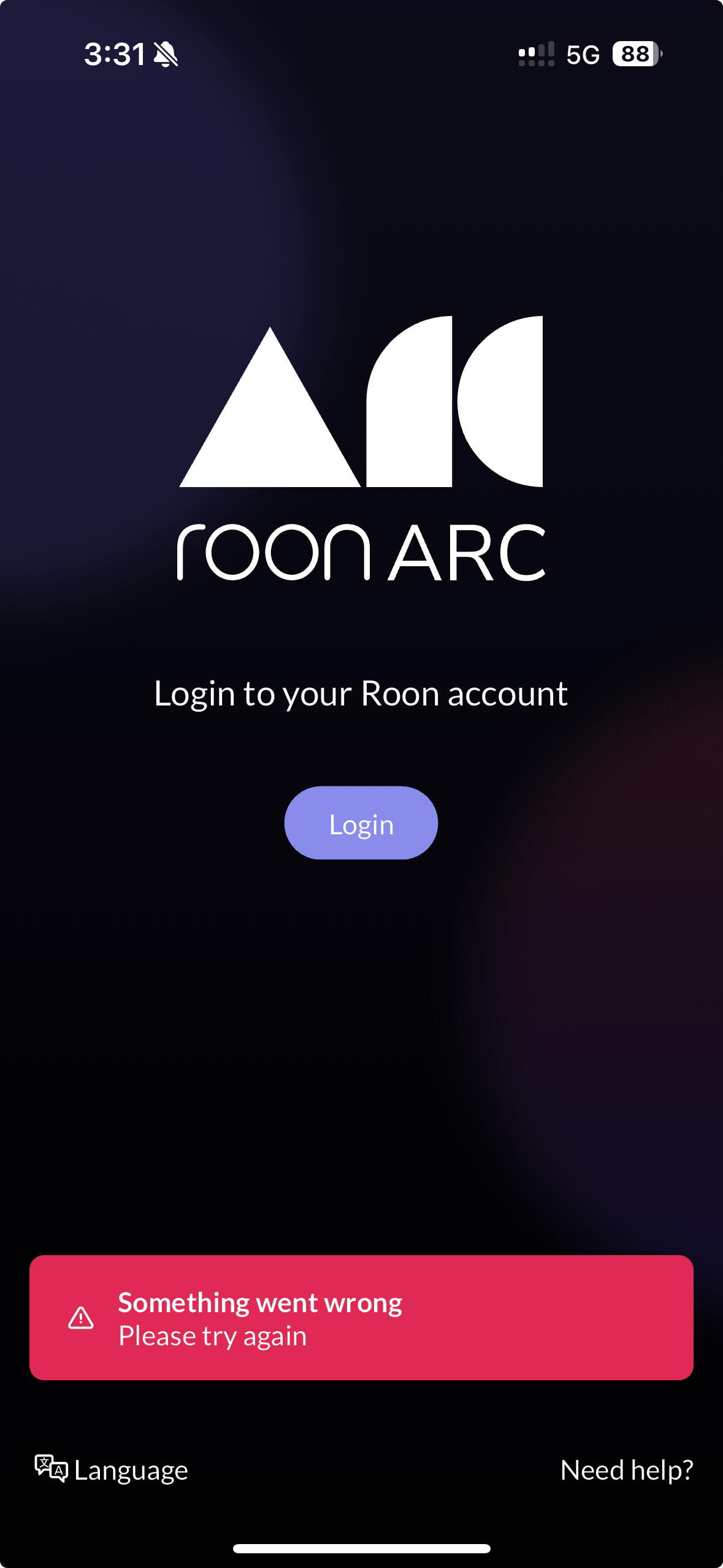

On my iPhone the browser in use to log in is Safari. I was able to verify it after cleaning up Safari's website data. And I tried signing in on both 4G/5G and WiFi. At the beginning I saw the same sign in screen as Roon's, but afterwards it was as if ARC couldn't render the signin token correctly, and always showed me this screen saying "Something went wrong".
I also tried signing in both by clicking logged in account and by providing my account name and password from the beginning. That didn't matter - I still got the "Something went wrong" error.

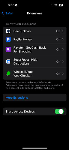

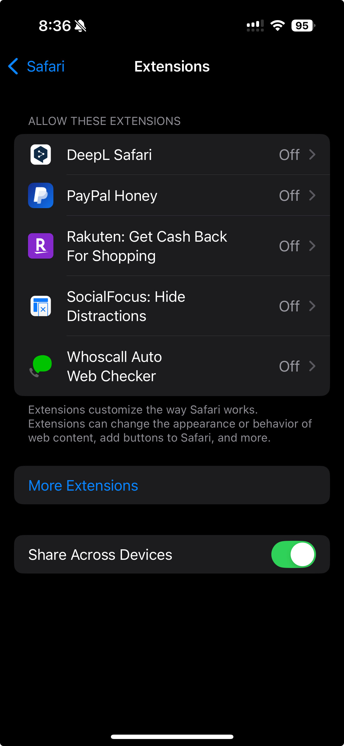

Hi @connor thanks for looking into this. I had all extensions disabled in all previous attempts but still couldn’t get past “Something went wrong”.

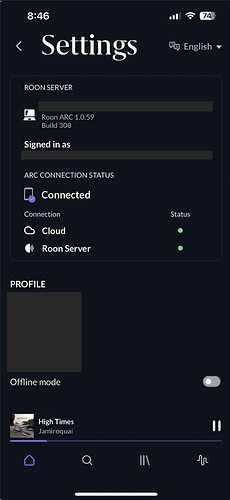

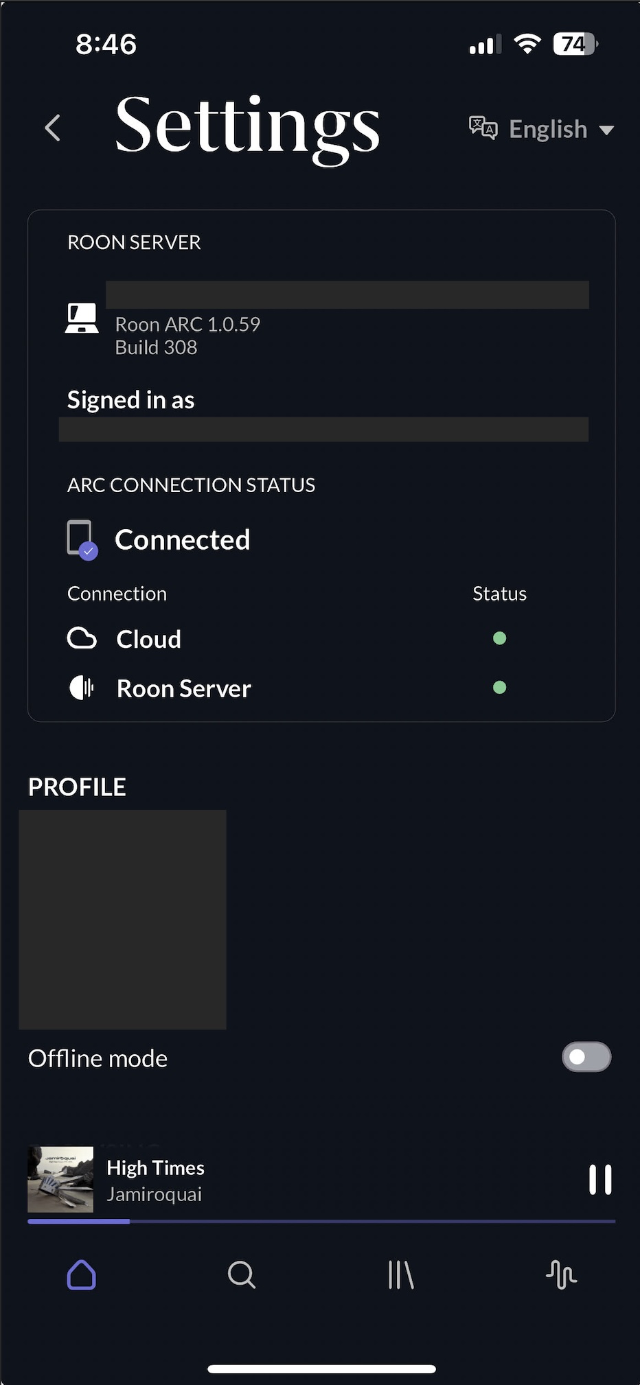

I got another odd data point. I have an iPhone for work with mandatory VPN (not Tailscale) on all the time. Yesterday I had it connected to my home WiFi, downloaded Roon ARC from App Store Japan, and tried to login. It actually let me do so and connect to my Roon Server, with VPN on the whole time.
This at least indicates that Roon Server can be connected, and the bottleneck is the login step on the client devices. But at this rate I also don’t have a clear idea of the right network/browser setting to make it work on my personal iPhone. I tried my personal iPad too and it failed to login the same way.
