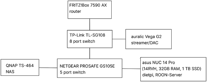

We can troubleshoot this issue by inspecting the network pathway between RoonServer and the Vega G2. However, we’d need to know the precise network topology involved.
does this help?
Hey @Achim_Weimer,
Thanks for the detailed graphic above! Are you able to temporarily bypass your switches and get a direct hardwire connection to your primary router and see if the same issues occur?
If they do, feel free to share the track name and we’ll take another look. Thank you! :raised_hands:

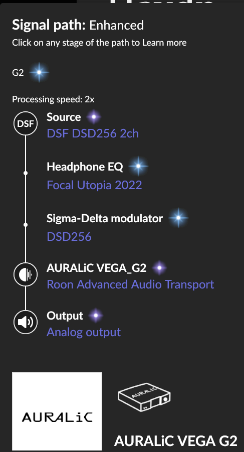

On the ROCK, we see the processing speed dropping below 1.0x in other cases during DSD256 distribution and playback:
02/19 16:18:05 Trace: [RaatSender] [G2] [Enhanced 0.8x, DSD256 DSF => DSD256] [100% buf] [PLAYING @ 0:00] Sonata in D Major, HWV 371 Op. 1, No. 13: III. Largo - Rachel Podger / Brecon Baroque / George Frideric Handel
At other times during DSD256 distribution and playback, the processing speed hovers between 1.0 and 2.0x.
The managed switch and any network settings are likely irrelevant here. The limiting factor is the ROCK’s computational processing ability with this massive format.
We don’t have verbose logging on the DietPi due to the logging errors referenced above, but you can check to see if the processing speed is dropping below 1.0x on that machine by opening Signal Path.
