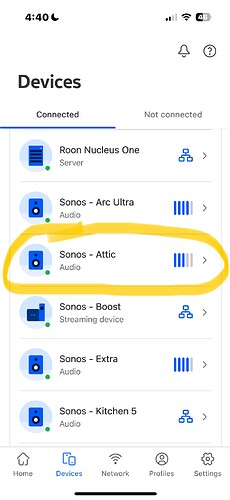

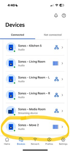

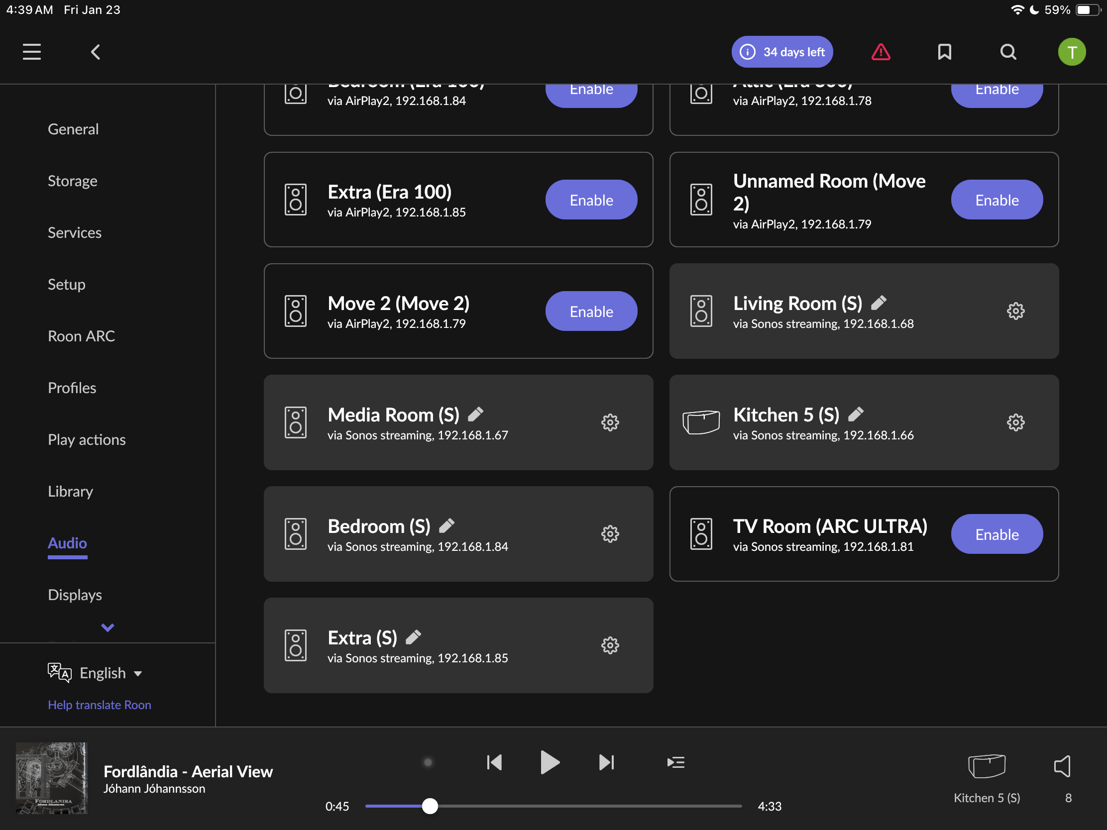

Well, I did try to hard wire a couple of my Sonos devices, notably the “Media Room” Port and my “Living Room” stereo Play 5’s, but sadly the results were disappointing. I lost control of almost everything on the system. I ran one ethernet cable from my router down to the port and daisy chained that to my Play 5 - according to Sonos, the two ethernet ports on the Sonos port act as a switch. Concerning switches, I have none on my network. After removing the ethernet connections, I was able to re-establish most of the Sonos system besides an anomaly. Sonos (and my router) shows both the “Attic” speaker and “Move 2” being available, and they will play under Sonos control, yet they do not show up in my Roon Nucleus “audio” settings using Sonos streaming even though they appear as available via AirPlay2.
Please note that I did a factory reset on the Move 2 in order to see if it would alleviate the issue of Roon not seeing it as being available to stream via Sonos protocol. The Move 2 does however show up twice in the AirPlay2 protocol even though the IP addresses are the same.

Regarding the missing Move 2 / Attic:
Since you performed a factory reset and made network changes, Roon likely holds a “stale” device ID in its cache, which explains the duplicates you are seeing in AirPlay.
To fix this, please restart the Roon Server software itself (not just the remote app on your phone). You can do this via the Nucleus web interface. This usually clears the cache and forces Roon to rediscover the new IDs of the reset speakers.

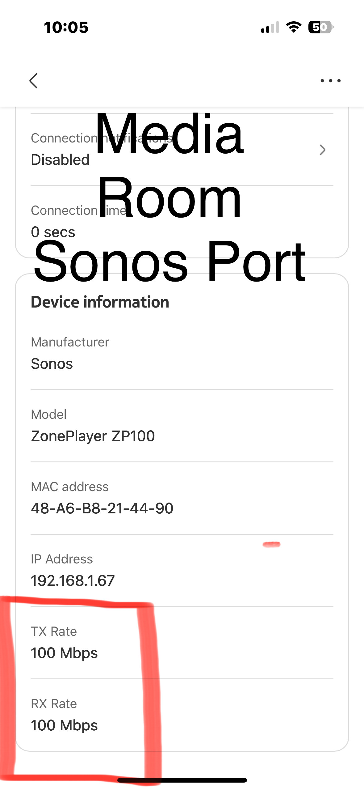

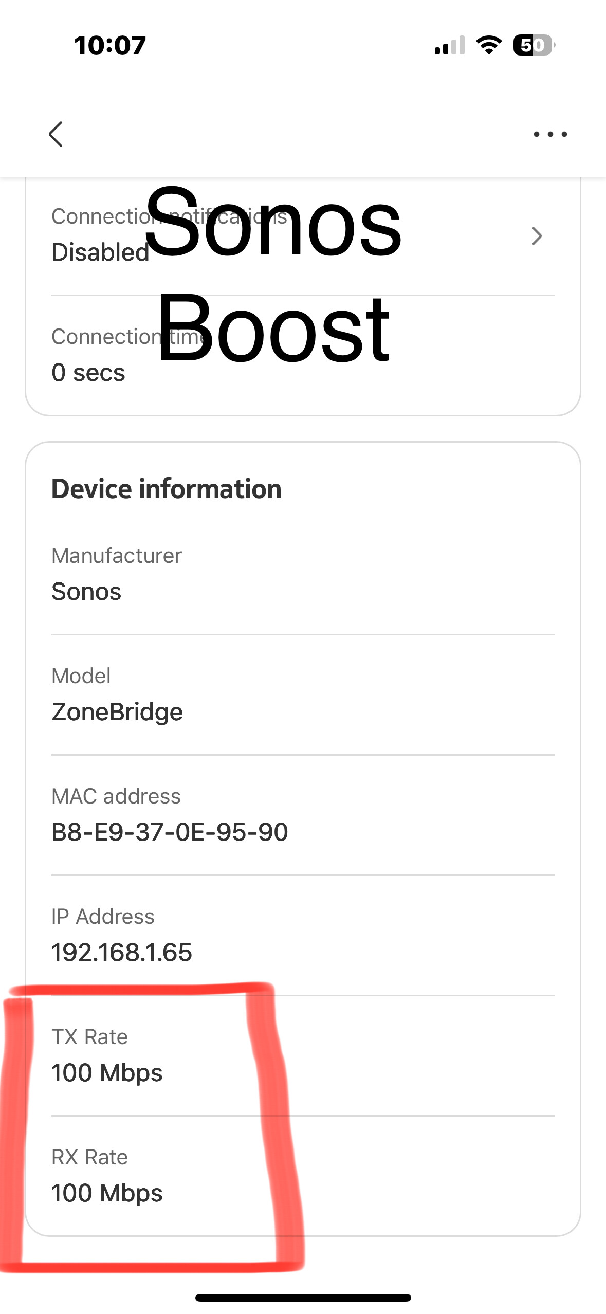

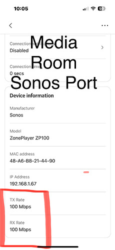

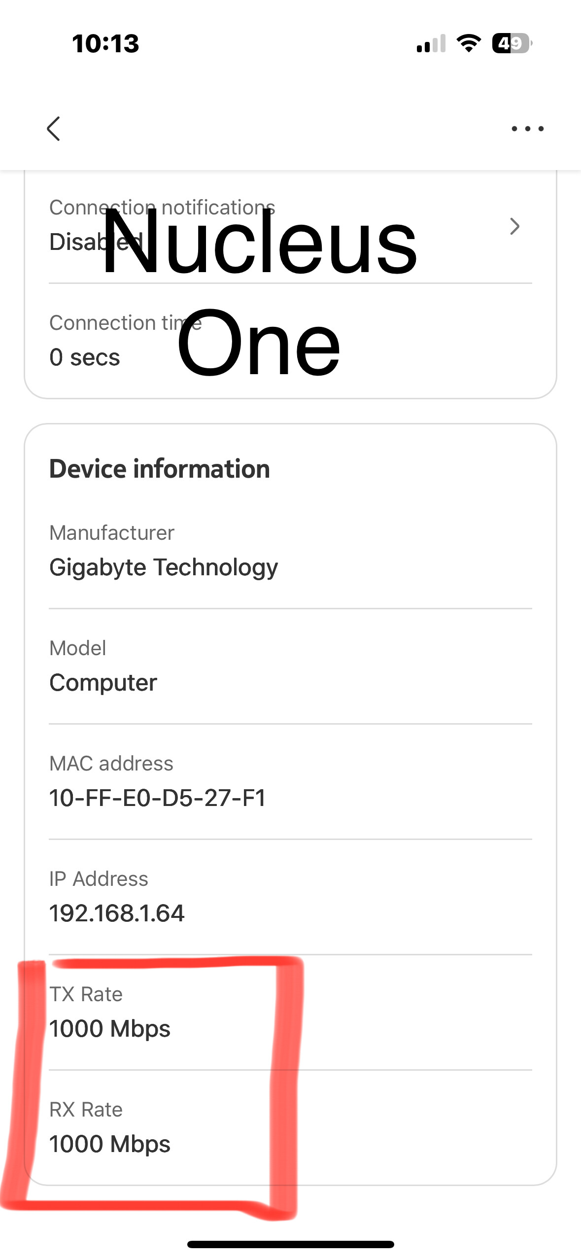

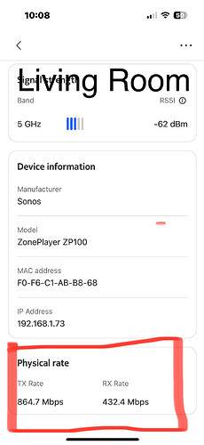

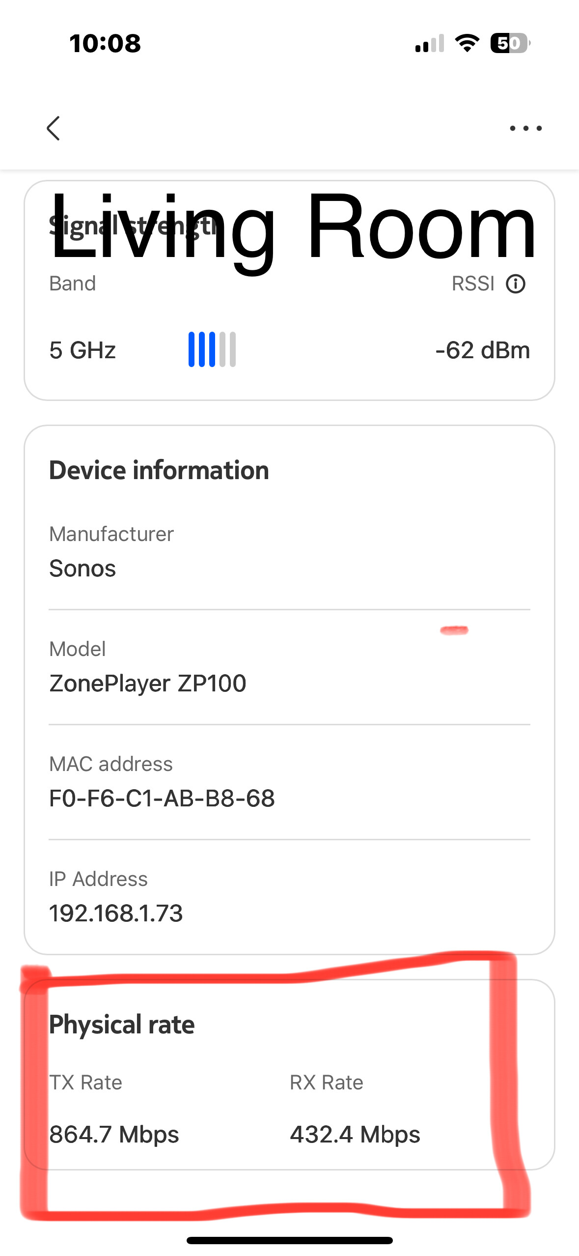

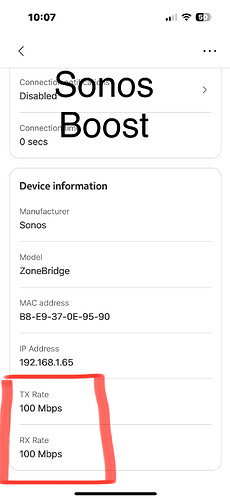

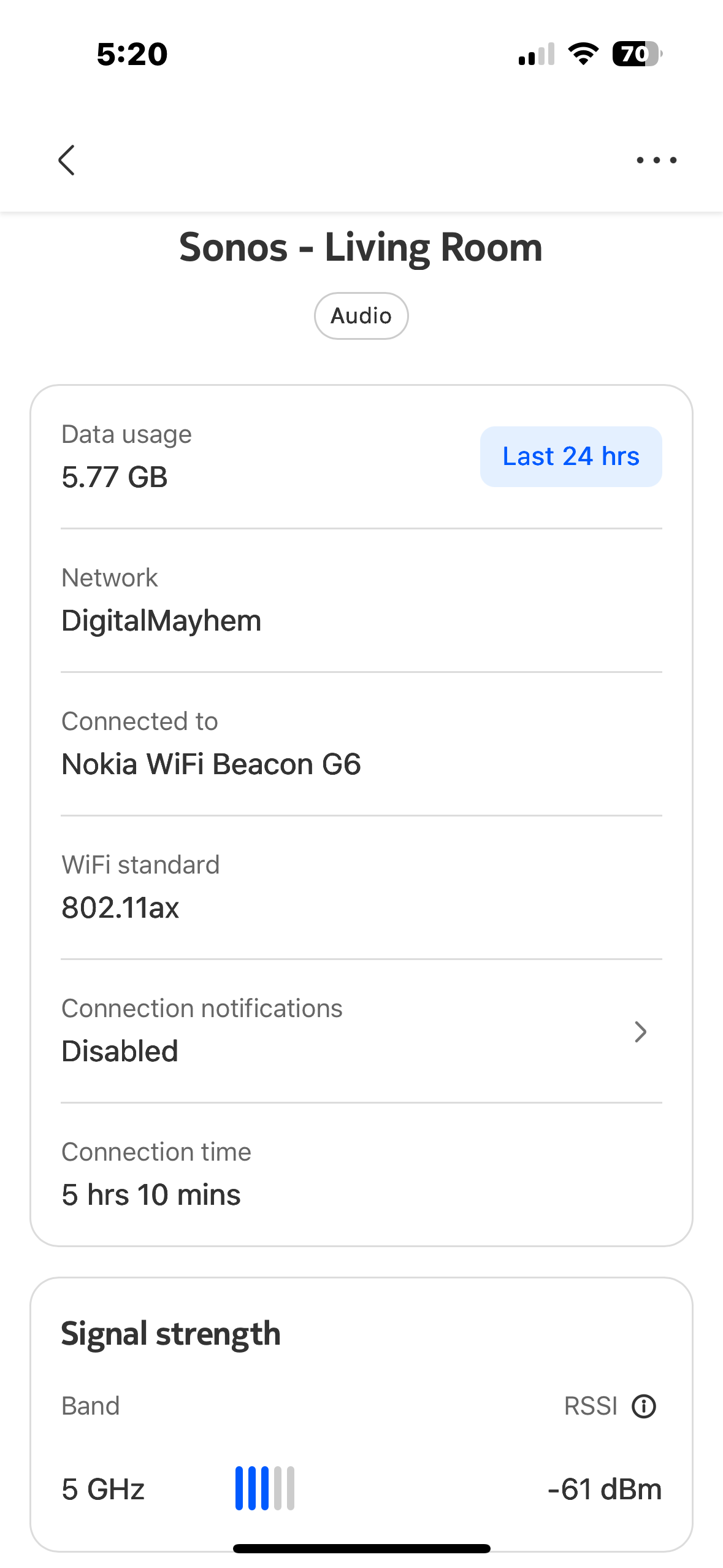

I took some screen shots of various devices on my network, and would like to know from the perspective of how Roon transmits data if there could be a potential issue in the TX and RX Rates shown:
@benjamin marked his post as the solution because you said that it had cleared up those issues:
I have removed the solution checkmark on his post to re-open this thread. Perhaps you could clarify what precisely the ongoing issue is?
Regarding the TX and RX speeds that you posted, they are not the issue.

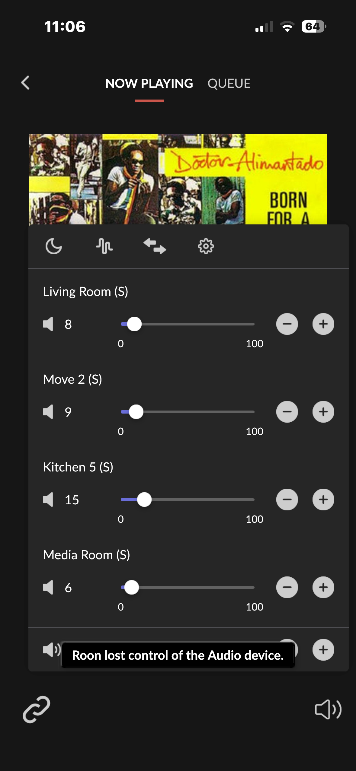

The ongoing issue is that I am still receiving multiple “Roon has lost control of the audio device” messages as the system stops playing my selected music through my Sonos system.
