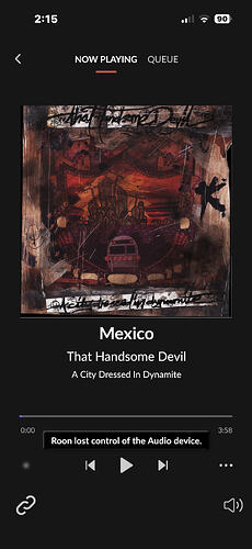

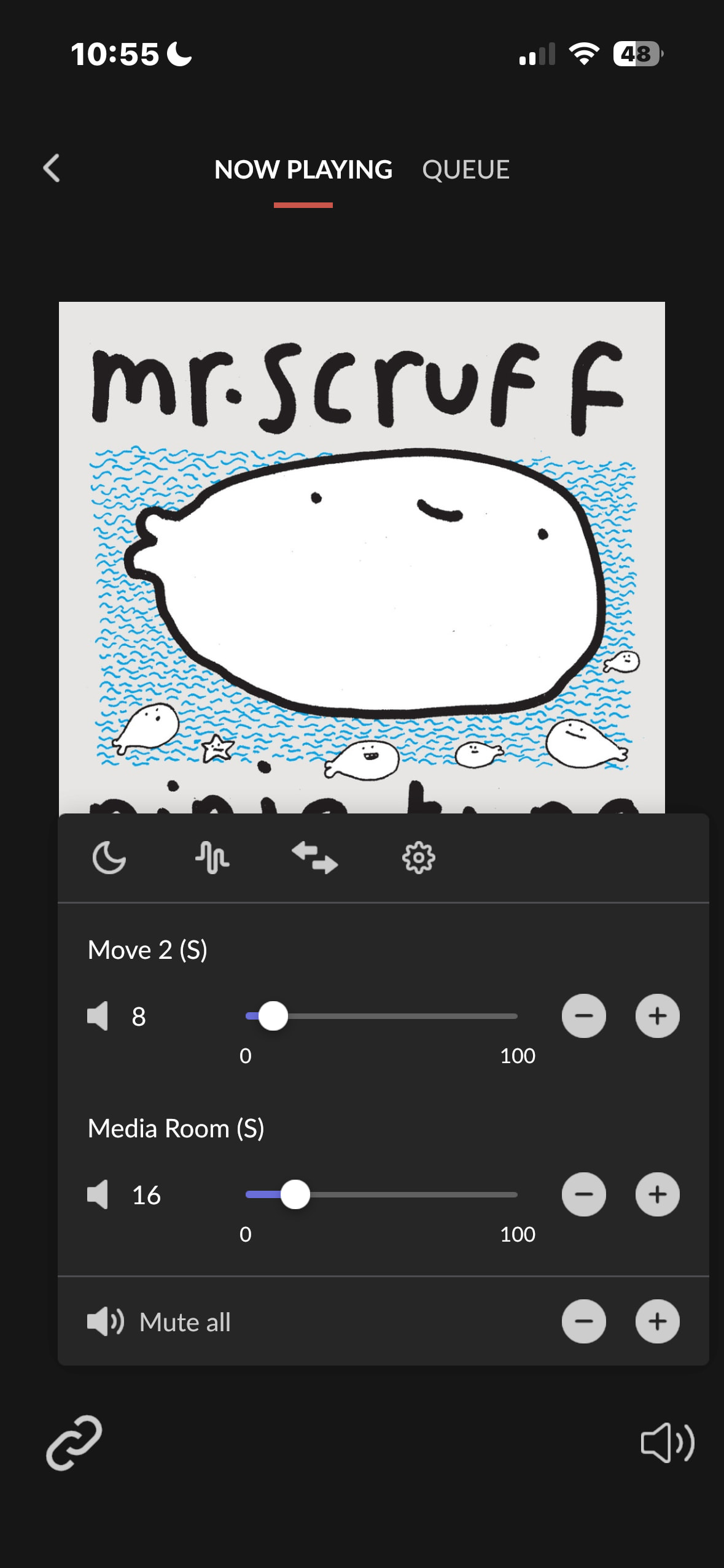

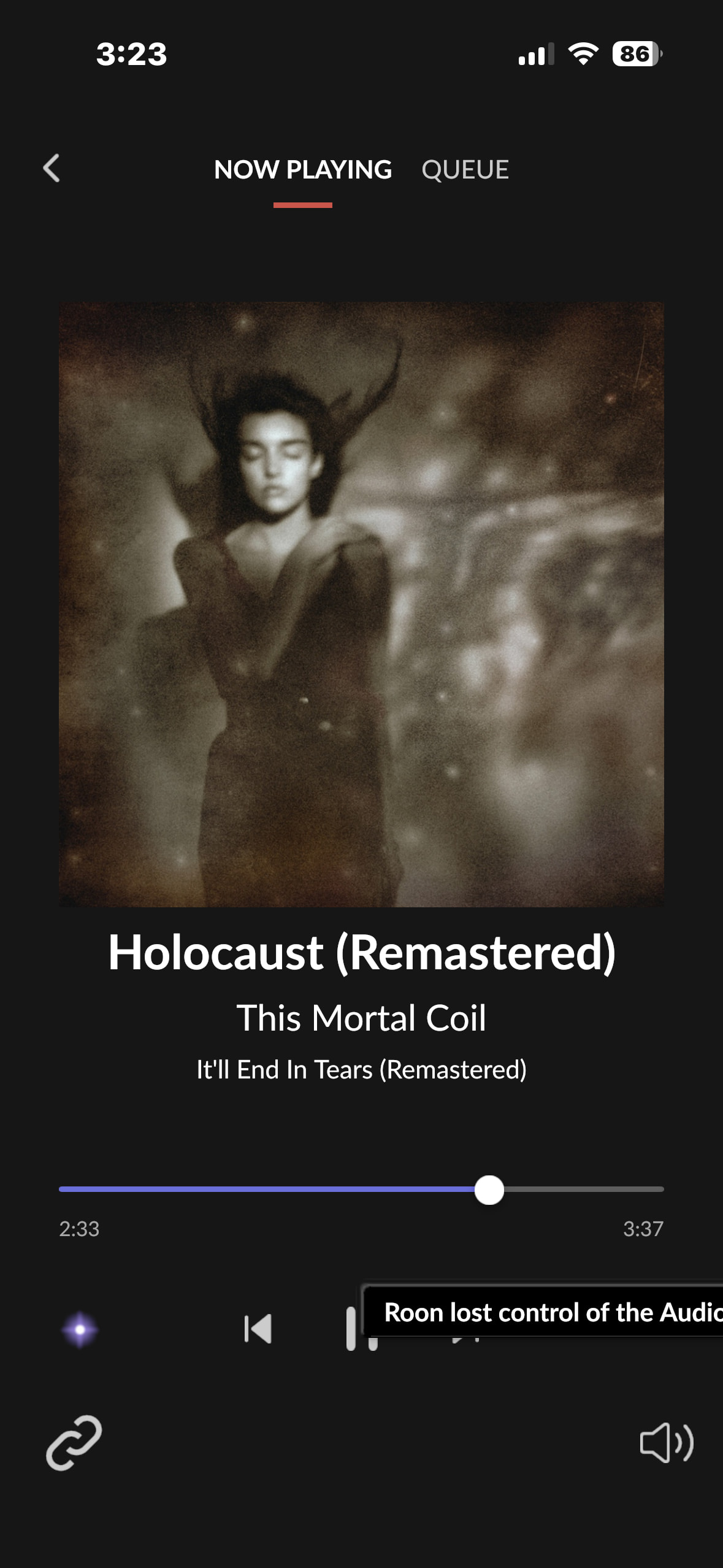

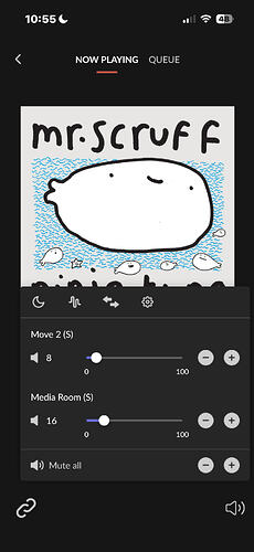

As I was typing the above reply, by Roon grouping of Move 2, Media Room and Kitchen started to experience dropouts, and then Roon lost control of the Kitchen speaker:

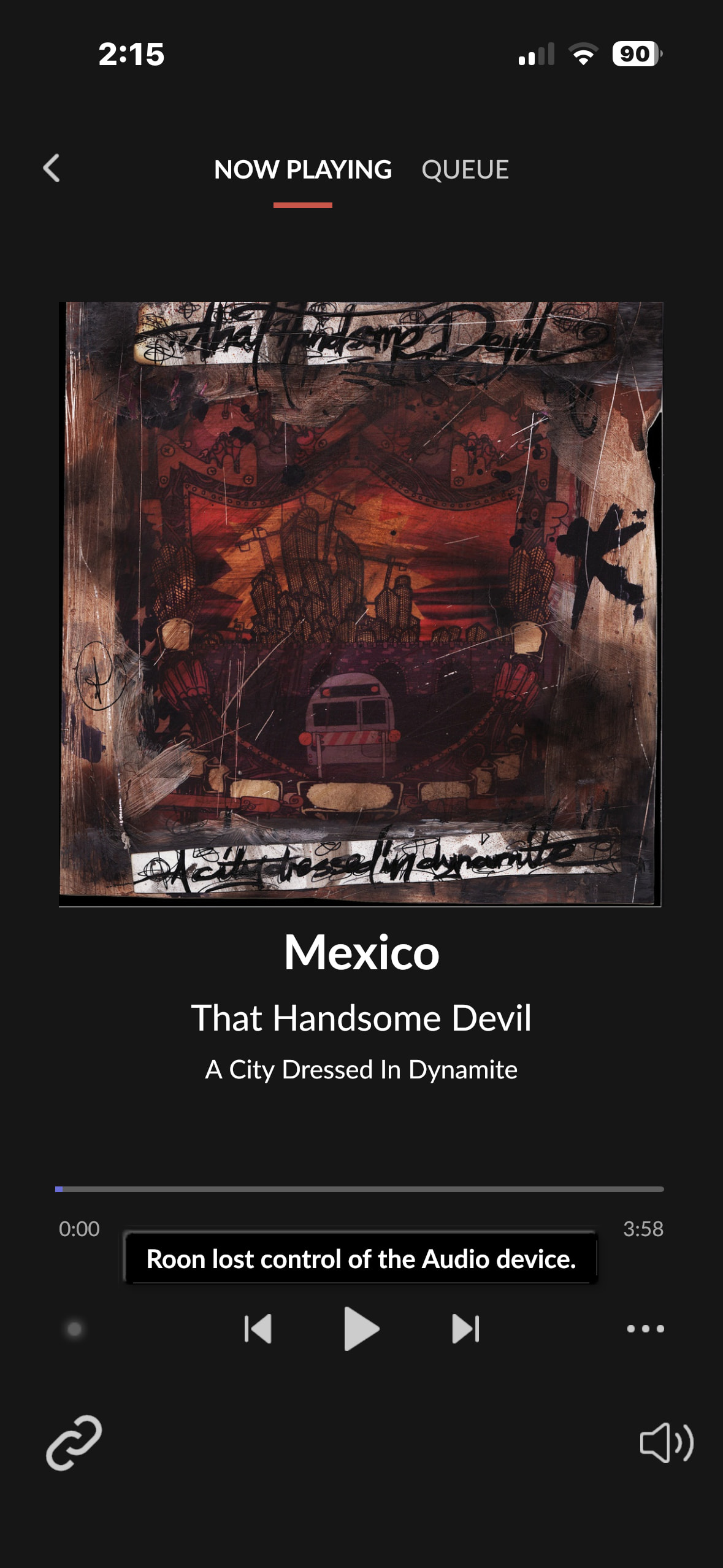

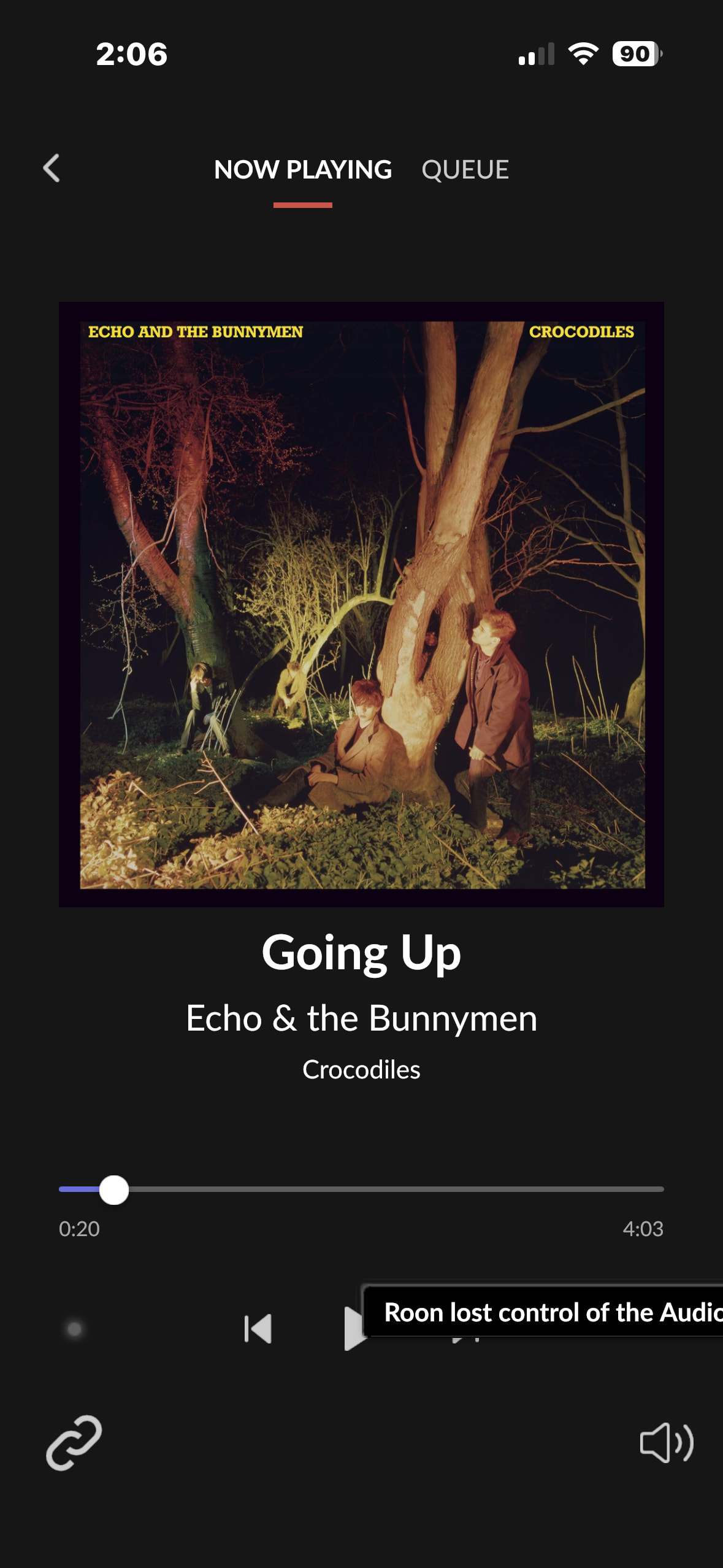

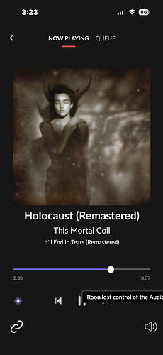

Here are a few more “Roon lost control” issues:
Wednesday, April 22nd, 2:06pm EST
Wednesday, April 22nd, 2:15pm EST:
Thursday, April 23rd, 3:23pm, EST:
I hope this helps in the troubleshooting.

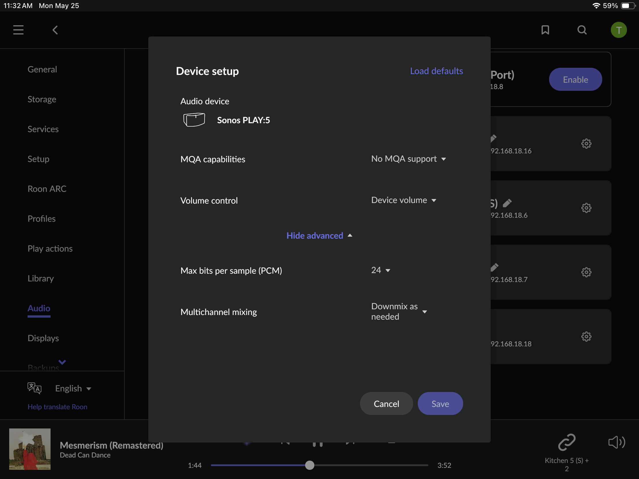

  • In Roon Settings → Audio → (each Sonos zone) → Device Setup, look for a buffer size setting and increase it if available. More buffer = more tolerance for transient bandwidth dips.

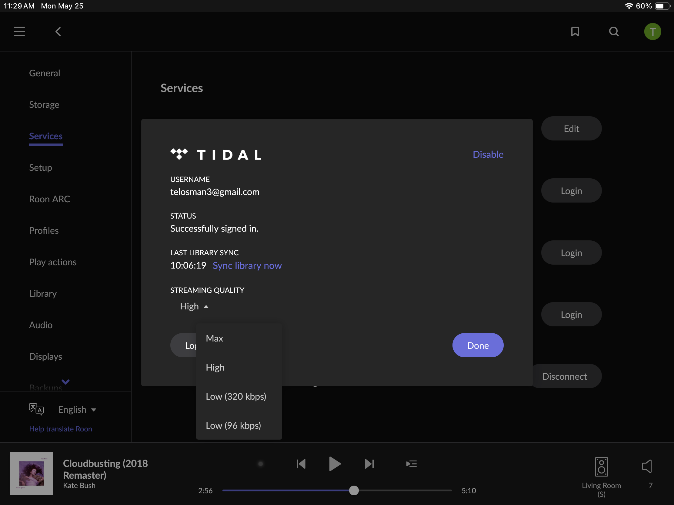

  • Consider switching TIDAL quality to High (AAC 320) rather than HiFi/Max for grouped zones — the required bandwidth is much lower, which eliminates most of the poor-connection warnings entirely. You can keep Max for single-zone critical listening.

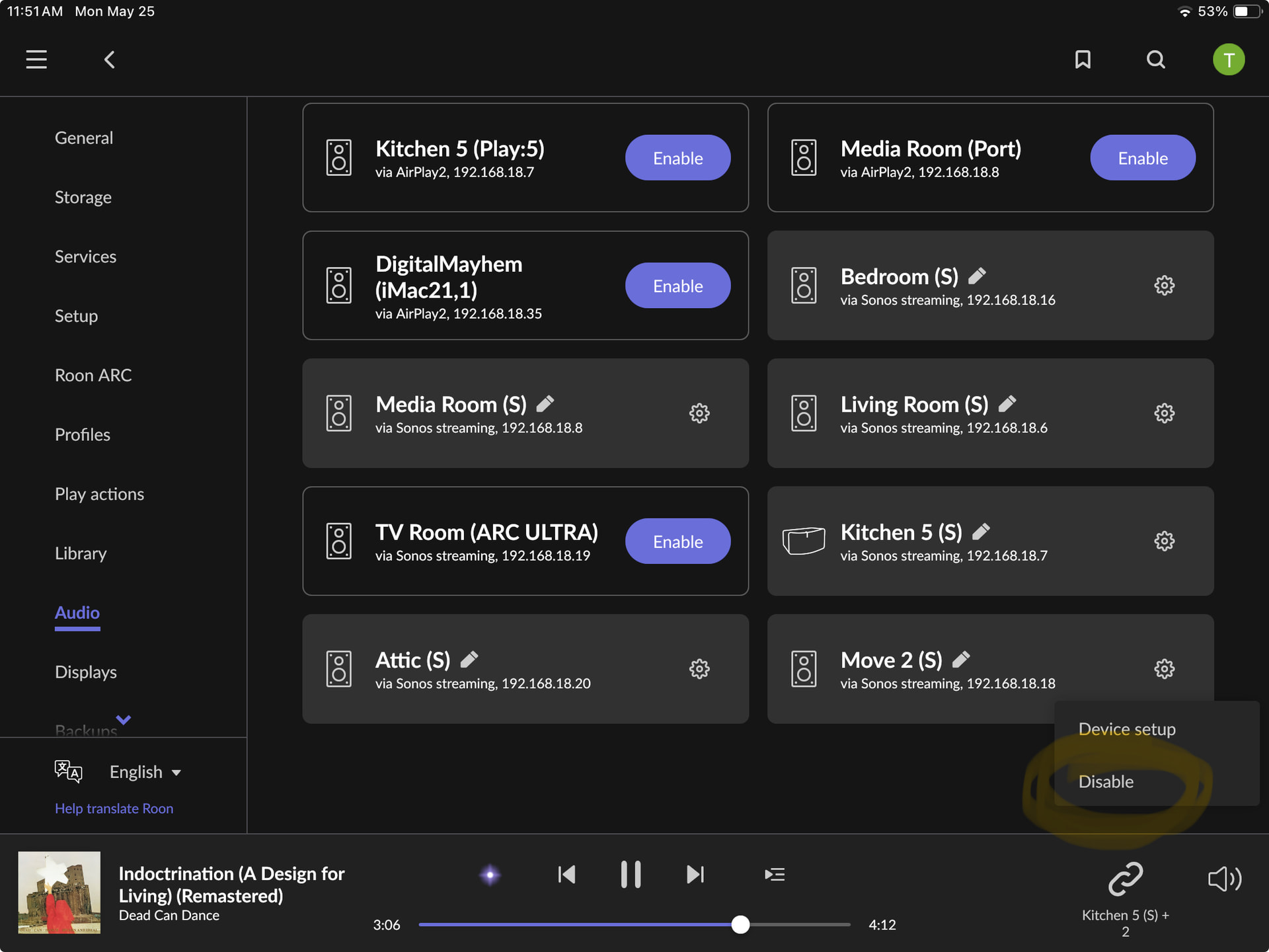

When you mention “removing” the Move 2 in the Roon app, do you mean using the “disable” function under the “Audio” tab in the Roon Settings, then enabling it again? I have done that, but not noticing any perceived differences as of yet.
Within the Roon Settings / Audio / (each Sonos zone) / Device Setup, there is no option to change buffer size.
I have switched the Tidal quality from “Max” to “High” as of last evening, so do not have enough listening time to discern if there is an improvement. I do not see how the keep “Max” for a single zone setup as it seems like a universal setting. Please advise how I can separate it as you suggest.
