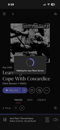

I’ve had a message that has started to pop up quite frequently on my Roon apps:
Could you kindly explain its meaning as I have not made any Schengen’s within my settings. This seems to have started after an update, but I cannot be one hundred percent sure.

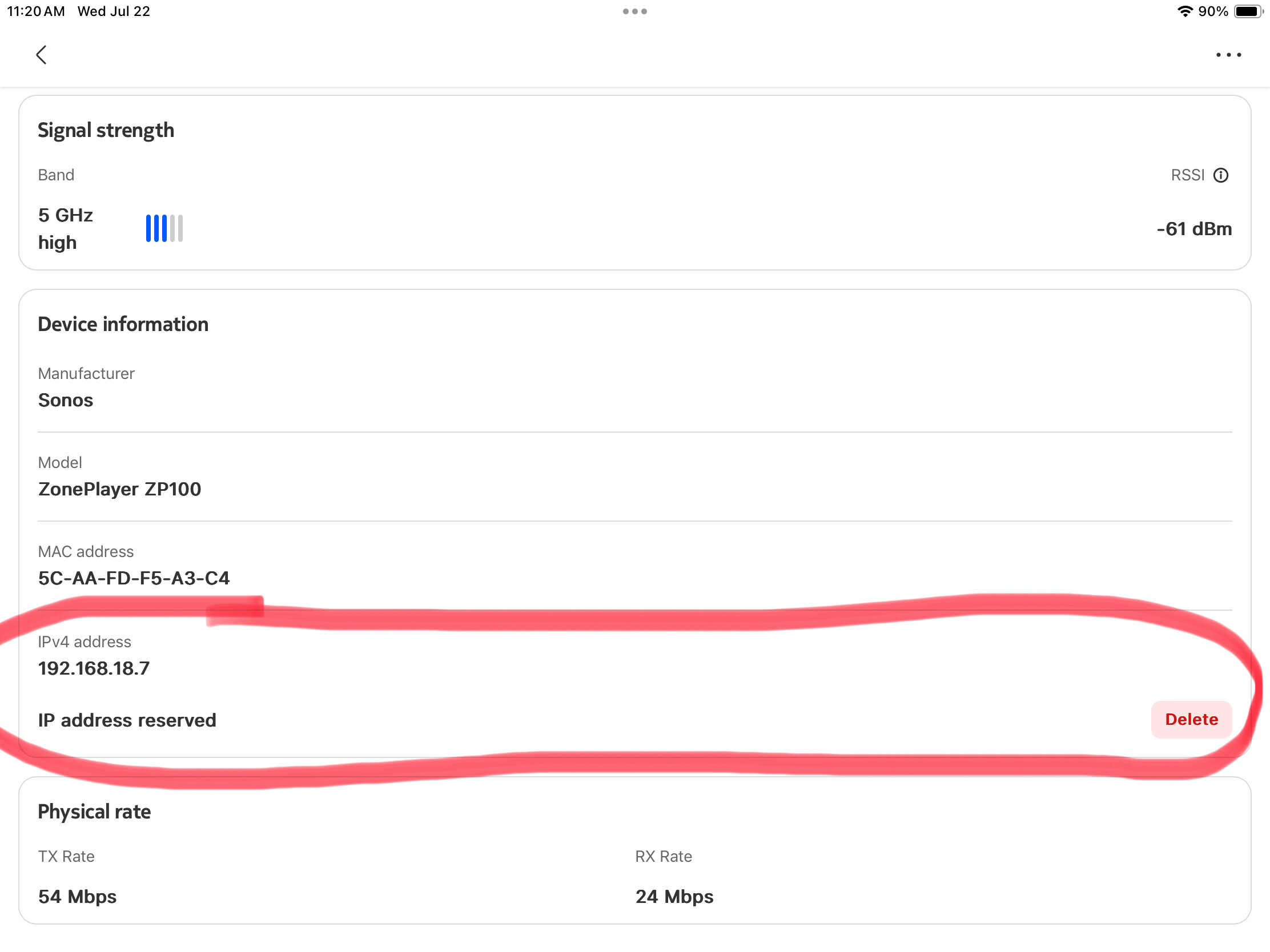

  1. Set DHCP reservations (static IPs) for everything, the Nucleus, every Sonos, and every device you use as a Roon remote, in your Nokia router. This should be the single biggest improvement, because it stops the address-shuffling that's breaking control.

If I have it correct, my system now has static IP addresses for all devices associated with Roon - please confirm with the screenshot below. I have also removed the old Kitchen Play 5 from Tanya grouping as per your request - a bit of a shame that the older unit can not be updated to run smoother. I will be trying a grouping of the Media Room, Living Room and Move 2 to see how stable that can be, as that is a grouping I’d prefer to have playing, but have avoided as we have been going through this. When I get a chance to hardwire one of the Living Room Play 5’s, I will inform you.
I’m not sure if I mentioned this in the past, but my Nokia router is a rental from my service provider and I know some settings are “locked out” when they program the routers before sending to customers. Having said that, I have not been able to locate any option concerning band steering or smart connect, but will look further.

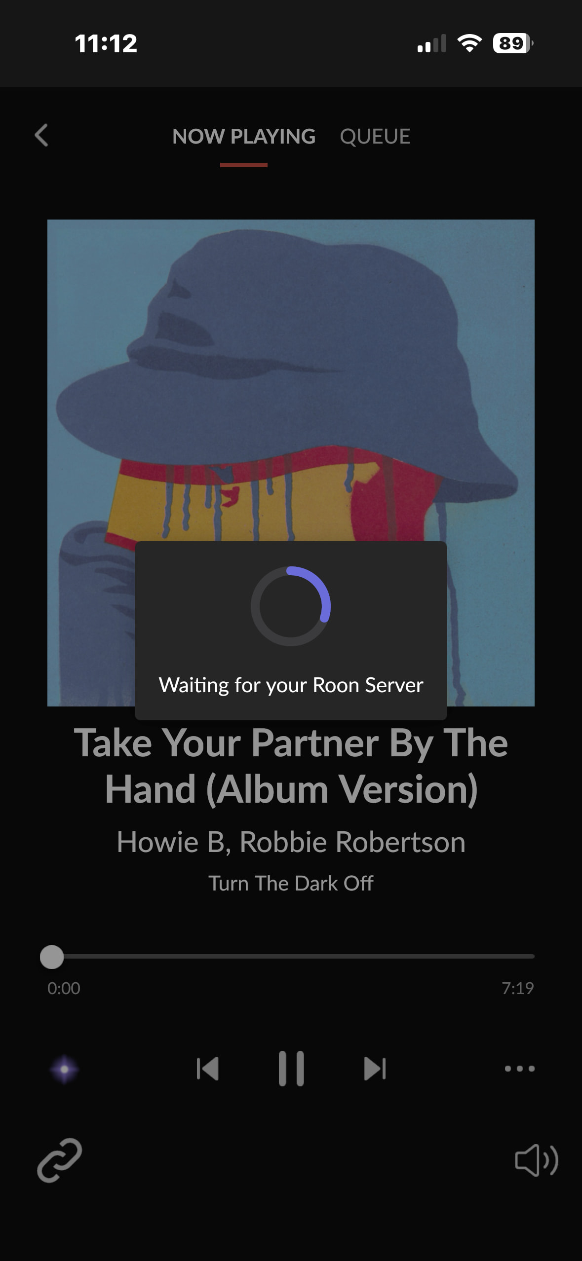

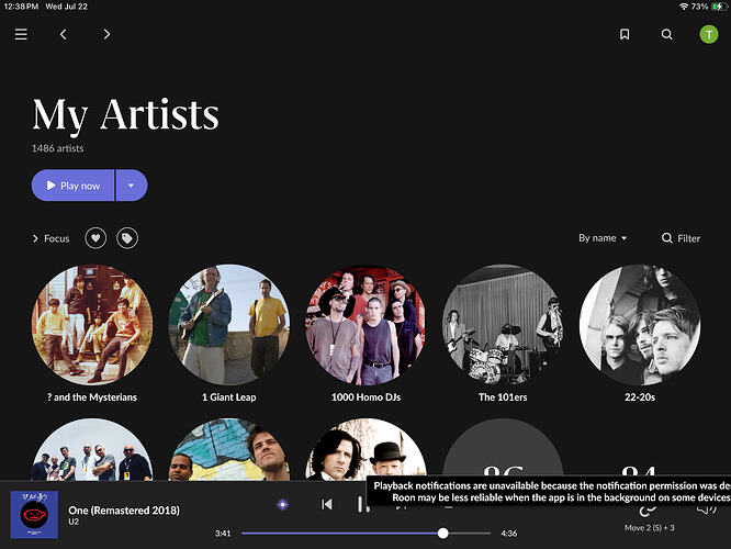

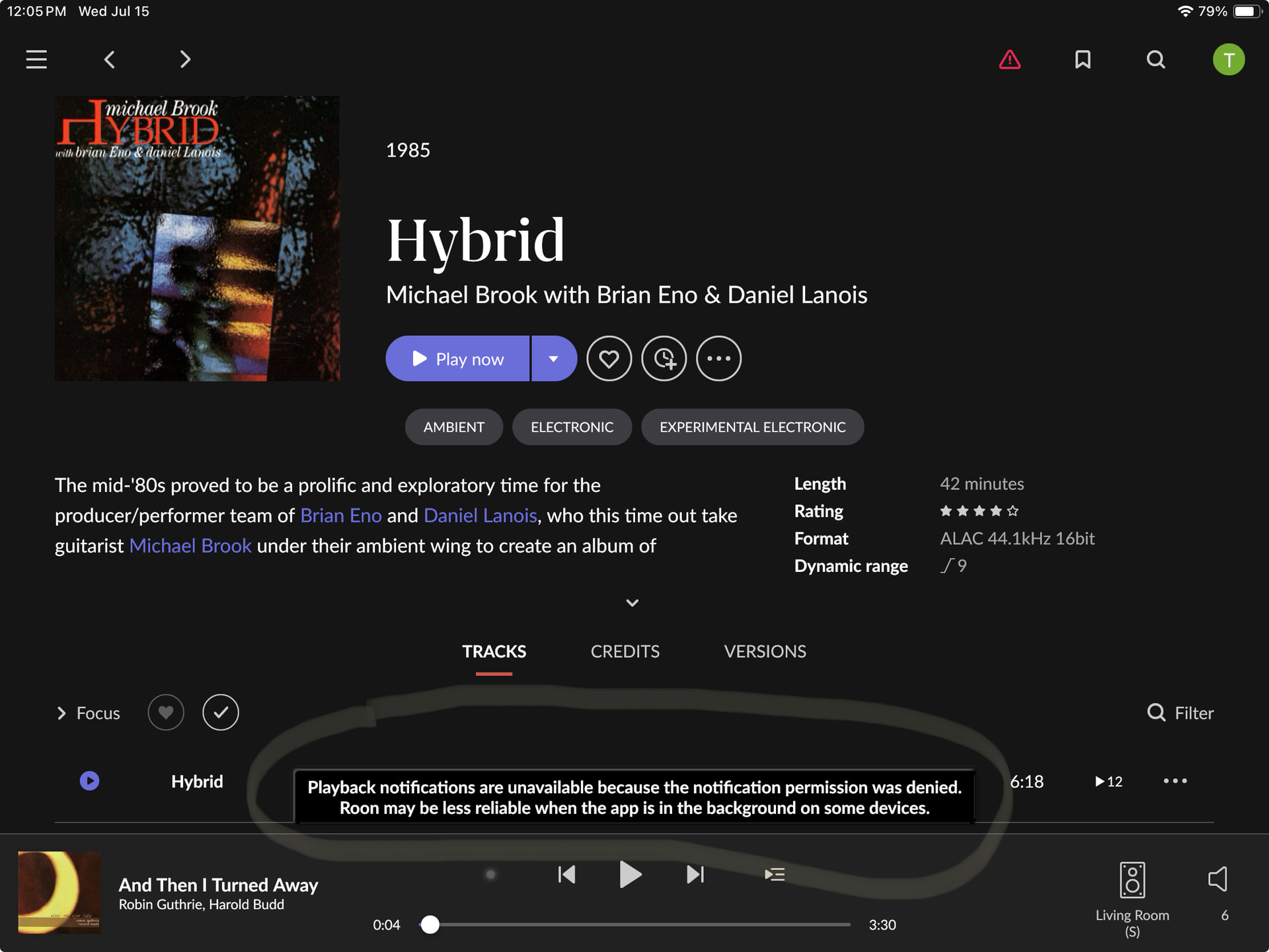

As per your request - I received the message “Program notifications are unavailable because the notification permission was denied. Roon may be less reliable when the app is in the background on some devices”

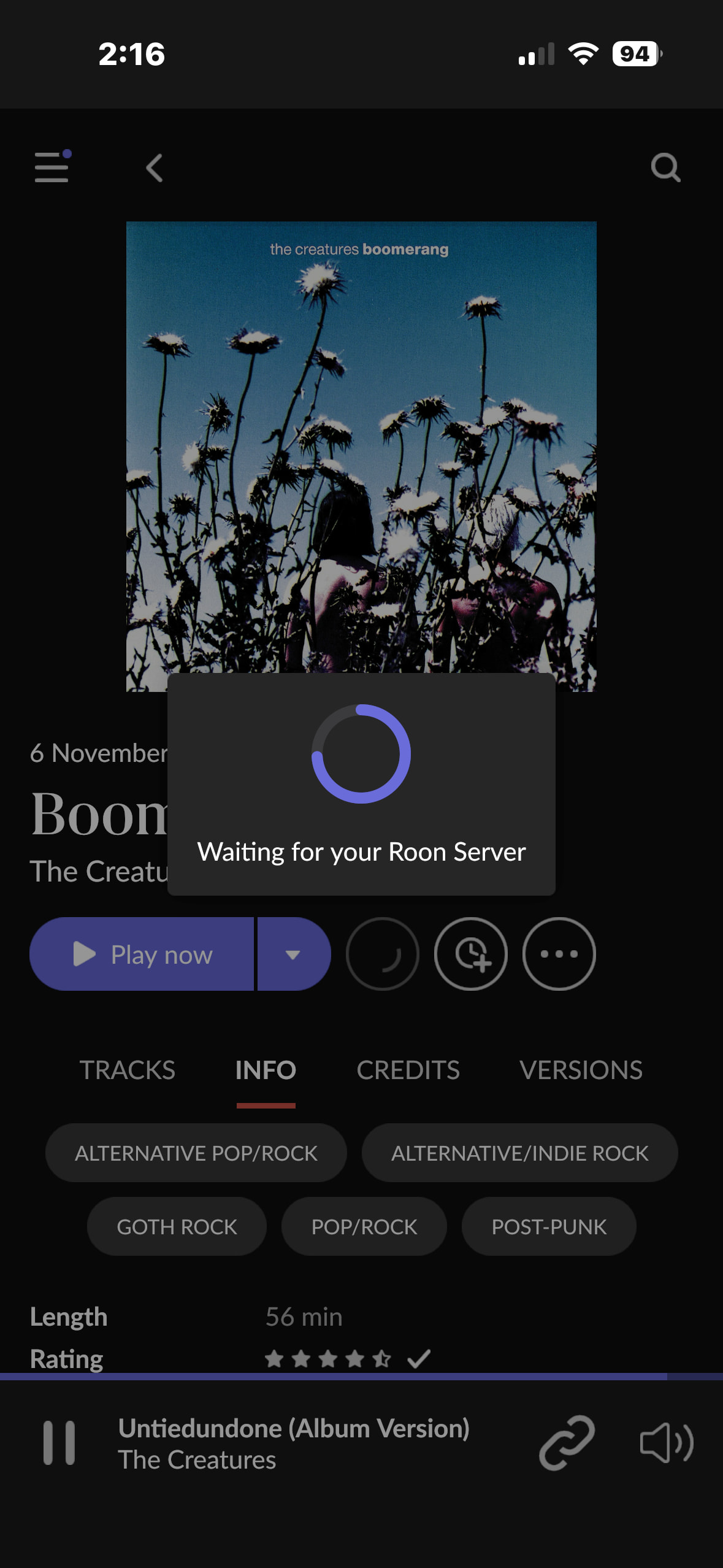

Also, things had been running smoothly for a couple of hours within the zone group Move 2 / Living Room / Media Room until about 2:15 EST when things dumped;
I could not just hit play again after closing the app and restarting it - I had to choose a new source of music - The Creatures / Boomerang
I just notice upon restating that I lost the Media Room from the original grouping I made.

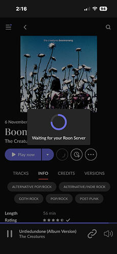

During this window, RoonServer on your Nucleus ran out of memory and was shut down and restarted by the system three times:
  • 07/22 at 2:16 PM your time
  • 07/24 at 3:30 PM
  • 07/27 at 8:08 AM

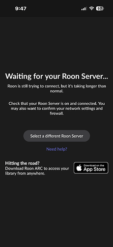

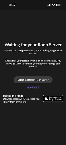

Each time, the server had grown to about 3.2 GB of RAM, essentially the full ~4 GB the Nucleus One has, and the operating system stepped in and restarted it. That restart is what you experienced as the "Waiting for your Roon Server" spinner, and it lines up precisely with the group that "dumped" on 07/22: your screenshot shows that exact moment, with "The Creatures – Untiedundone" as the track, which matches what the log was playing when the server went down. So at least some of what's felt like the app losing control has actually been the server itself restarting underneath you.

Also, have you any insight into why I am continually seeing the message “Playback notifications are unavailable because the notification permission was denied. Roon may be less reliable when the app is in the background on some devices”?

I have done the update, but still have seen the message “Playback notifications are unavailable because the notification permission was denied. Roon may be less reliable when the app is in the background on some devices” Can you please inform me as to why this message has started to appear regularly.
