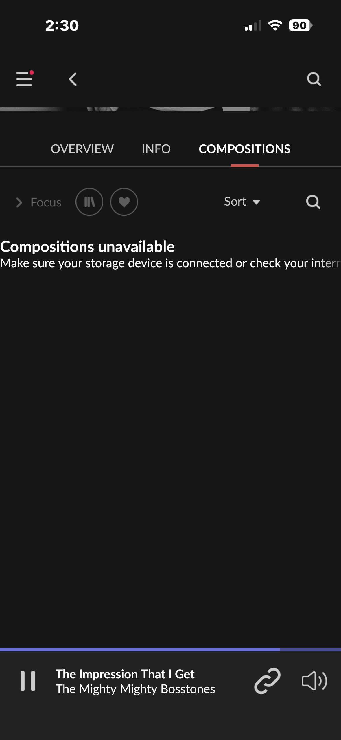

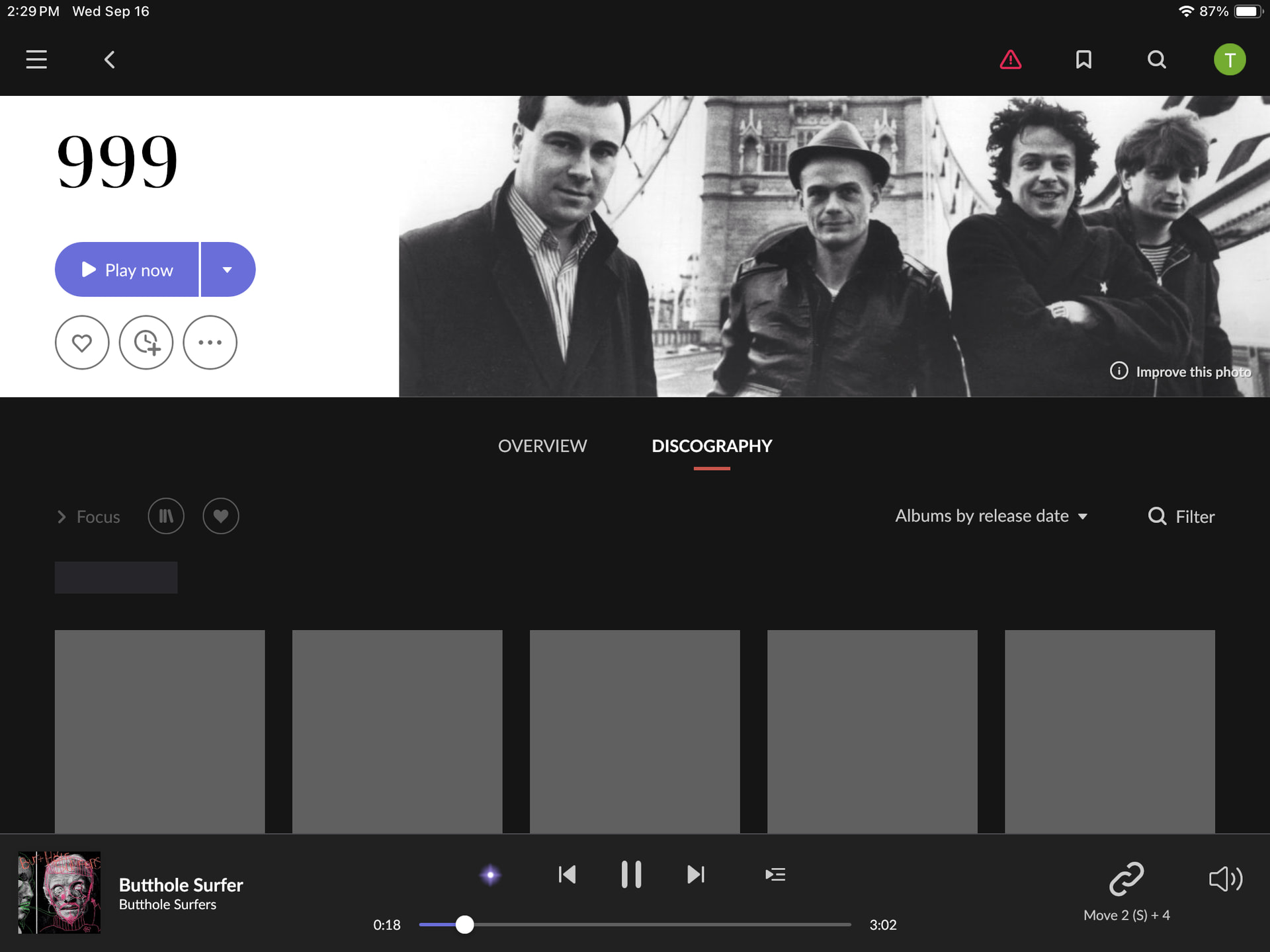

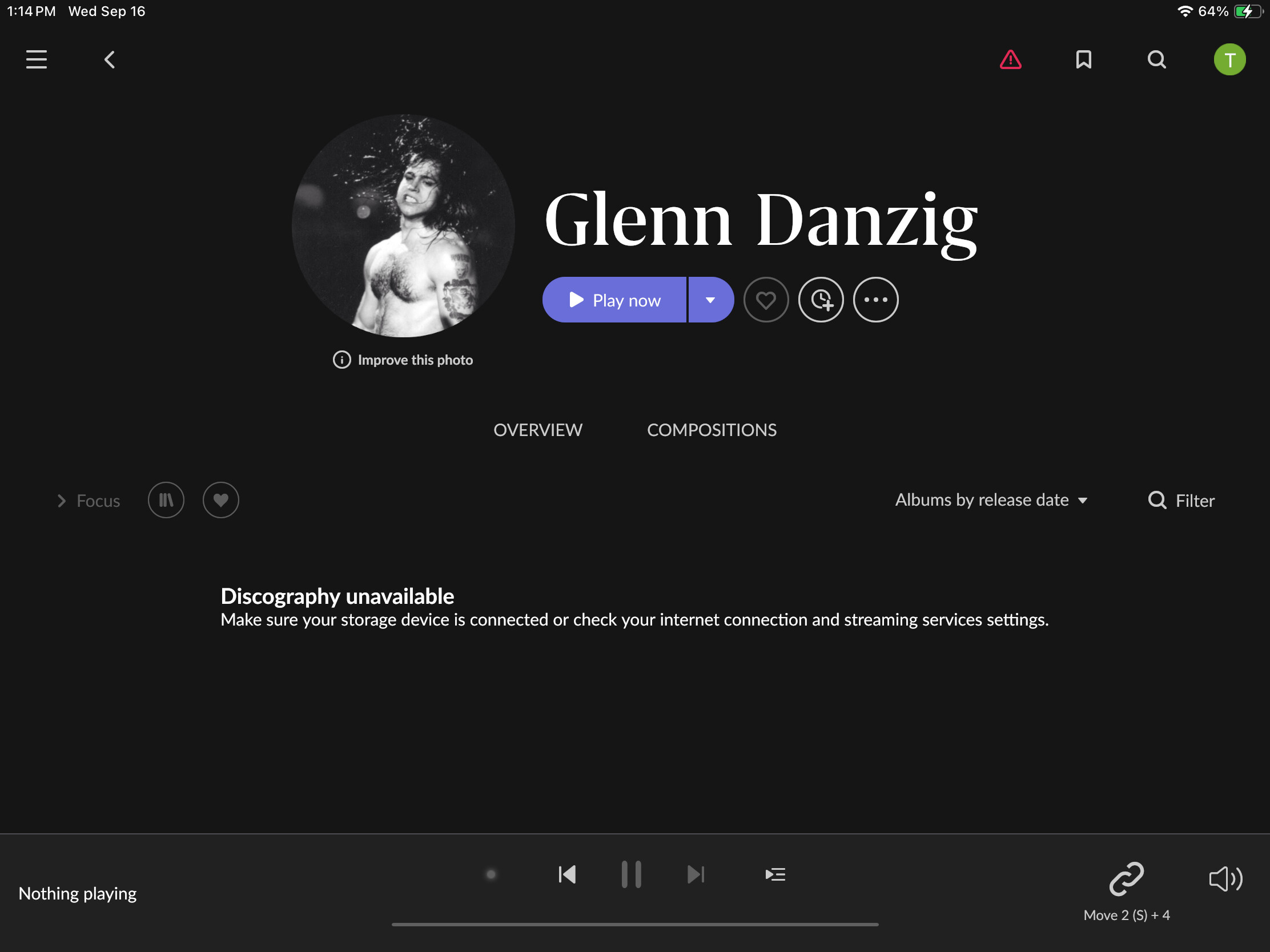

I spoke too soon, as my Nucleus just started acting up - it is not rendering metadata and I cannot get at any of my saved artists discographies:

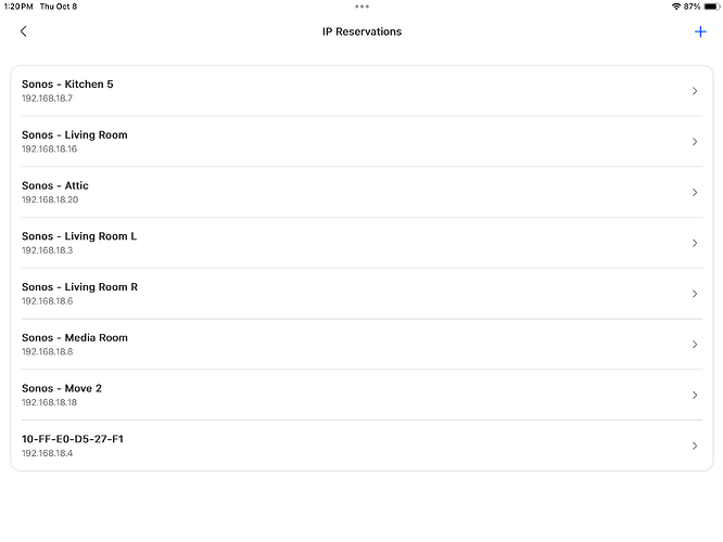

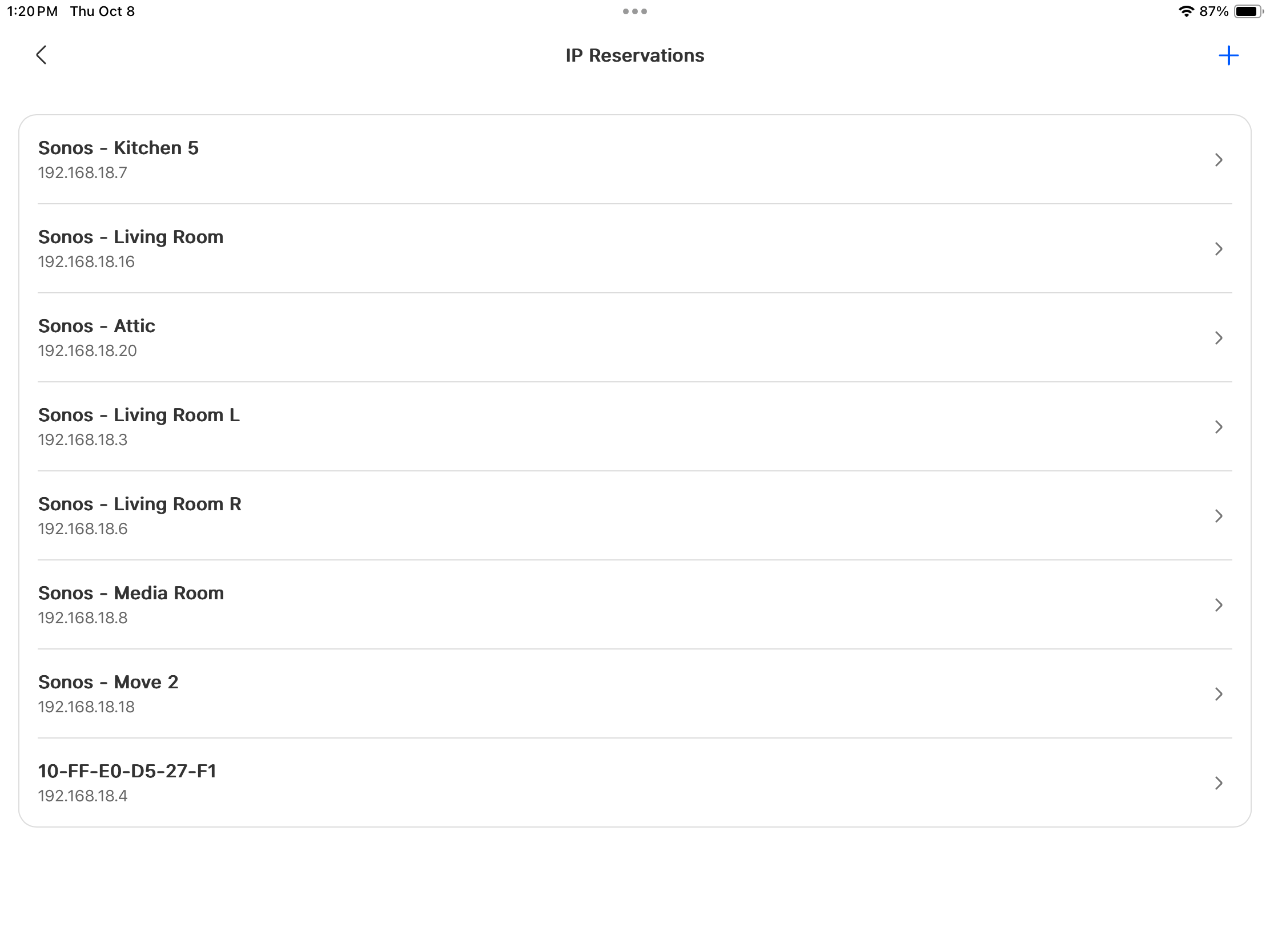

I did a modem swap, but there were no changes to any router settings, and all IP reservations for the Sonos speakers remained in effect. I will be doing another modem swap in the next few days, as my provider shipped me the identical modem that has known overheating issues.
