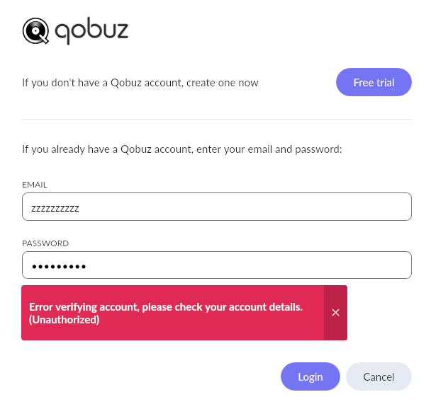

When I tried to add qobuz as a streaming service, I am getting an error "Error Verifying Account. Please check your account details (unauthorized). I have always been able to log into qobuz into the past, but have had this problem for about a week. I tried changing my password, but no luck. I am able to log onto the qobuz website and make purchases. I am also able to use qobuz with jplay.

Thanks for letting us know. I noticed in your screenshot, you only have the username, but no email. Just to confirm, you tried with both username and email and they had the same issue? Does login via
using the same credentials work as expected? You can also try to clear your Roon cache by using these instructions:
