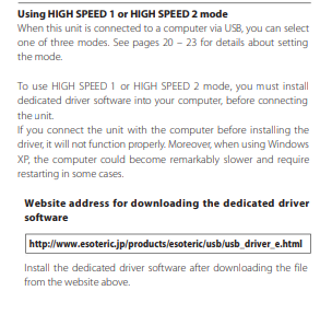

Hi @rawiabouleila,
Welcome to the Roon community. Thanks for reaching out to us to ask about this issue. In the user manual for your Esoteric it says that high speed 1 and 2 need specialized drivers installed on the computer before connecting the esoteric.
Did you install those drivers before you connected the Esoteric?
Hi,
Yes drivers for windows and Apple were installed on each machine respectively according to manual while the Esoteric was not connected. Then operating system was left to start adequately.
Both operating systems produced the same results with playback from Qobuz and Tidal directly under Exclusive Mode (without Roon). Playback was ok under normal setting. HS1 and HS2 played resolutions up 92 and skipped at higher resolutions.
Then upon installing Roon, HS1 worked great up to 176.4 and I did not test higher rates. HS2 (asynchronus) with Roon returned an ertor stating that “Roon lost control of the device” and hence my message to support.
