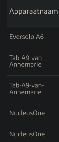

Hi I’ve given the eversolo the exact same ip address as the nucleus now the eversolo a6 first row the one with the ip address in has fallen away when I’m in the browser of the modem. Is that bad?
Hello @Selco_Driessen_Waute,
Yes, that is definitely causing the new issue you are seeing! Do not worry, as this is a very common mix-up when dealing with network settings.
By giving both devices the exact same IP address, you have created what is called an IP Address Conflict.
Think of a subnet like a street, and an IP address like a house number.
  • Being on the same subnet means both devices need to start with the same first three numbers (for example, 192.168.178.x).
  • However, the last number (the x) must be completely unique for every single device on that street.
When two devices have the exact same “house number,” your router gets confused and does not know where to deliver the data. As a result, both the Nucleus and the Eversolo will lose their network connection and stop working properly.
  1. Change the Eversolo’s IP Address: Go back into your Eversolo network settings and change its configuration from “Static/Manual” back to DHCP (Automatic). If you prefer to use a static IP, you must choose a final number that is not being used by the Nucleus or any other device in your house.
  2. Reboot the Devices: Once you have changed the setting on the Eversolo, completely restart both your Nucleus and the Eversolo. This forces your router to recognize them freshly and assign them proper, unique IP addresses on the same subnet.
