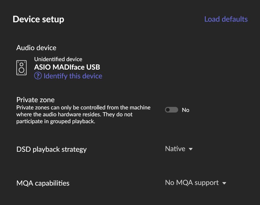

If you mean that you don’t see the DSD line like exists in my screen pic, then yes, Roon is basically telling you that the Play has reported to it, that it cannot do DSD.
