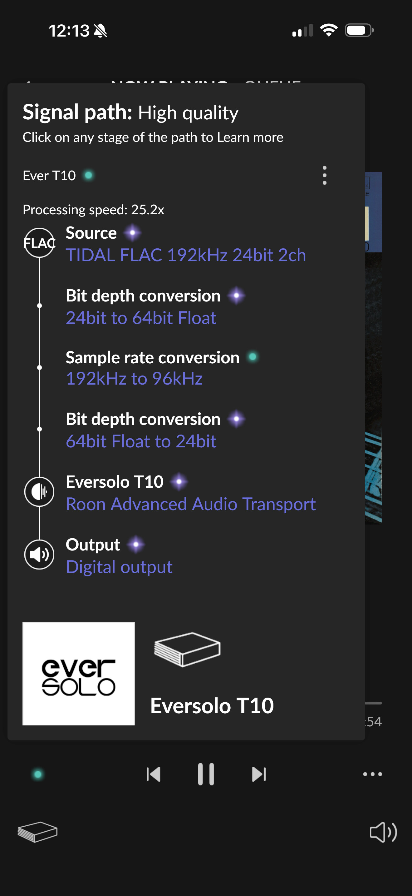

Great to see Roon Ready. Please can you not limit hires that Roon sends to the T10. The T10 will downsample where needed. Roon currently does the conversion. I have the T10 set to 96/24 and everything over that is down sampled via Roon. See attached.
The usb Output should support PCM 384khz and DSD512 through roon RAAT.
This is using spdif. I would like Roon to send the highest in altered resolution available to the t10 and let the T10 down sample where needed depending on the output used
