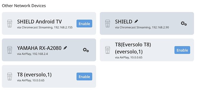

Firmware went thru with no errors on the device, however when I launched Roon, my Roon Ready device was missing from Roon. What is strange there are 2 Eversolo T8 Airplay devices.
The Roon Ready T8 was missing from every endpoint device on my network. I tried everything to get it back. I’m prepared to try and downgrade the firmware to get my system back but I want to contact my distributor and see if they can connect me with Eversolo first.

Replaced Nic cards. Network is ok. I have 2 Different Eversolo T8 Airplay devices on same unit. Eversolo told my distributor that only a Roon active subscription will work and not a Trial. My reply was that I was Lifetime.

In the “audio” section of “Settings” the T8 shows up three times:
As a “Roon Ready” device (enabled, in other words, the one I’m using)
As a “Squeezebox” device (not enabled)
As an “airplay” (not “airplay2”) device (not enabled)
