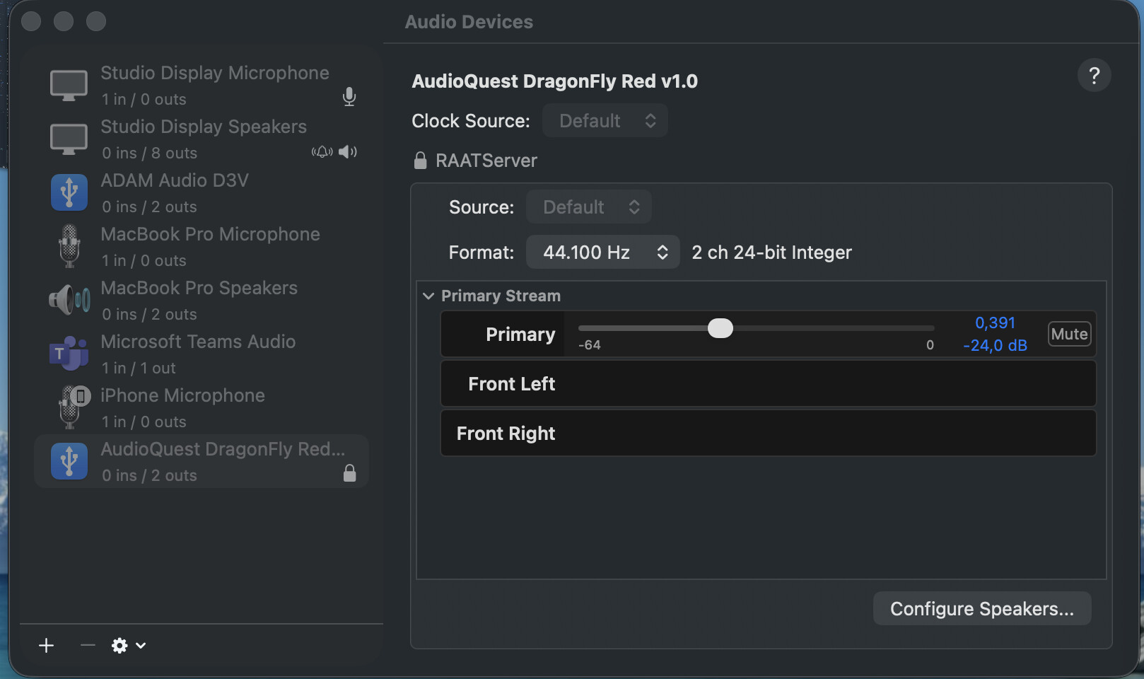

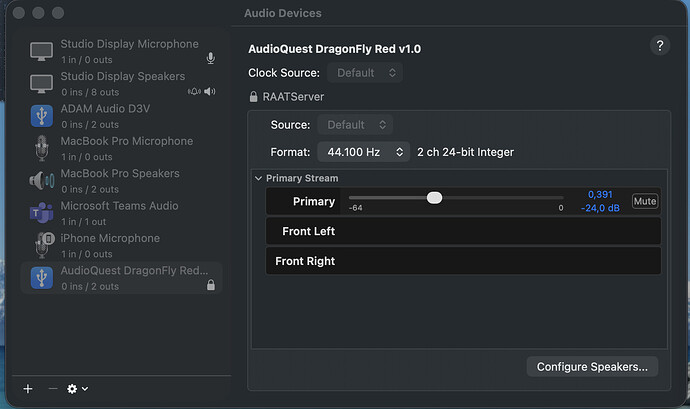

I have also just tried with an Audioquest Dragonfly Red
Exclusive mode works there. It also seems that it has a Primary volume and then a left and right volume like you see in the screenshot
