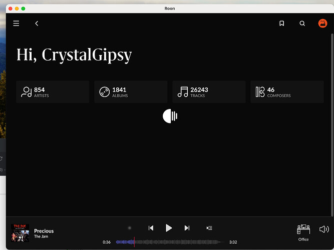

Hi Connor, it happens on windows as well. It basically takes out the server for a while then it seems to recover. Get same error on either and it happens to local disc or an attached disc.
If I select a few files I can get it to export but selecting a large amount it hangs. I feel there is a file/s it’s not liking but exports CSV no issues. I have no errors in importing so odd. Will try it again when I am home shortly to give you a timestamp. The remote is not used all the time.
Okay 19.58 gmt exported library it fails.
Disabled then re-enabled storage same issue.
If I select one of my watched folders which has the smallest amount of files it’s working this one’s lossy. I If I do my flac watched folder it fails.
Just split my exports form my flac watch folder into two parts and it works so there is some file or album limitation at play here I feel.
@connor did you get the log? Be good to find out why Roon can’t handle exporting all my library in one go but is fine if I break it up into two seems their is a limit as it would bail out up to about 1300 albums I think.
