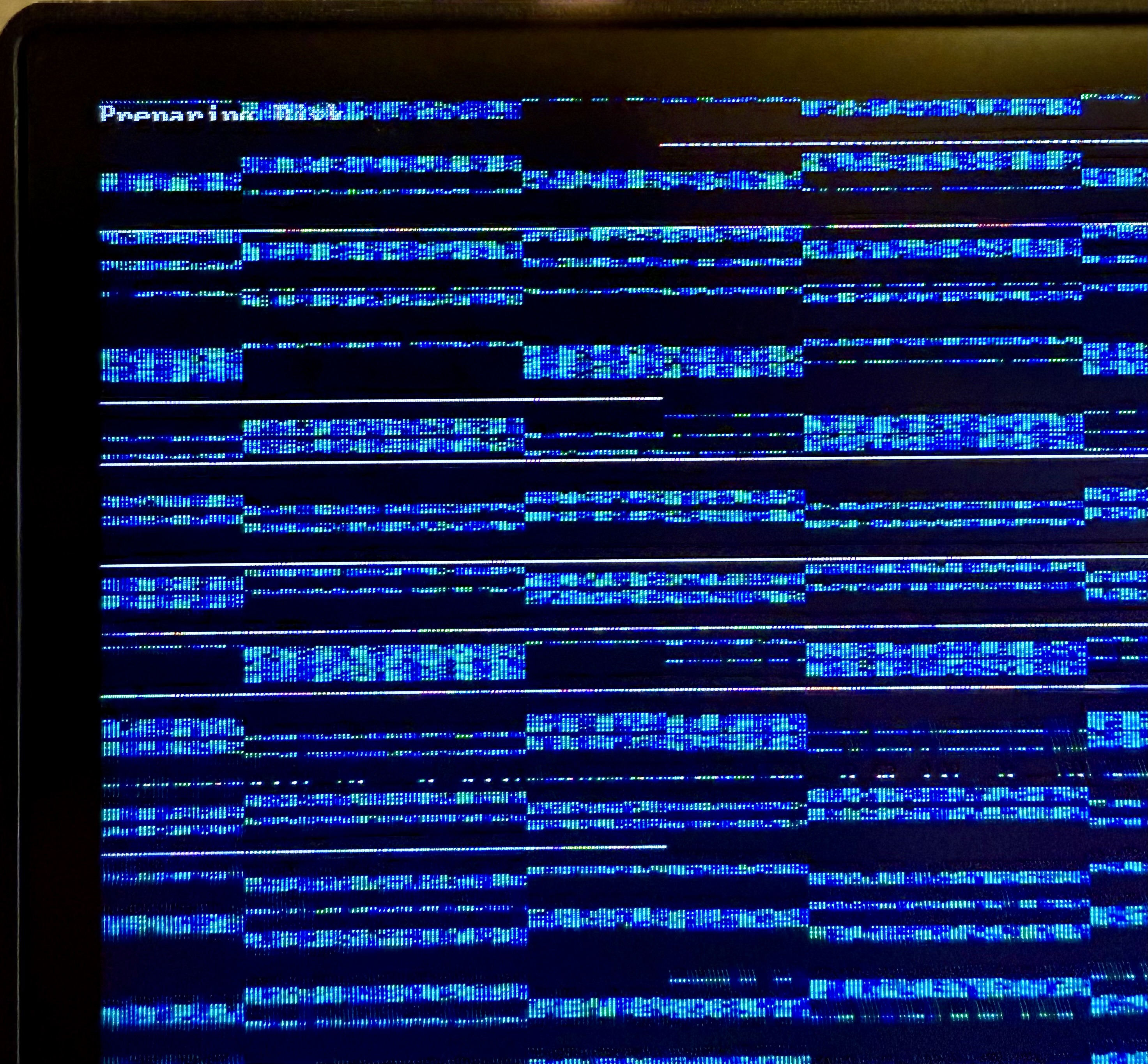

I’ve tried installing Rock several times on a NUC8i7BEH (which says it’s supported on Roon’s list of Rock-compatible hardware) with no success. Sometimes I can get further than other times, but I’ve never been able to get past the “Preparing” screen before everything goes haywire with the display and the installation seems to freeze up. I’ve tried multiple HDMI cables including a brand new one, multiple monitors, and have triple checked that all BIOS settings are correct including disabling secure boot. I read on another thread where someone mentioned a possible conflict between the Rock software and the graphics controller. Is that a possibility? The HDMI output on the NUC has worked flawlessly up until I tried to install Rock. Any thoughts or suggestions?

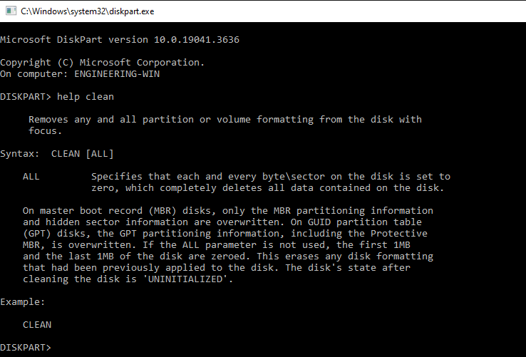

TLDR, “Clean” is a command in “diskpart”, You need to know what you are doing, so, unless you know your way around it, maybe you should not use it…
In case you wanted to know (geek here so don’t read if not interested :nerd_face: ):
You use “Clean” from the command line and is as described below:
I use this to remove all partitions from the thumb drives or micro SD cards that have had images flashed to them before flashing new images. Flashing images can create multiple partitions and sometimes make the drives/cards unreadable/unuseable by Windows or MAC unless you “clean” or delete all partitions from them and create a new partition and reformat. This is not always required but sometimes it helps troublesome flashes to have a “cleaned” media to start with.
If you need more instructions you can google “how to use diskpart clean command” and read up on it.

I just formatted my USB drive again (FAT32) and re-downloaded ROCK from the above listed page. The first time I tried flashing it to the drive with Etcher, I got a message during the verification step that the software was corrupted, so I attempted the flash again and the second time it verified correctly. I then went through the BIOS config steps one by one and confirmed everything was set as stated on the instructions page. When I attempted to boot from the USB drive I saw “Welcome to GRUB!” in the top left corner of the screen for a couple seconds and then my screen went to the same jumbled display as pictured in my first post. I tried 3 more times to shut down and reboot the NUC to the USB drive and got the same result each time. I even tried using both USB ports on the front of the NUC in case there was an issue with one of them. In some past attempts I’ve been able to get past the first couple screens where it asks you to select which drive to install to, but then the display goes crazy when I get to the “Preparing Disk” screen. I can’t even get that far now.
