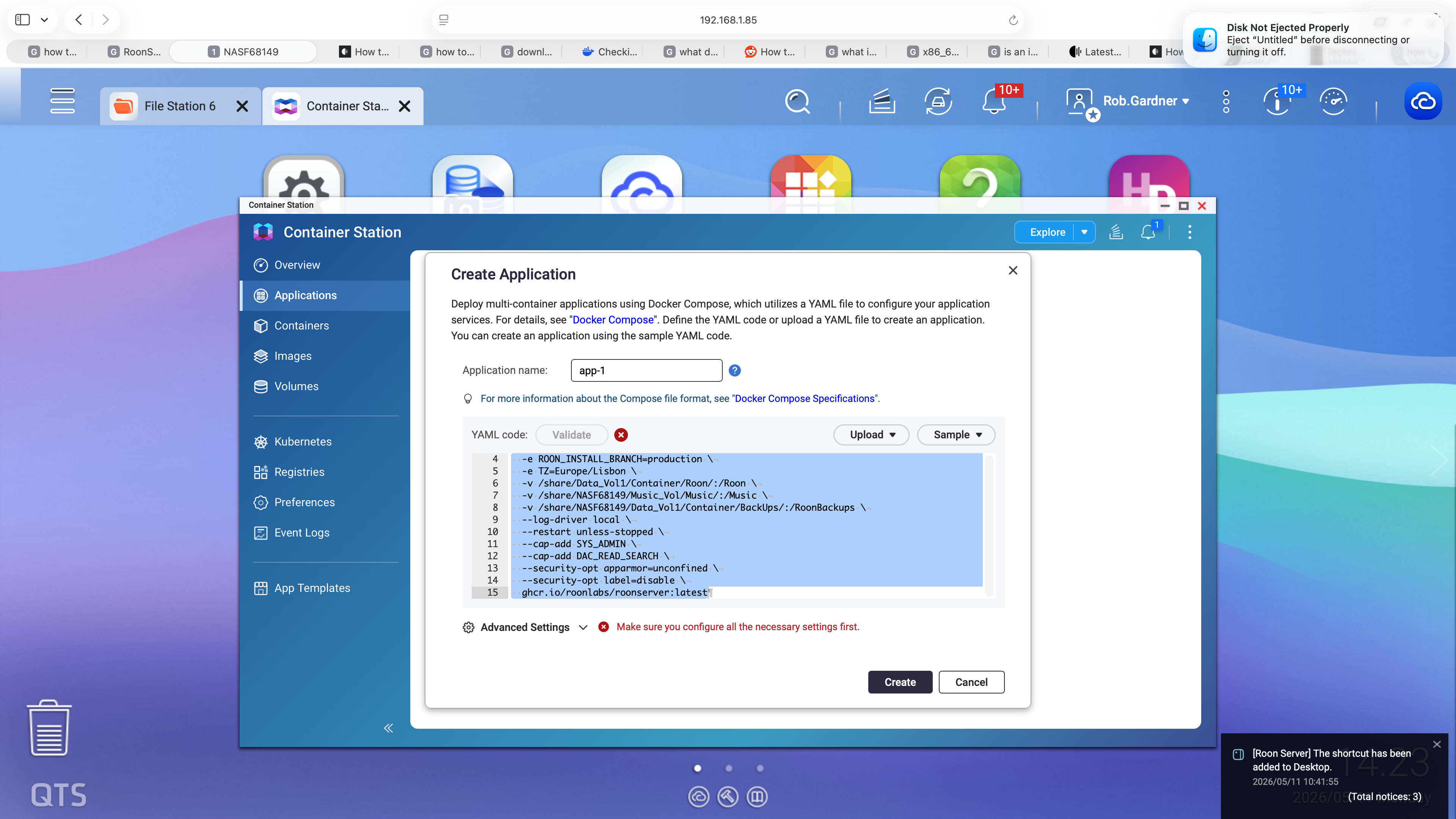

Hello @Rob_Gardner,
Thank you for the detailed screenshots! They make it very easy to see exactly where the configuration is hitting a snag.
Looking at your Container Station screenshot, the issue is that you have pasted a docker run command into the YAML editor. While that command contains all the right information, the “Create Application” feature in QNAP requires a specific format called YAML (a docker-compose file) rather than a single-line terminal command.

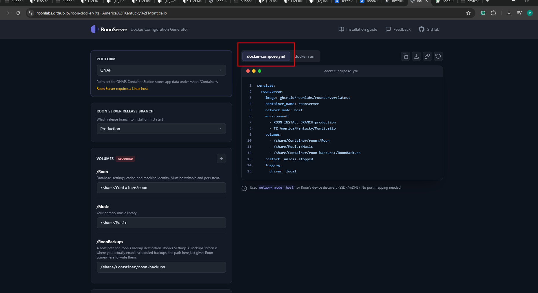

How to fix this:
  1. Go back to the RoonServer Docker Configuration Generator page.
  2. In the top-right toggle of the code window, make sure docker-compose.yml is selected
  3. Copy the entire block of code that starts with services:.
  4. Return to Container Station, clear out the current text in the YAML code box, and paste the code starting with services: there.
Once you paste the proper YAML format, the “Validate” button should check out successfully, and the “Create” button will become active. This will spin up the official Roon container and get your NAS back into action!
Please let us know if you run into any validation errors after pasting the services: block.
In addition to what @vadim was pointing out correctly, from practical experience, creating/storing a .yml file in docker generator and uploading that one in Container Station via ´Create application > Upload´ has proven to be the most reliable path.
One remark: Your share paths as inserted in docker script, contain device names (“NASF68149”) plus volume alias names / logical names, like “Data_Vol1” or “Music_Vol1”. Both might lead to the share path ending up as non-functional (resulting in error messages like ´No space left on device´ or empty folder as seen from container). If your top-level folders like /Container are correctly shared/mounted and not redundant, you can leave out the volume name from the path, like:
/share/Container/Roon:/Roon
/share/Music:/Music
in your case.
If that is not working, you have to figure out the individual volume names as used on system level, as the top location following /share, that could be for example CACHEDEV1_DATA instead of Data_Vol1.
