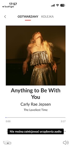

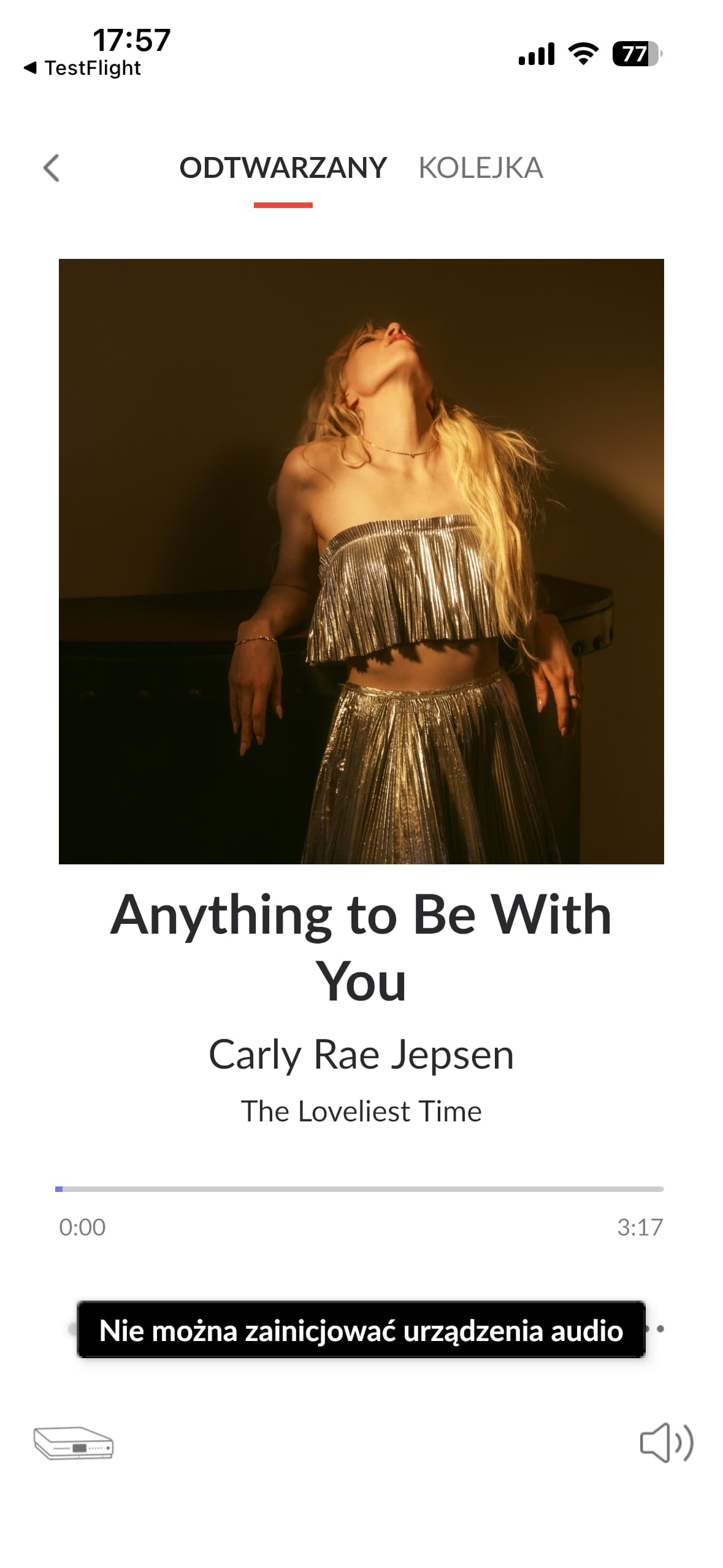

"Failed to Initialize" when Switching Sample Rates on MacOS Tahoe [Ticket in]

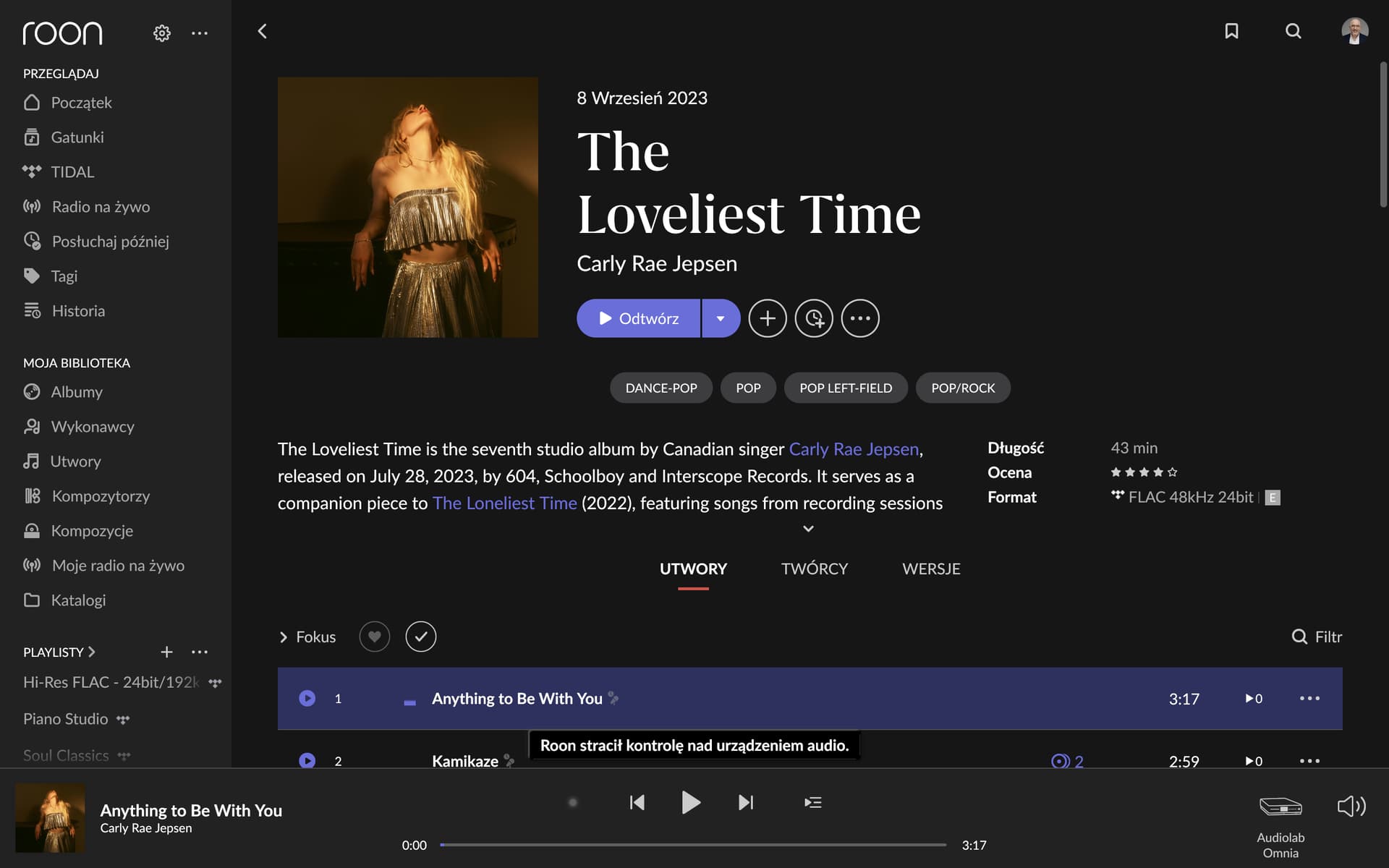

So..speaking strictly for myself, the latest EA beta does not solve the issue. It merely BSes over it. Yes, I said the new beta BSes over the problem. How, might you ask, did Roon decide to ■■ over this issue? Allow me tell you!

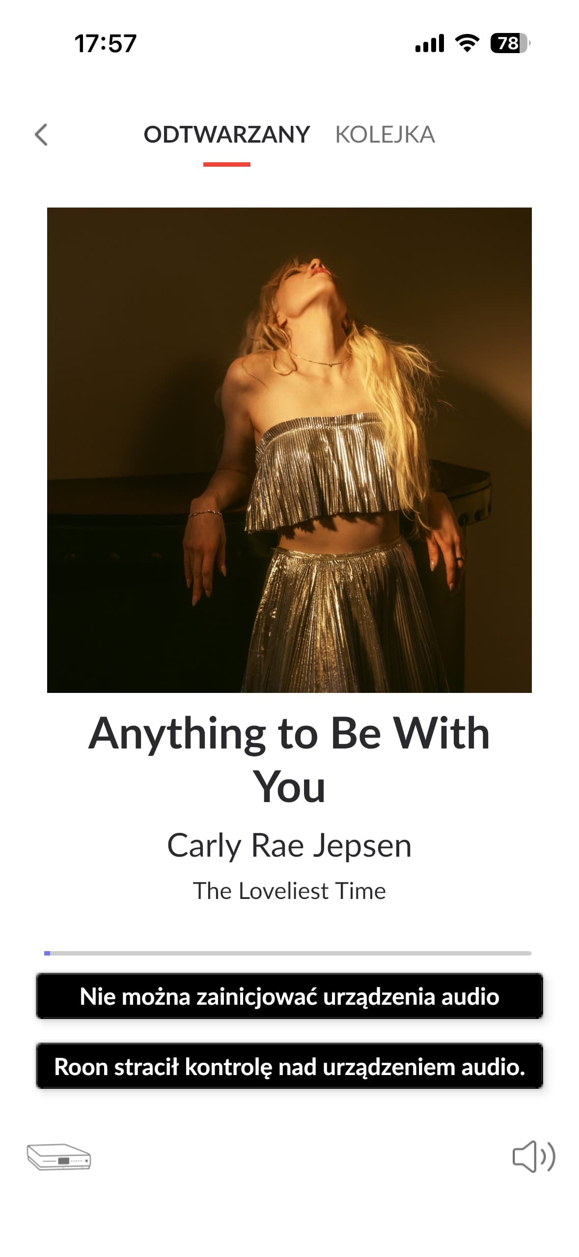

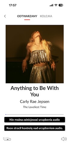

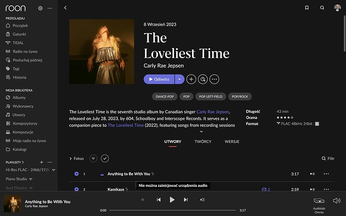

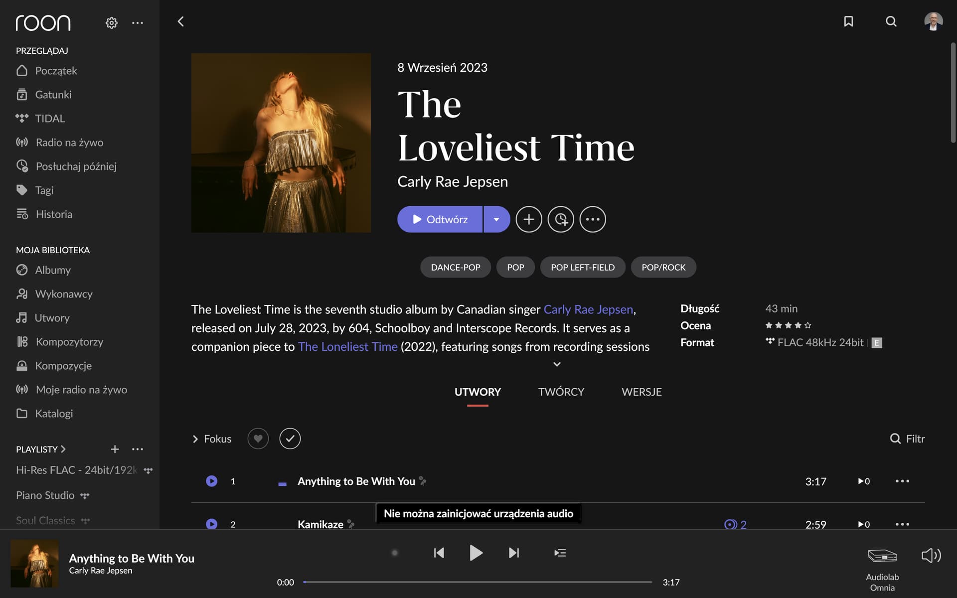

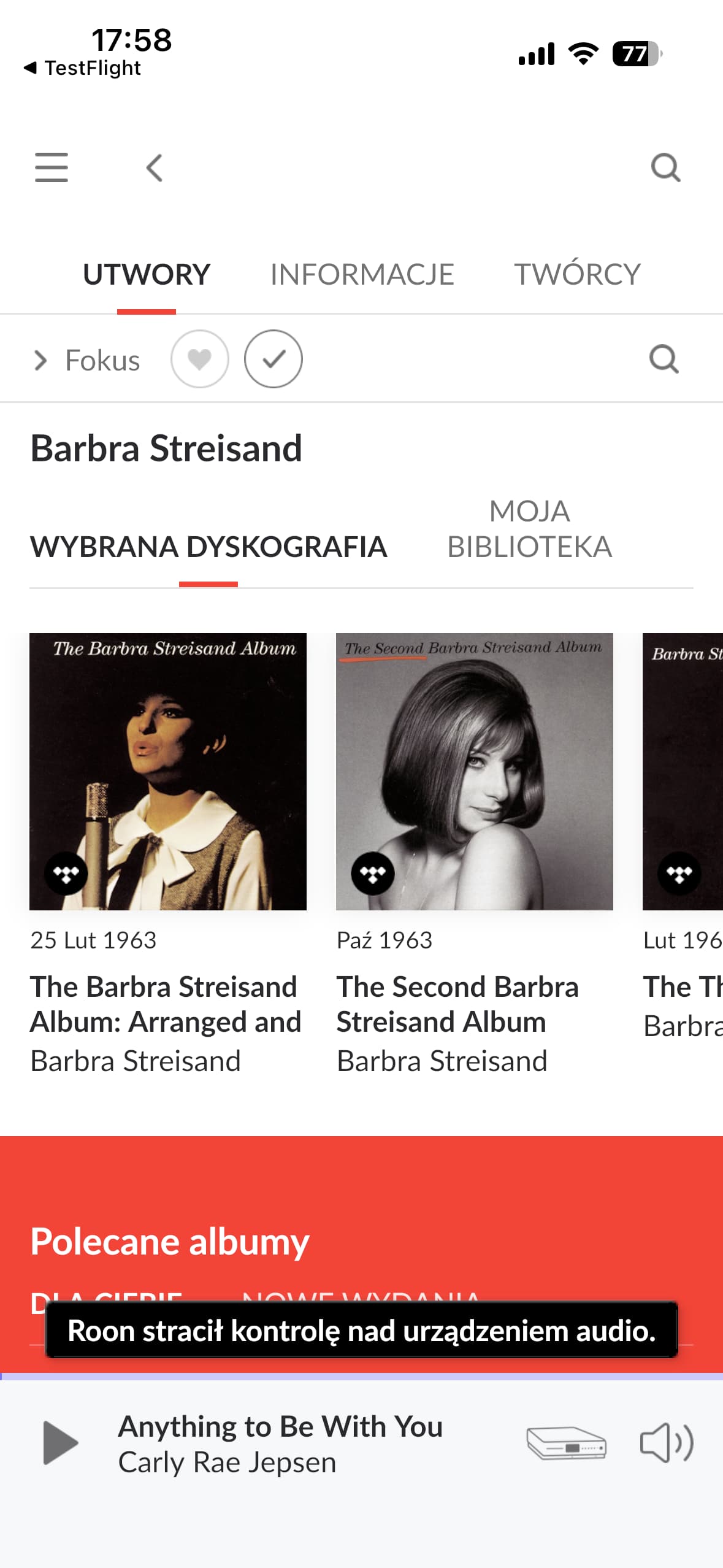

Roon briefly loses control of the audio device when changing sample rates and informs me of this, THEN, it briefly drops the audio device completely for a few moments, only for Roon to re-initialize the audio device, at which point I am then finally able to click play and have the audio start.

Today, after updating to Early Access version 2.56 (build 1568), the problem persists. Nothing has changed! :enraged_face:

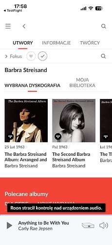

Quick update…whereas the prior build was losing control of the audio device, re-initializing, and then playing back fine, build 1568 is now losing control of the device and not giving it back.

I’m having the same problem, it completely loses control of the device. So disappointing.
