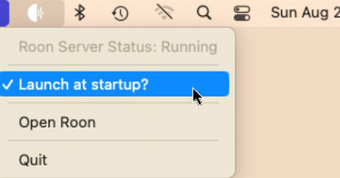

The server is a separate program from the graphical control app. The graphical app normally should start the background server program, but who knows.
Can you see the Roon icon on your Mac’s menu bar at the top, on the right in the notification area? If you click it, it should open a menu like this:
