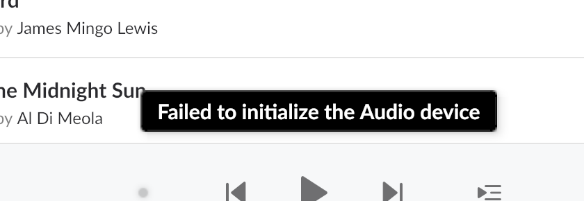

Please also share a screenshot of the particular error message you see in Roon.

What happens is playback stalls whenever I play music with different sample rates, say moving from 16/44 to 24/96, playback will fail after the switch and I get a “Failure to Initialize” message in Roon. I tried increasing the resync delay from 0 to 5000 ms to see if that would help, but it didn’t. This failure happens whether I’m playing FLACs from my local library or through Qobuz streaming via Roon.
If I go to the Mac mini which is running RoonBridge and stop and restart it, I’m able to play music again without issue until I encounter another sample rate switch, back to 16/44 for example. Then playback fails once more. Restarting RoonBridge on the affected Endpoint has been my workaround for a few weeks now whenever this happens. I do not experience playback failure with sample rate switches when using System Output directly on my Roon server. I’ve disabled DSP profiles and still see the same issue occur. Hope this helps.

Thanks for the details and the screenshot. Since the issue is intermittent, please let us know the exact local date, time, and track the next time it occurs. We’ll enable diagnostics so we can look for any clues in the logging.
