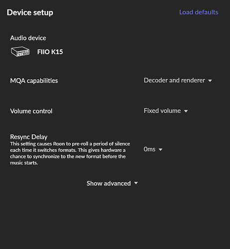

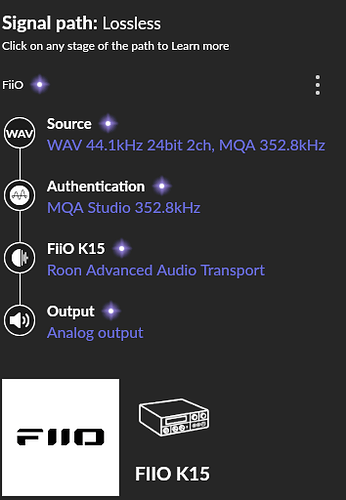

Hi, Just wondering if anyone else is running a K15 and having trouble getting it to identify MQA files. ROON shows the output as normally playing a MQA file, the DAC is configured as decoder and renderer, however, Its showing the file as a PCM file only. Any ideas? TIA!

Please share an image of the Signal Path, and Device Settings.
The signal path shows clearly that Roon is delivering MQA to the DAC. Consequently, Roon is not decoding.
Maybe you should set the DAC to Renderer only, and let Roon to the decode.
I did try that as well. Same result

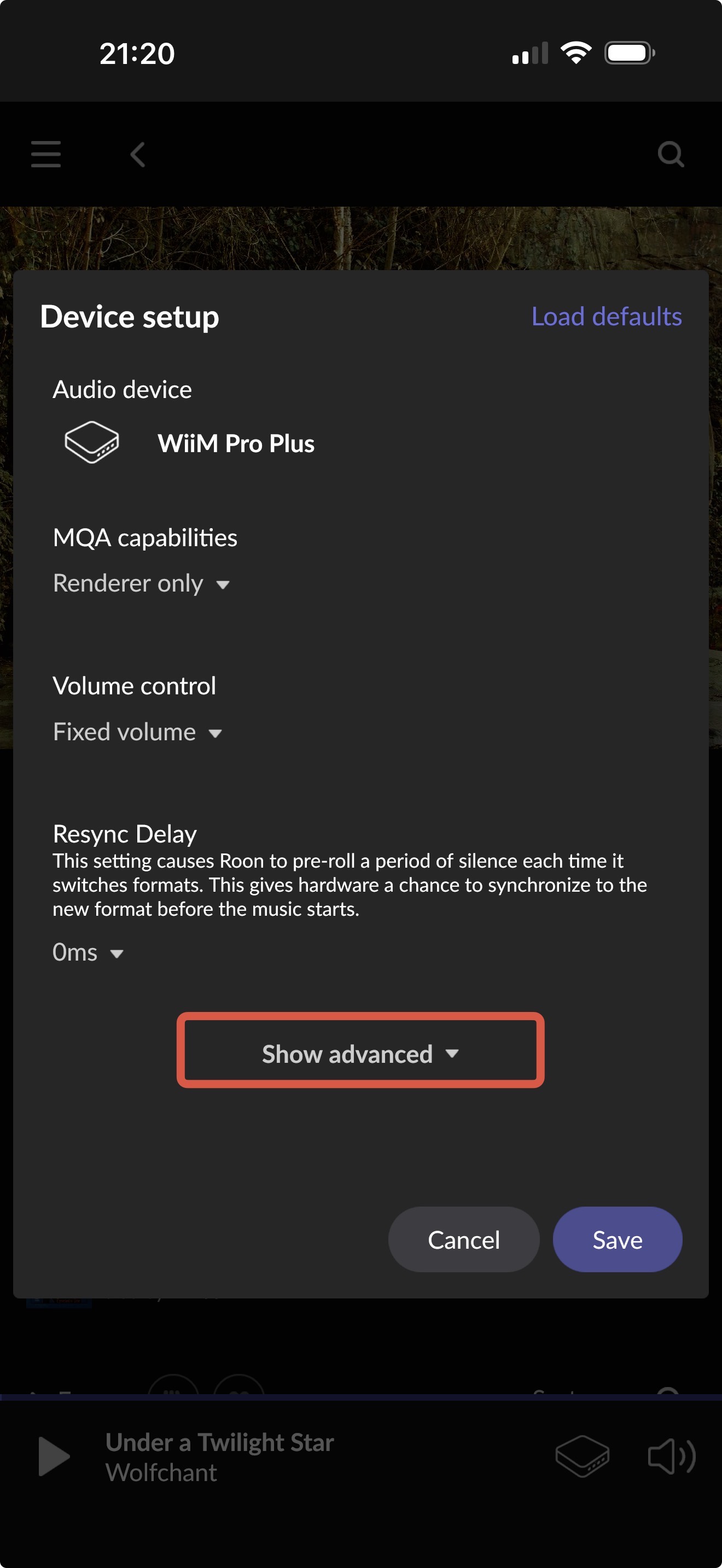

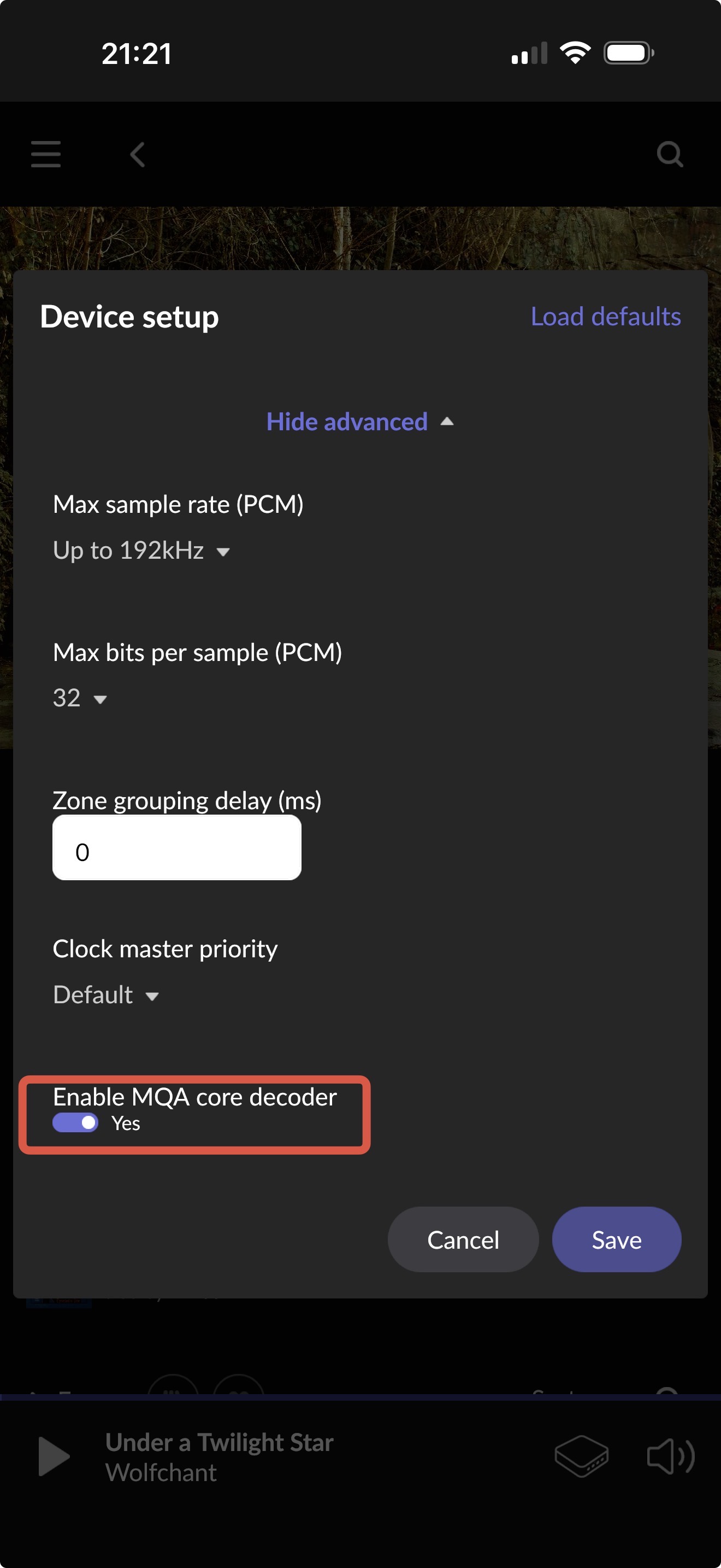

Click on show advanced on the audio settings screen for the K15 and enable Roon to decode MQA.
