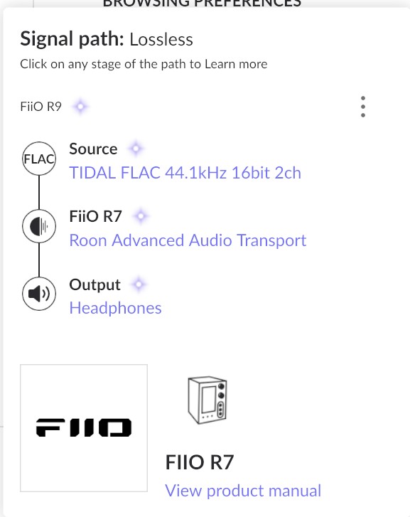

FiiO R9 misidentified as FiiO R7 in audio devices (ref#9Y0PJ0)
· My FiiO R9 is showing as an FiiO R7 in audio devices
· I am using a TP-link Archer BE550 standard settings no VPN, on devices on the same wifi network

Hello Alex,
Thanks for the quick reply. I have uploaded the log files as requested. I have the latest R9 FW 1.04. Windows device manager show this correctly as an FiiO R9 as well as mac OS.

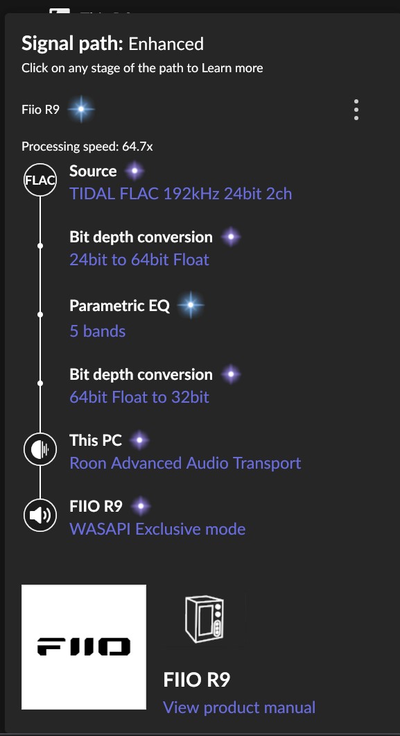

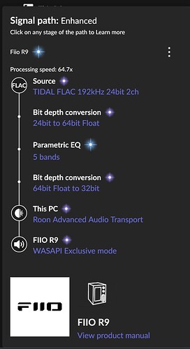

Hi Roon Team,
I hope this helps with troubleshooting. When I am in USB DAC mode and not using Roon Ready on the FiiO R9, it does show up as an R9, even letting me use WASAPI exclusive mode. So it looks like the issue is only when I use Roon Ready Mode. See DAC mode SS below.
@Inderjit_Gill ,
Thanks for confirming that.
We already found that it just initialized itself in Roon Ready mode with following name: “VendorModel: FiiO R7” .
Our team has reached to manufacturer and possibly they will change it on their side.
Unfortunately, it is not something that we can do ourselves since it is up to the device to initialize itself and not Roon.
Thanks for your cooperation on this!
