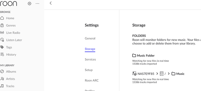

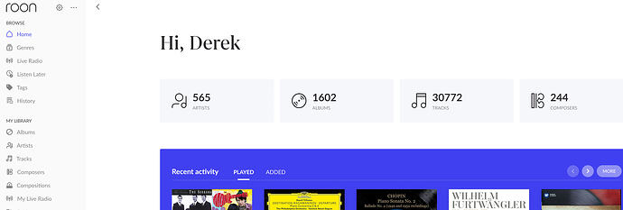

In “Storage” there are 2 Storage Folders shown.
As far as I can tell they are both exactly the same location and exactly the same files.

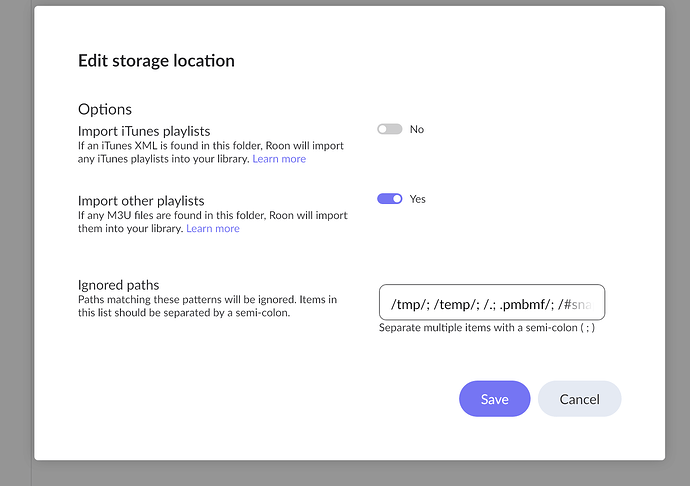

The first location “Music Folder” cannot be removed and the storage location cannot be edited.

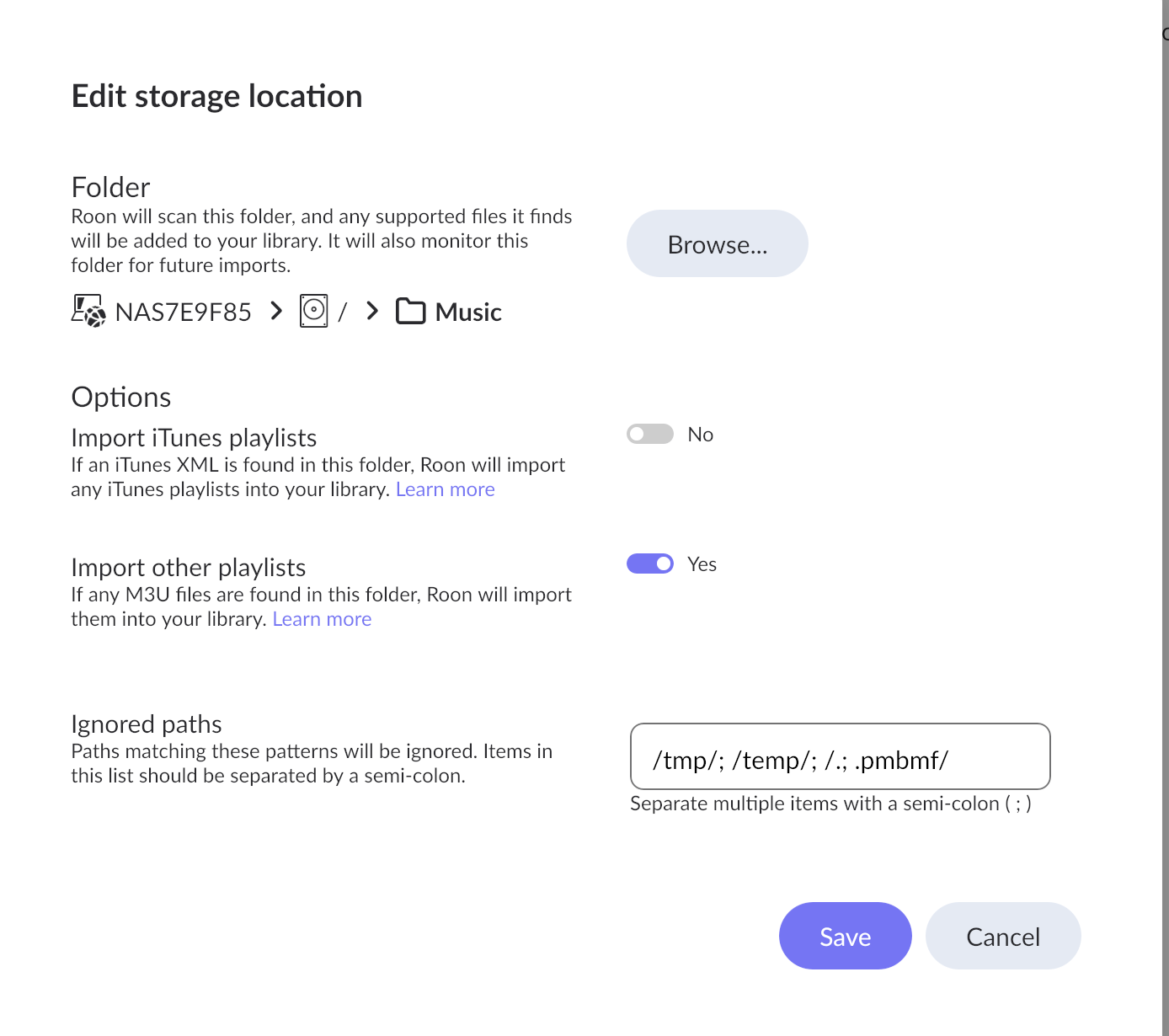

The second location “NAS7E9F85> >/ Music” can be removed and the storage location can be edited.

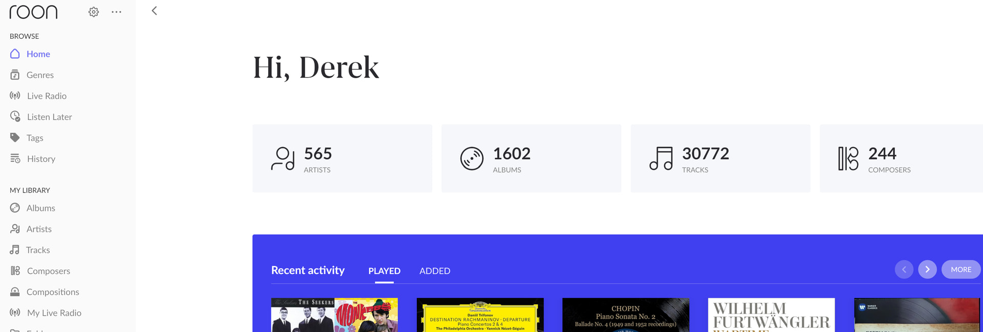

With both folders enabled ROON tells me I have twice as many tracks (30,772) as shown in the folders (15,386).
If I disable the first location everything looks normal (ie . number of tracks = 15,386 and tracks in playlists all there). Under “Library - Maintenance” it shows 17,234 tracks to be cleaned up.
If I disable the second location everything looks normal except all the tracks in my playlists are marked as “unavailable”. Again under “Library Maintenance” it shows 17,234 tracks to be cleaned up.
How do I remove the duplicated Storage Folder and keep the tracks in my playlists available???
Why the difference between 15,386 tracks shown in the folders and 17,234 tracks shown to be cleaned up???

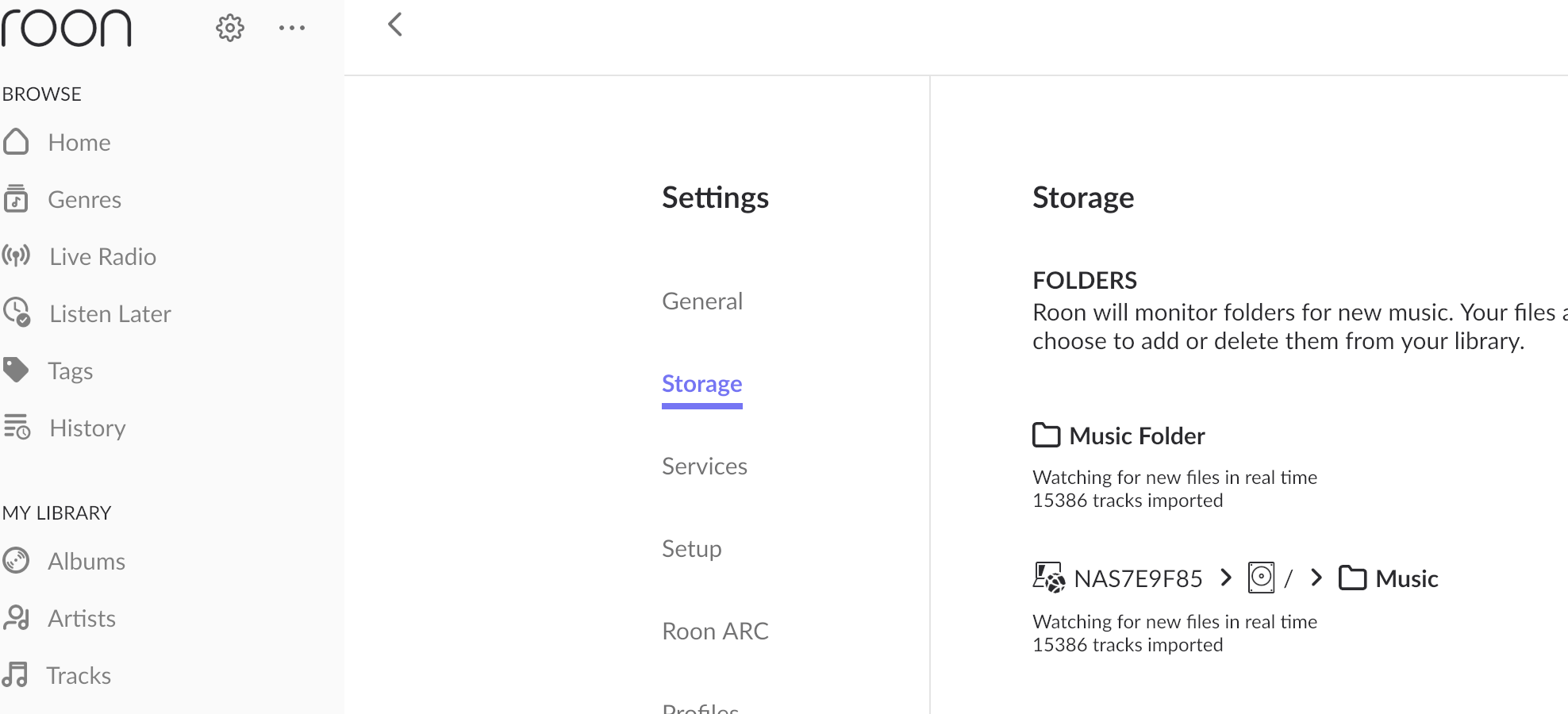

The first location is the share path you have specified when running docker generator, so to speak the new primary music folder.
The second one seems to be the old, non-existent (inside the container) file path as used by RoonOnNAS installation, which only exists as a result of restoring a backup. You seem to have successfully pointed to the new share path, so it has recognized all the previous tracks, edits and links to playlists.
That is to be expected, as you had already pointed roon to the new location of the previous folders when restoring the backup, so it recognized these as your existing ones, not the “Music Folder” stuff (which in the end of the day is the same files twofold).
Fast way: disable the main “Music Folder” and keep it disabled.
If you don´t want that, keep it disabled, in the first place, restore a backup from RoonOnNAS times, subsequently delete remnants of the old folder path which roon marks as ´unavailable´, and only then enable the new Music Folder. With the previous paths being deleted prior to roon scanning, it should identify the existing tracks and that they have been moved to a new location.
Both methods works, the second bears a risk of a few tracks being not recognized.
